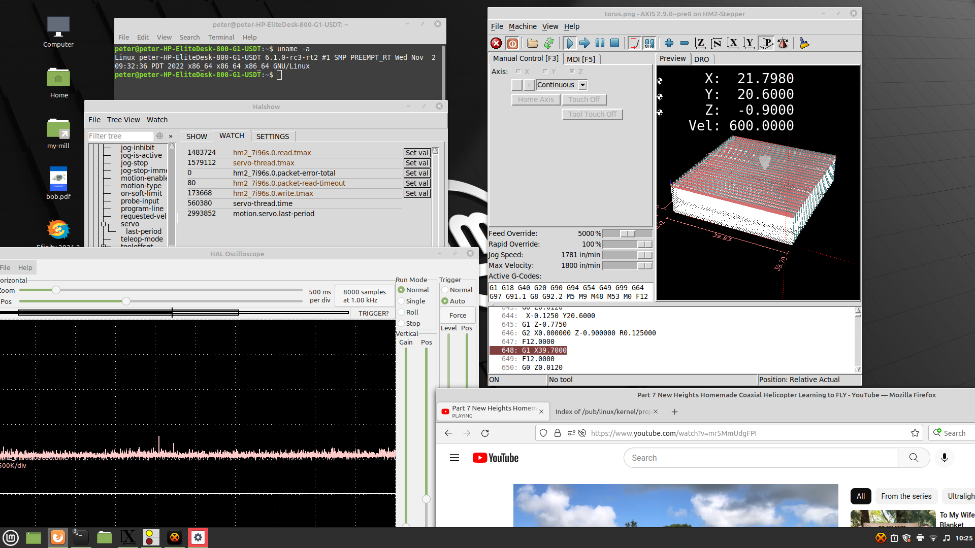

02 Nov 2022 17:36 - 03 Nov 2022 01:23 #255798
Replied by PCW on topic Mesa hm2/hm2_7i96s.0: error finishing read
Did you build the 6.x kernel?
Here's the latest RT kernel on my Elite 800 G1 (which is not great on any kernel)
This is after about 1.5 hours with youtube videos playing:
EDIT: Now ~8 hours on the Elite 800 G1 and no worse on the tmax's,
so 6.1 seems about as good as 4.19 on that hardware
I also tried 6.1 on my 8300 and its almost as good as 4.19 at 4KHz
(and much better than the few 5.x kernels I have tried)
