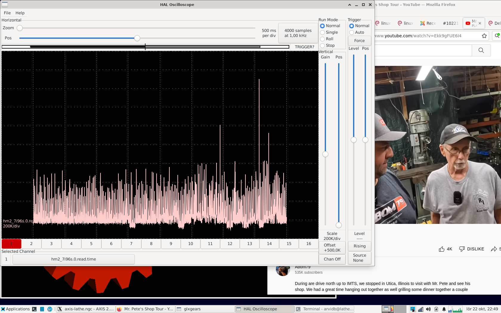

22 Oct 2022 16:27 #254767 by arvidb
Replied by arvidb on topic Mesa hm2/hm2_7i96s.0: error finishing read
I also tried linux-image-5.2.0-1-rt-amd64 and get the spikes there too.

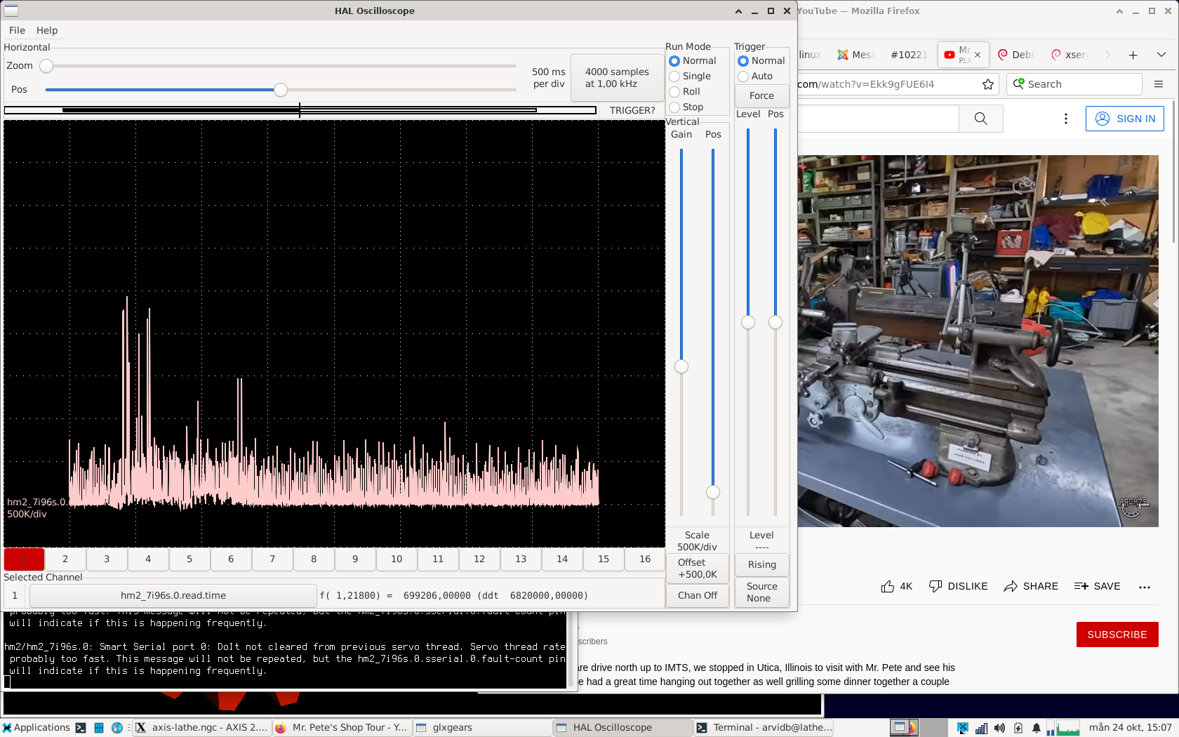

22 Oct 2022 20:56 #254800 by arvidb
I built my own "linux-image-5.0.21-rt16" and here I don't get the latency spikes. (The larger spike in the image was from dragging the browser window around; it still wasn't enough to trigger any latency errors from linuxcnc.)
I guess next step is to try a 5.2 kernel built on the same config. But not today! *snooze*

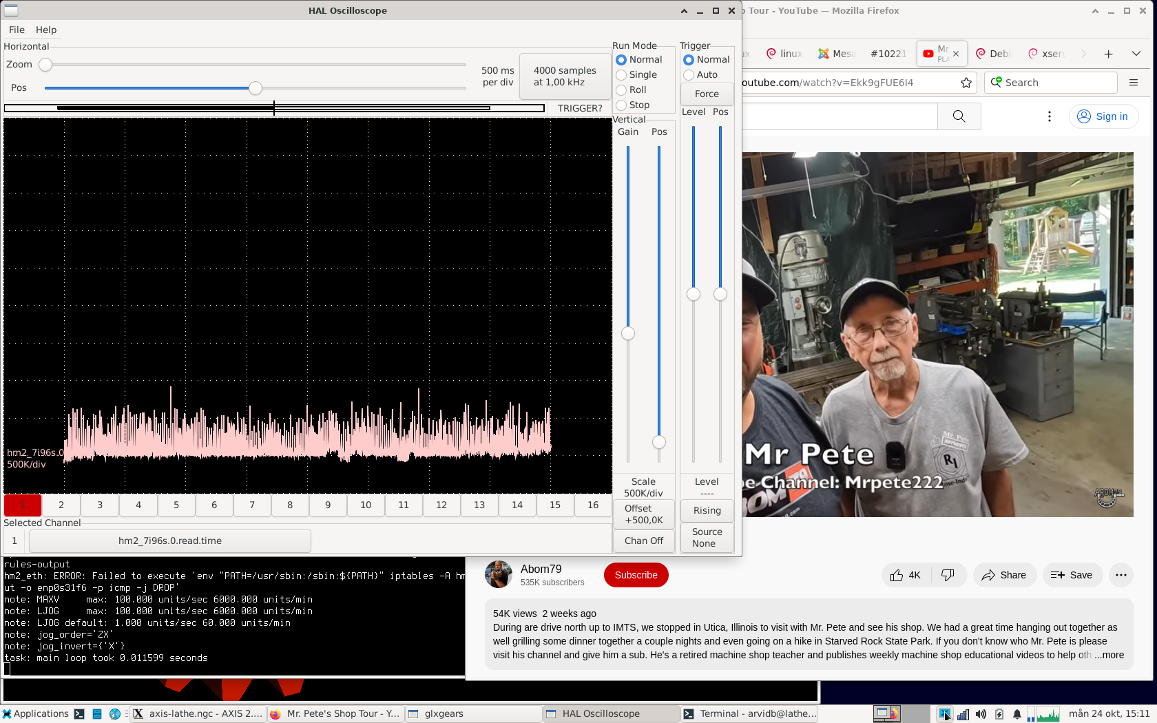

24 Oct 2022 13:18 #254907 by arvidb
An interesting result here comparing Debian's linux-image-5.2.0-1-rt-amd64 and my home-built linux-image-5.2.21-rt15:
Debian linux-image-5.2.0-1-rt-amd64:
DIY linux-image-5.2.21-rt15:
So the issue might have something to do with Debian's patches or the kernel config rather than the kernel version.
24 Oct 2022 18:36 #254938 by PCW
All my tests have been with home built images, and I have never seen the really bad latency
issues on these kernels (regardless or version) that the debian kernels show.
I do find the 4.19 kernel in general is much better latency wise than later kernels,
and may be needed on some host hardware.
