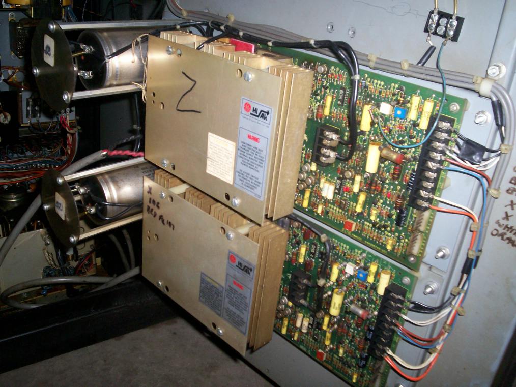

first photo test but shows the hiak axis drivers on my lathe

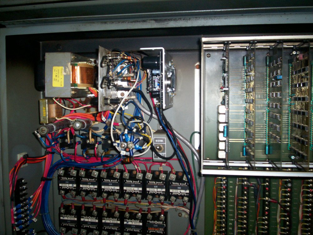

There are a lot of parts there, and a lot a neat wiring. Replacing all that would take a lot of time but a lot less space. Are you shorter of time, or space?

Andy
Neither are a concern time or space I have a 30 x30 shop that I can always move things around to
accommodate whatever I need , I am getting rid of most of my automotive projects and will be replacing with
machining equipment. so no big hurry as far as time goes either.
I am in the process of compiling a list of electronics that I will be needing Just haven't been able to make up my mind
thinking 5i25 with 7i33 but would like to have a nice pendant also.
Bob
