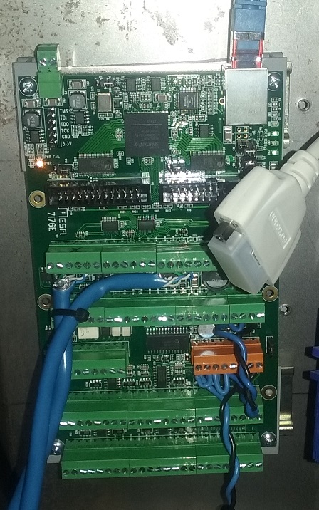

I have the file modified. but I cant figure why I am not getting 2 lights on the mesa card. The 24v power one is lit but the logic power one is not. I am only applying 24vdc (+) at pins 1,2,3&4 and (-) at pin 8 of TB1. I have the W1 junper in the left position which I thought would also power the logic but I am not getting the logic power light.

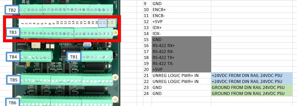

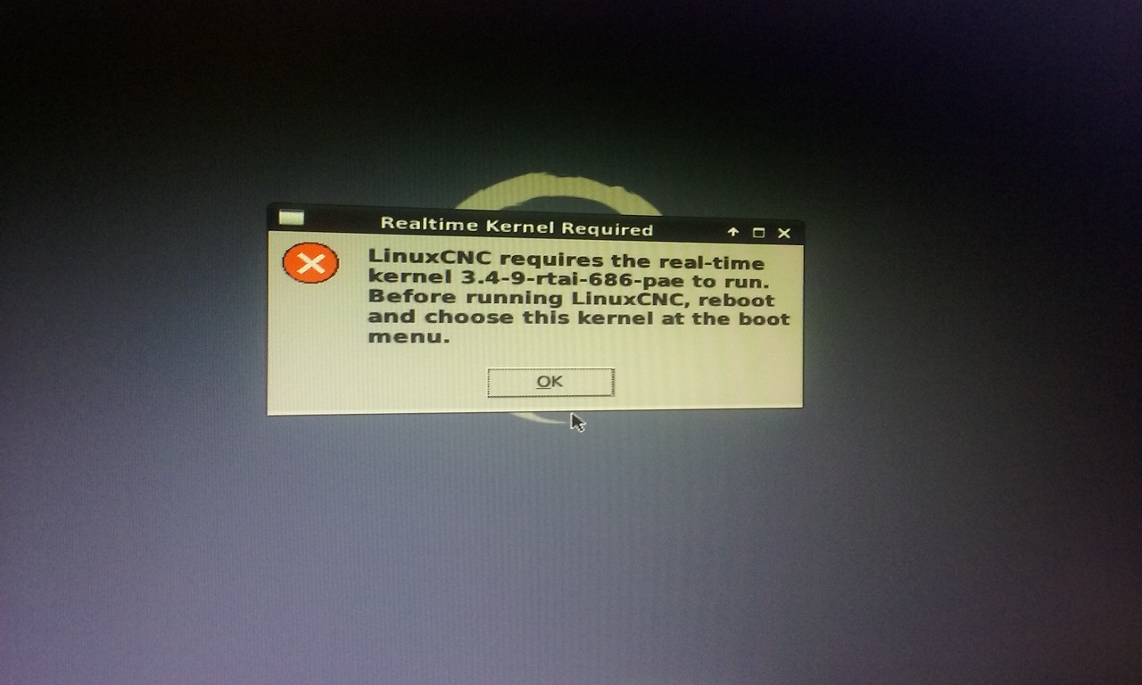

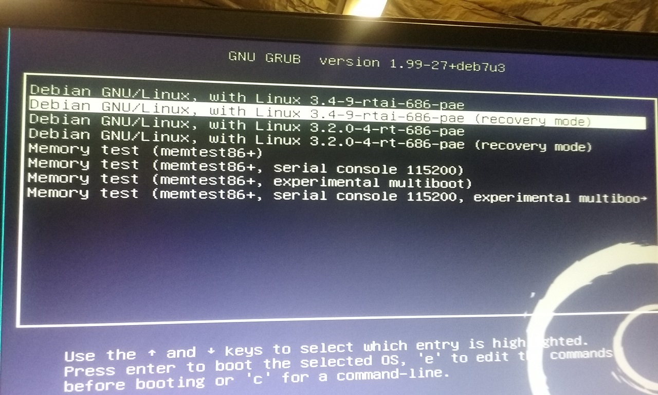

I added the connection for 24vdc on the TB3 connector and the logic power light is now lit. With the computer on it flashes the 4 green user LEDs in sequence and I can ping the mesa card now. So that looks OK. as far as the linux install. I have two choices at startup. The rtai seems to work for linuxcnc, but it may be a configuration issue. When I start in the "rt" version it will not run linuxcnc. any thoughts? I don't start in recovery mode but I have to move the cursor or it automatically chooses the first configuration. I just wanted to get the picture.

Replied by andypugh on topic Emcoturn 120 lathe retrofit
To use the hm2_eth driver you need to be running the preempt-rt kernel and the matching version of linuxCNC.
Instructions here. section 7.1
linuxcnc.org/docs/2.7/html/getting-start...th_preempt_rt_kernel
Check steps 1-4 but you shouldn't have to do anything, you should already be there. Start at "Add the LinuxCNC Archive Signing Key to your apt keyring"
