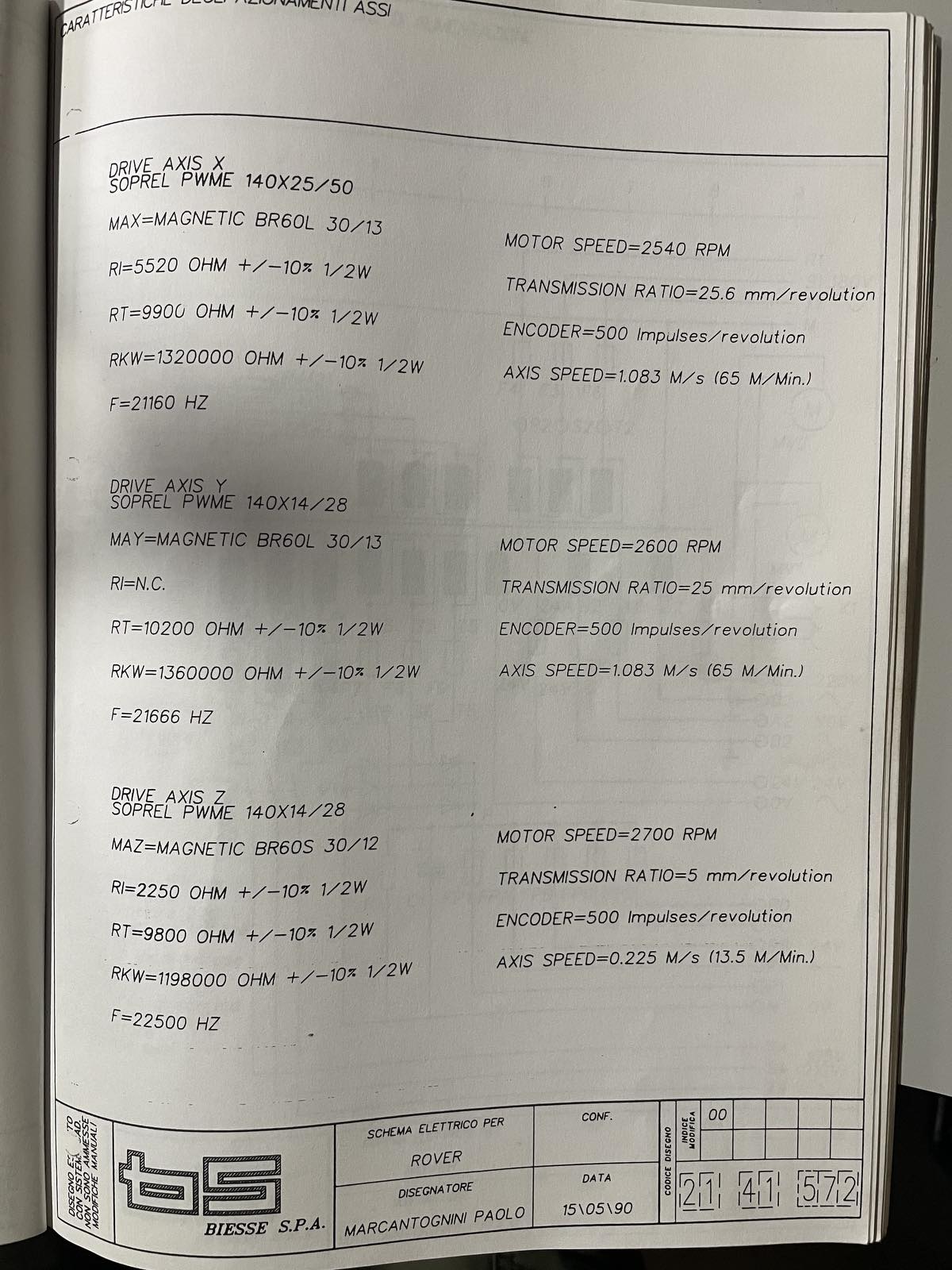

I connected all the basic cables, encoders enable output and + -10v analog output everything works. following tommy's instruction i figured out roughly how it goes, now considering only one axis (Y)
my problem is shooting the encoder scale .. the encoder is 1: 1 connected to the motor shaft ,leadscrew is 25mm/rotation due to join error I can't read the right scale, the machine is still noise and the sound from the motor is strange. but standing on the scales of the engine. Can anyone suggest what approximate values I should enter in servo tuning?
As i calculated from the picture encoder is 500ppr, than 500/25mm is 20/1mm why is that on fill space x 4? I'm still afraid that I didn't enter a good output scale because I left it at 10 max and min and according to the suggestion of PCW it should be according to Figure 1083 and -1083 ff1 = 1?

If the speed is 1083 mm/sec at 10 V then, yes you should set maxscale to
1083, minlim to -1083 and maxlim to +1083 then FF1 = 1.0 will be close
With 25MM/turn and 500 PPR = 2000 counts per turn the scale should be
80 (80 counts per mm)

Peter thank you
this confiq works better, i have no joint error more and the scale is correct for encoder...now I have another problem that has not disappeared before or with this new setting..the first thing is that the motor still produces irritating sound, but not in the sense that it hums or has an imbalance, but some high frequency sound range (tweeter). when I amplify P (I arrived from 0-40) the situation improves as far as the stiffness of the shaft is concerned but the sound is still heard ... another much bigger problem that I can't understand at the moment because there is no error. simply when moving the axis back and forth after a few minutes Linux freezes, and the whole PC, only the mouse moves but it has no function. Did you know why it can be? Bad Pc or same software bug that do it freezes?
