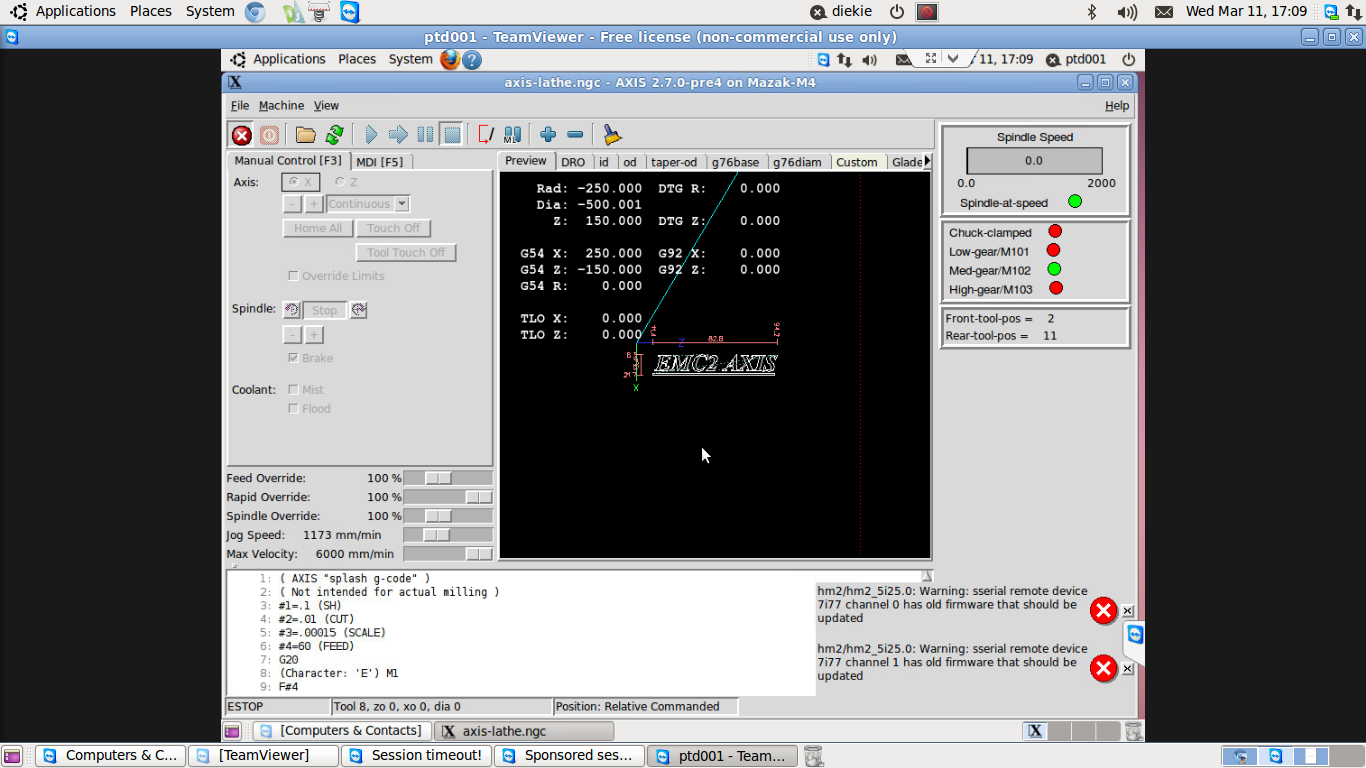

As I already said, it is the 7i77 that needs a firmware update, not the 5i25
The following user(s) said Thank You: Diederik
- Posts: 18899
- Thank you received: 5216
11 Mar 2015 22:01 #56681
Replied by PCW on topic 2.7
Actually they both need updating (the 5I25 firmware Diederik has is too old to allow sserial device firmware updating)
Diederik, you need to power cycle the PC to load the new 5i25 firmware

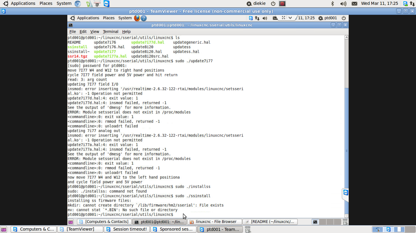

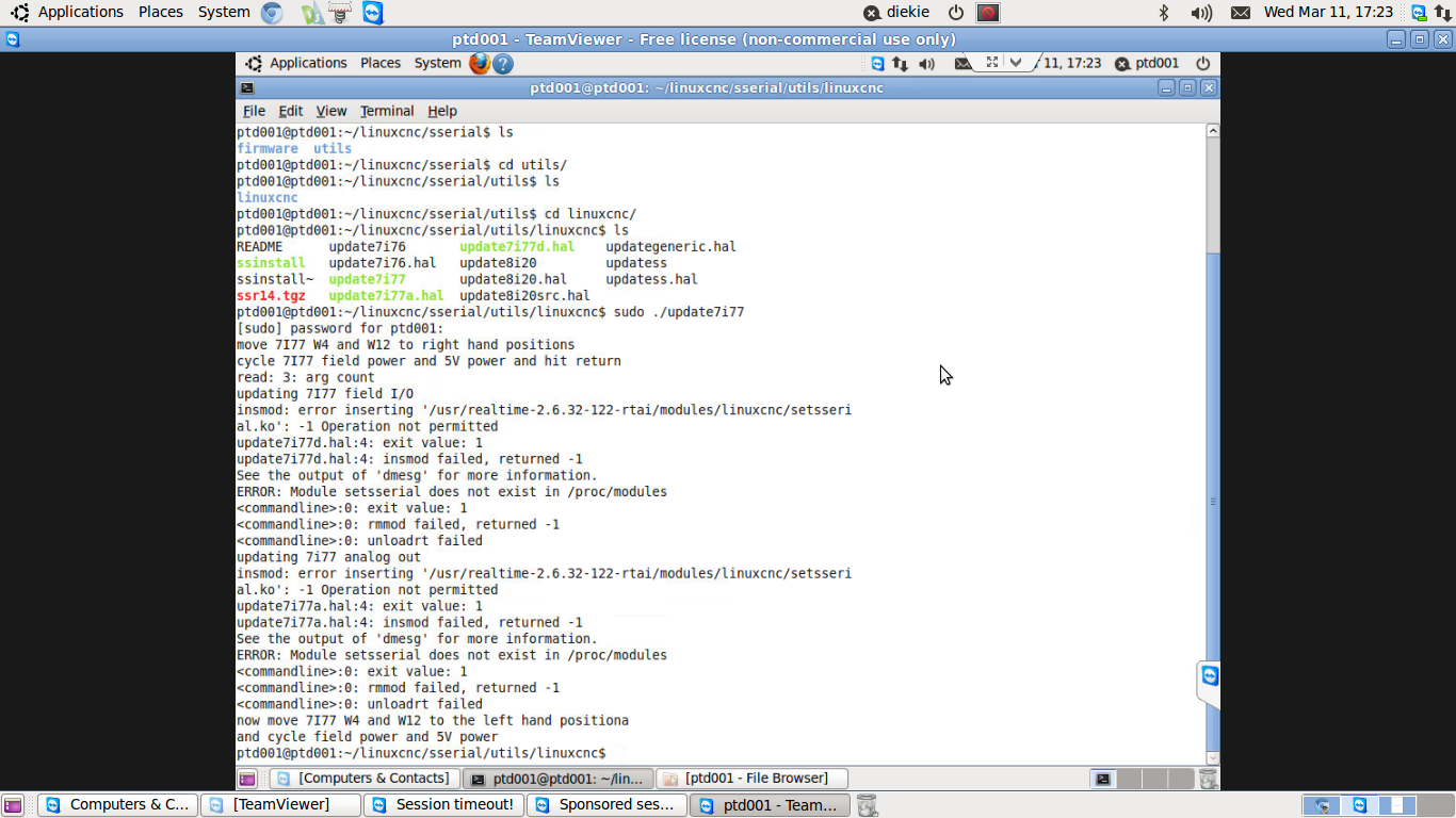

11 Mar 2015 22:01 #56682
by Diederik
Replied by Diederik on topic 2.7
I have tried to do the update for 7i77, as per the readme file, but still no success. it looks as follows:
am I perhaps doing something wrong? (my knowledge on using terminal is limited/ in fact, only getting to know about it now. )
where can I read to get more knowledge about this? I have printed "an introduction to the linux command shell for beginners" and I read through it, but I still can't get my head around it.

I now switched the computer off completely, and booted the system from scratch. still giving the error.

11 Mar 2015 22:20 #56684
Well, yes, but you still haven't updated the 7i77 firmware.
However, now that you have updated the 5i25 it may be that the 7i77 update will work.
Where did you get/find the update7i77 script?

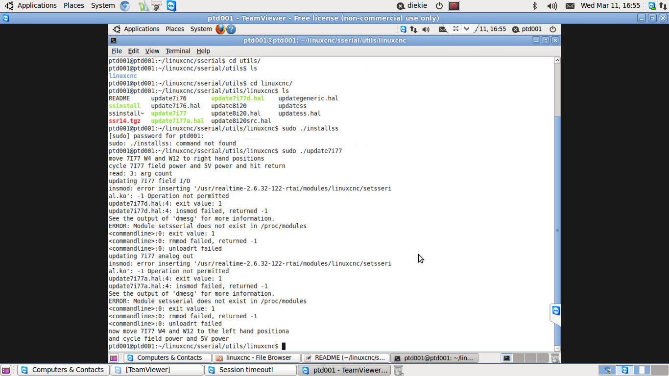

11 Mar 2015 22:51 - 11 Mar 2015 22:53 #56687
Again any setsserial error messages are in the kernel logs so these need to be looked at to see where the error is
Last edit: 11 Mar 2015 22:53 by PCW.
- Posts: 23382
- Thank you received: 4967
11 Mar 2015 22:54 #56688
Replied by andypugh on topic 2.7
There are two things that the prinotuot suggests:
1) What is the output of dmesg?
2) Does setsserial exist in /proc/modules?
Are you perhaps running a run-in-place version of 2.7?

[ 86.230973] creating ladder-state
[ 86.358217] hm2_pci: loading Mesa AnyIO HostMot2 driver version 0.7
[ 86.358271] pci 0000:00:1e.0: can't derive routing for PCI INT A
[ 86.358276] hm2_pci 0000:02:0d.0: PCI INT A: no GSI - using IRQ 10
[ 86.358295] hm2_pci: discovered 5i25 at 0000:02:0d.0
[ 86.361485] hm2/hm2_5i25.0: Smart Serial Firmware Version 43
[ 86.419044] Board hm2_5i25.0.7i77.0.0 Hardware Mode 0 = standard
[ 86.421796] Board hm2_5i25.0.7i77.0.0 Software Mode 0 = input_output
[ 86.424132] Board hm2_5i25.0.7i77.0.0 Software Mode 1 = io_analog
[ 86.428329] Board hm2_5i25.0.7i77.0.0 Software Mode 2 = io_analog_fieldvoltage
[ 86.433565] Board hm2_5i25.0.7i77.0.0 Software Mode 3 = io_encoder_analog_fieldvoltage
[ 86.509683] hm2/hm2_5i25.0: Warning: sserial remote device 7i77 channel 0 has old firmware that should be updated
[ 86.527621] Board hm2_5i25.0.7i77.0.1 Hardware Mode 0 = standard
[ 86.530251] Board hm2_5i25.0.7i77.0.1 Software Mode 0 = analogout_enables
[ 86.574104] hm2/hm2_5i25.0: Warning: sserial remote device 7i77 channel 1 has old firmware that should be updated
[ 86.630862] hm2/hm2_5i25.0: 34 I/O Pins used:
[ 86.630870] hm2/hm2_5i25.0: IO Pin 000 (P3-01): IOPort
