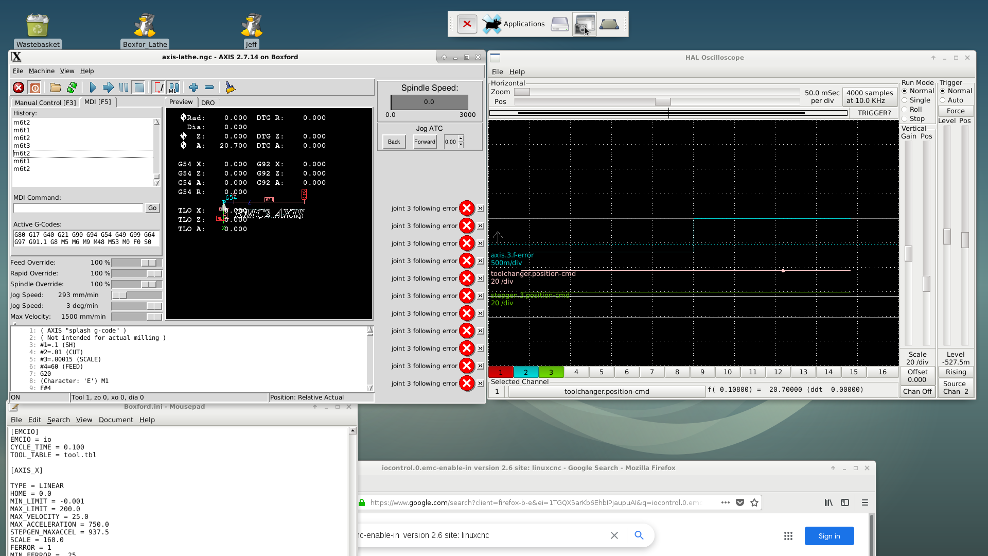

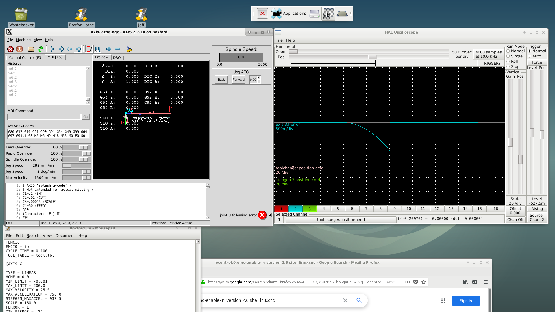

- Clive S
- Posts: 2204
- Thank you received: 486

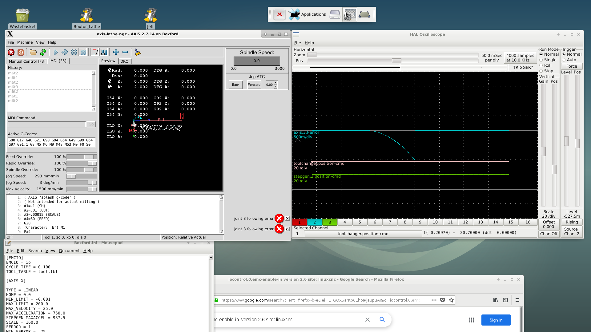

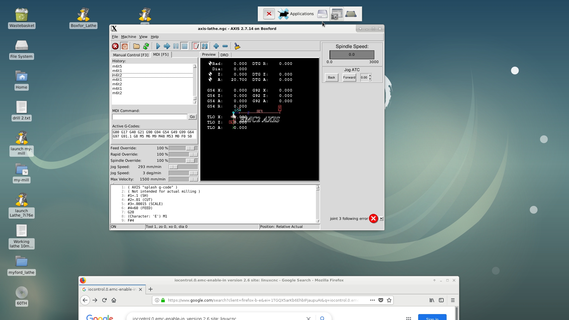

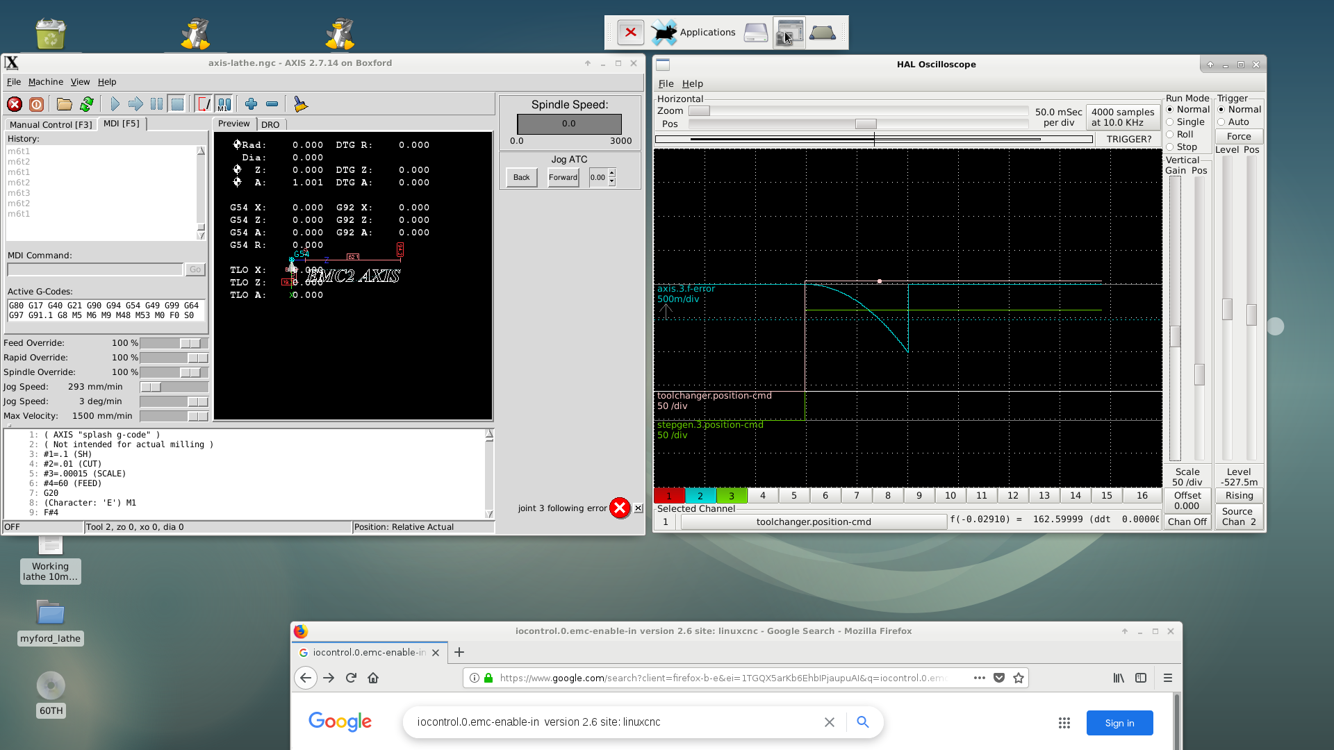

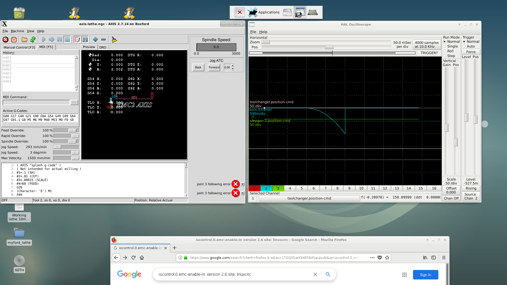

25 Oct 2020 11:24 #187183
by Clive S
Re: Does it really have a 1000 degree step? not sure what you mean by this.
This is the first plot with the ferror at 1000 and min_ferror at 1000
then the second ferror at 1000 and min_ferror at 1000
The next 3 are with ferror at 1 and min_ferror at 0.5
The they are like this until the DRO gets up to 21.7 I am pressing F2 to run between the errors
Now it is 21.7 on the DRO I think this is the final position where the turret should be. (I am doing this on the bench ie no physical machine).
