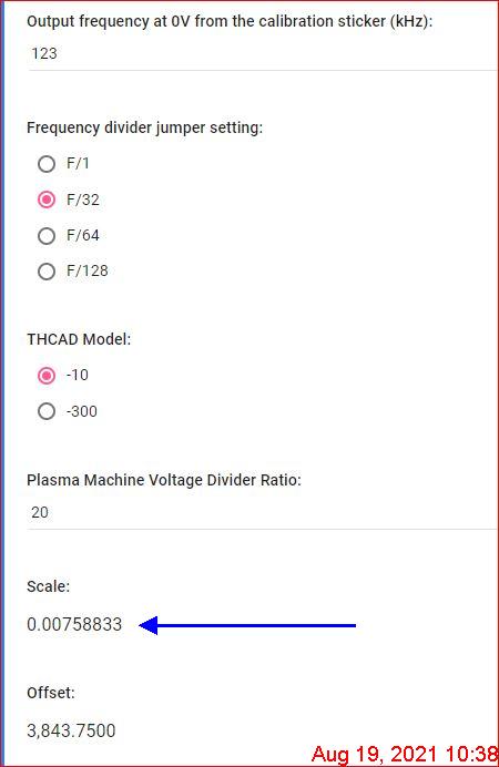

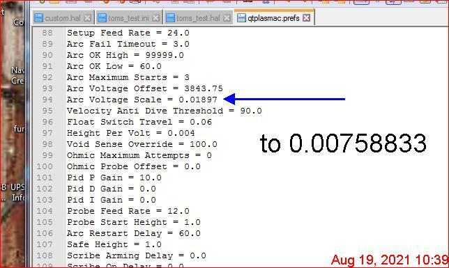

I did motor tuning and have things working well. It seems like I need to change the voltage divider setting in the Hypertherm to 20:1 (now at 50:1), I know how to do it in the Hypertherm. I know it was set in the Pnccofig originally but don't know where to change it in the INI or other file. I do see where to change the setting for the Ohmic for the THCAB-5, but not the range for the THCAD-10. Is there a way??

Ok after snooping around I think I found where I need to make the change for the voltage divider value. Using the calculator that is on line and making the change to 20:1 the new value is 0.00758833 for the THCAD-10 I have per the sticker on the back. This is done in the qtplasmac.prefs file. please let me know if this is correct.

You can change ARC Voltage Scale and Offset in the QTPlasmaC gui.

thanks Tommy I thought that was where is was from the post above. Great help again, I hope that corrects the lost arc message I was getting.
