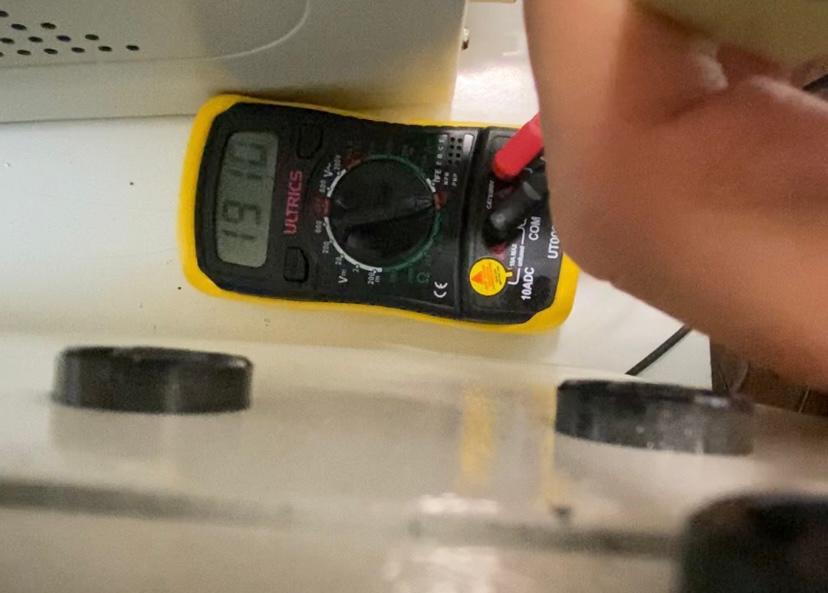

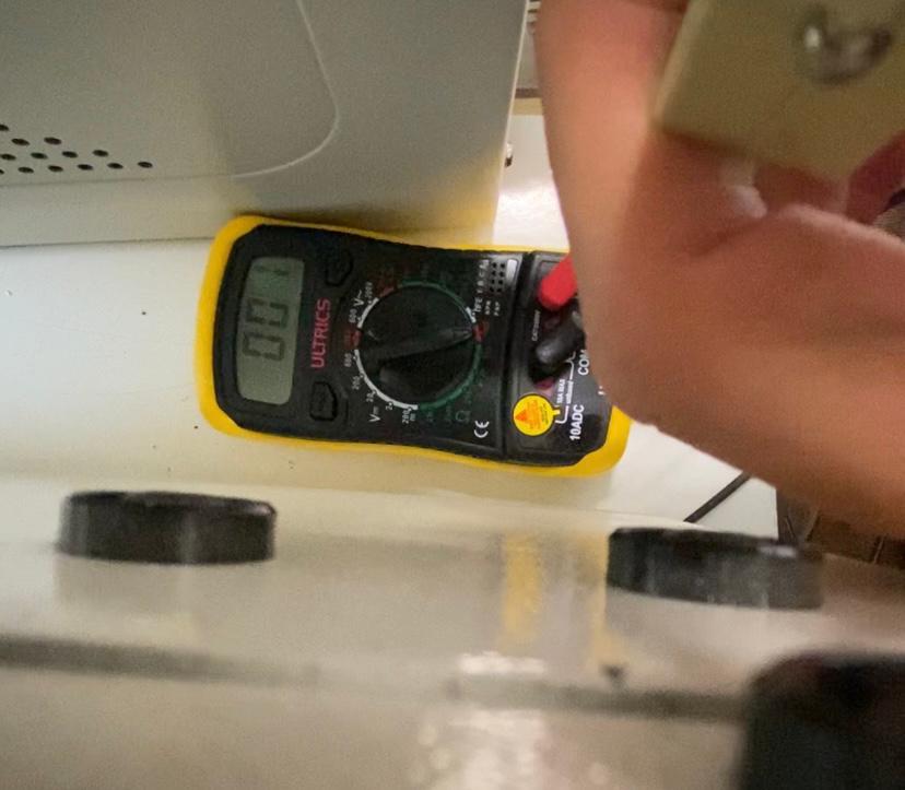

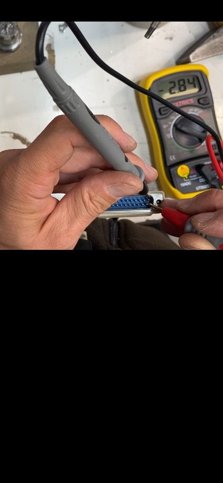

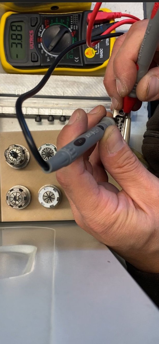

22 Sep 2022 16:51 #252574 by clayd_lopunk
Replied by clayd_lopunk on topic Retrofit cnc 3axis
I have performed the tests but without a satisfactory result. I did the first test with pins 13 and 25. The voltmeter at 20 measures 2.8 / 3.8V if I set it to 2 mi it gives a value of 10/11 or -1 but it doesn't reach 24.
I did the tests on the male db25 cable next to the db9 that comes out of the machine and goes to the pc. I also tried to test it in a mirrored way in case the schematic pinout was the other way around. Could it be that the signals are at 5v? If I have a 3.8V result does it mean that the ground is in that pin anyway? Also, to do the other tests with the axes enabled, do I have to open the cable socket and test the pins from behind? If I disconnect the db25 from the pc, the machine gives an error before enabling the axes.
I enclose the tests
Thanks Alex
22 Sep 2022 18:10 #252576 by Aciera
Replied by Aciera on topic Retrofit cnc 3axis
Yes, as a matter of fact that is what I expected to come from the PC but the "24V" in the pinout of db25 on the schematics made me wonder if maybe the PC card is switching 24V coming from the controller.
Not necessarily. What you could try is to use the ohmmeter to see if a pin on the db25 connector is connected to the case of the controller as the Ground might well be connected to the body of the controller, the pc and or the machine. Remember to only use the ohmmeter with the controller/pc switched off.
Yes, you need to find a way to probe with everything connected.
