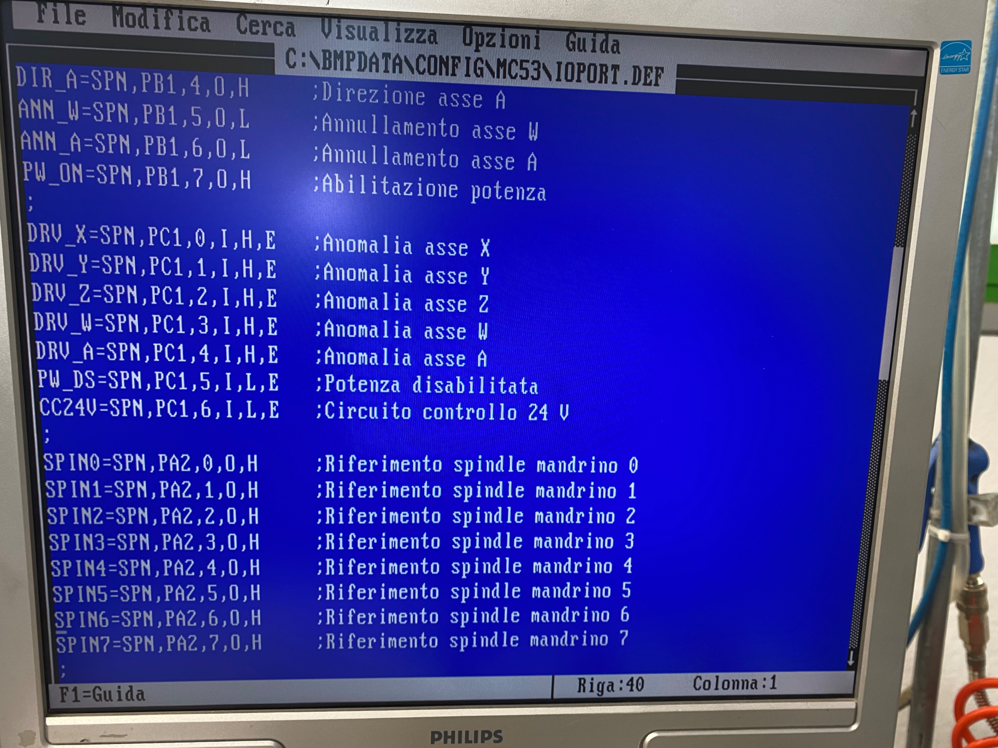

Very well Aciera, I will try to see if by turning the spindle I have any variations on the transistor pins, and I will check the volts of the input device and the 8 relays if I find some more precise results. When I turned the spindle I had no variations on the transistors and no input lights turned on, but tonight I check everything in a better way.
I would like to avoid disassembling the motor boards, but if it were the last resort ..

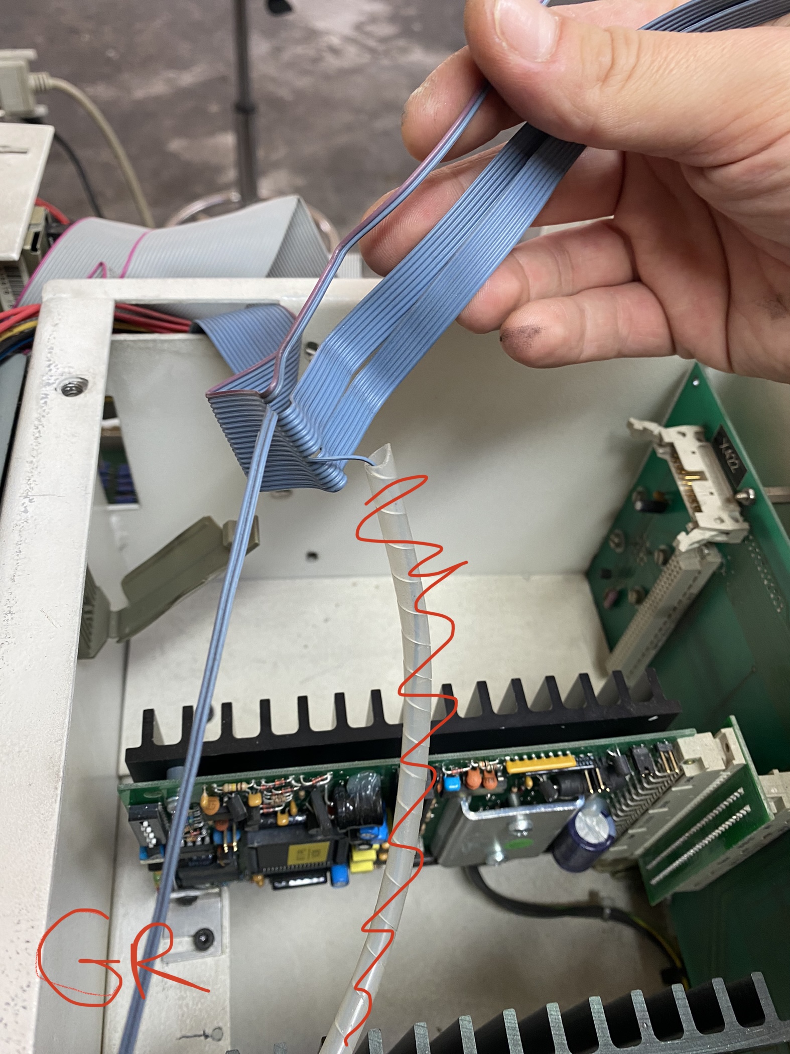

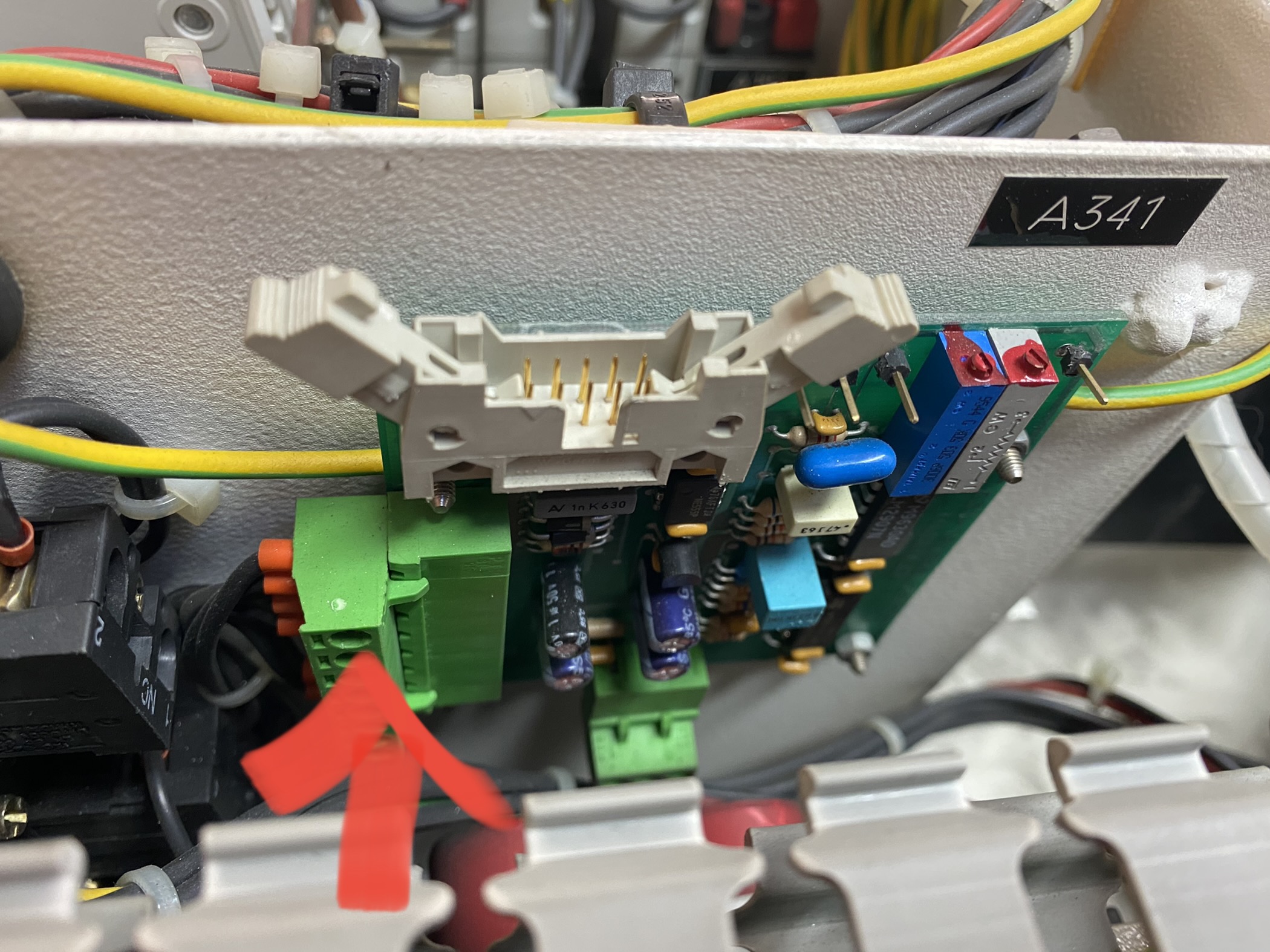

Replied by clayd_lopunk on topic Retrofit cnc 3axis
Io
- clayd_lopunk
- Posts: 60
- Thank you received: 3
05 Oct 2022 23:26 #253578
by clayd_lopunk

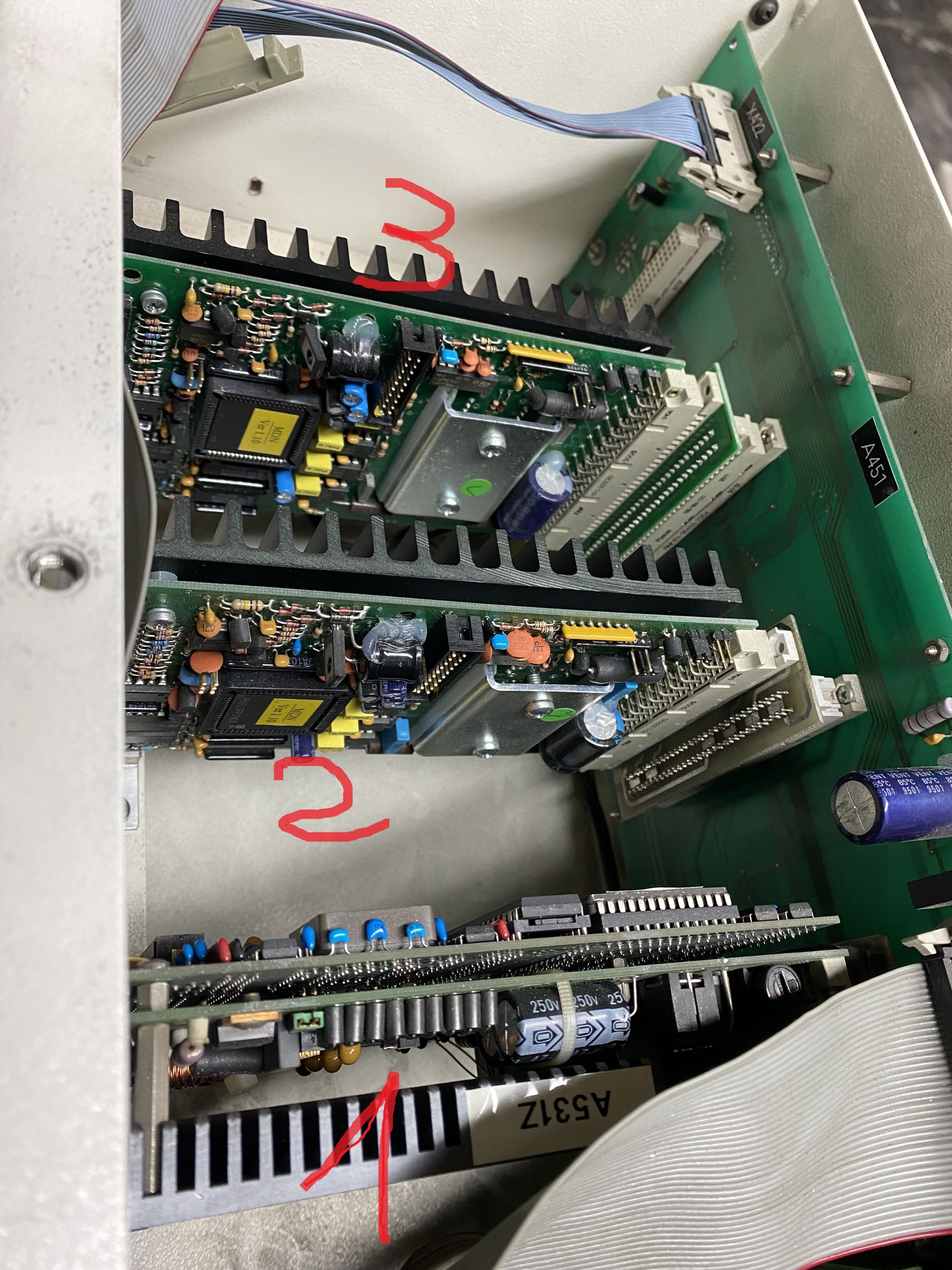

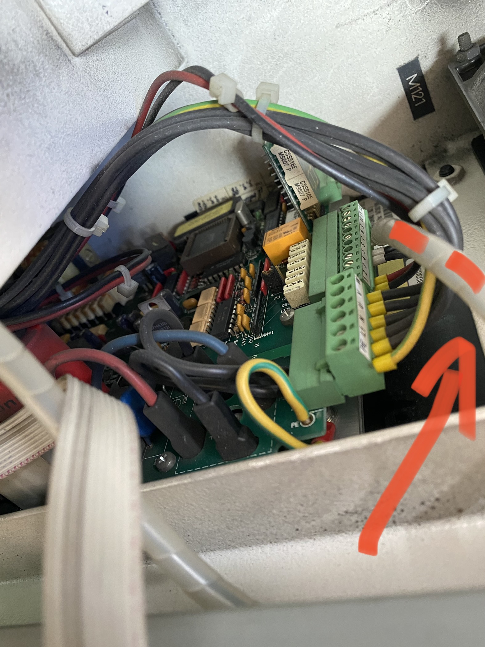

After the photos, the A341 card seems to be connected to the front buttons of the panel, I have already detected them as input devices, except for the spindle potentiometer. The flat cable coming out of this card goes to the large drive card, where the input and output flats are. I noticed that if I press the button to enable the axes at any time the machine clicks and they seem to remain enabled until the red emergency button is pressed. I found the pin that turns the spindle on one of the transistors, when I activate the rotation the value goes from 12 to 0, also on one of the relays I found the nebulizer command. The flat output cable clearly carries pins 2-11 from a yellow-green ground cable as we had supposed, the single cable protected by the plastic instead corresponds to the pin that turns the spindle. How can I find the spindle references. Do I have to disassemble some boards to better understand and take pictures?

Replied by Aciera on topic Retrofit cnc 3axis

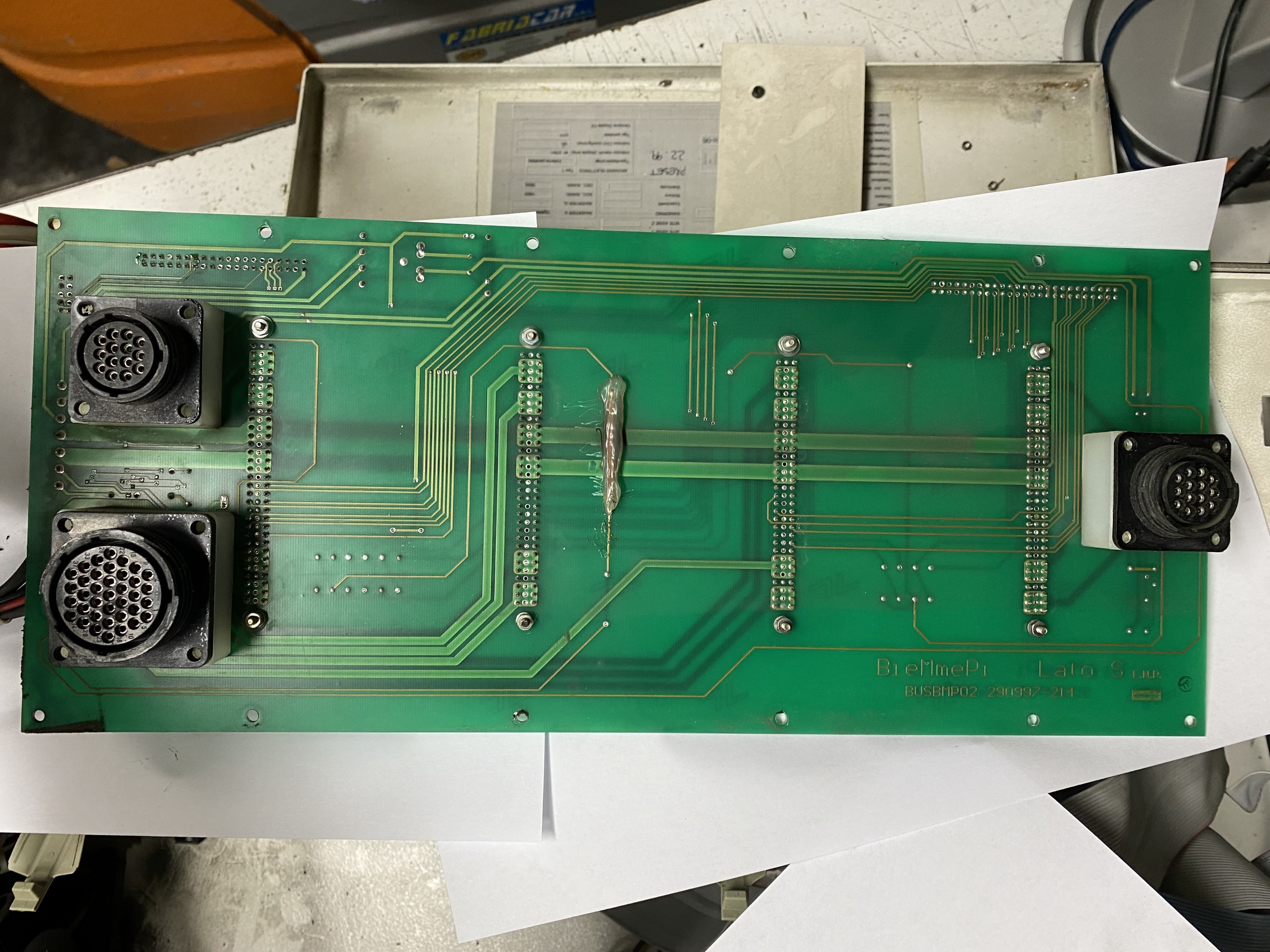

It would certainly be the easiest if you could take the boards out and post high resolution pictures of the front and back.

Might as well pull out all the boards, the more information the better.

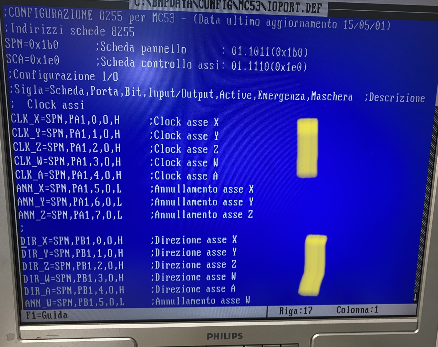

06 Oct 2022 15:44 #253617
by clayd_lopunk

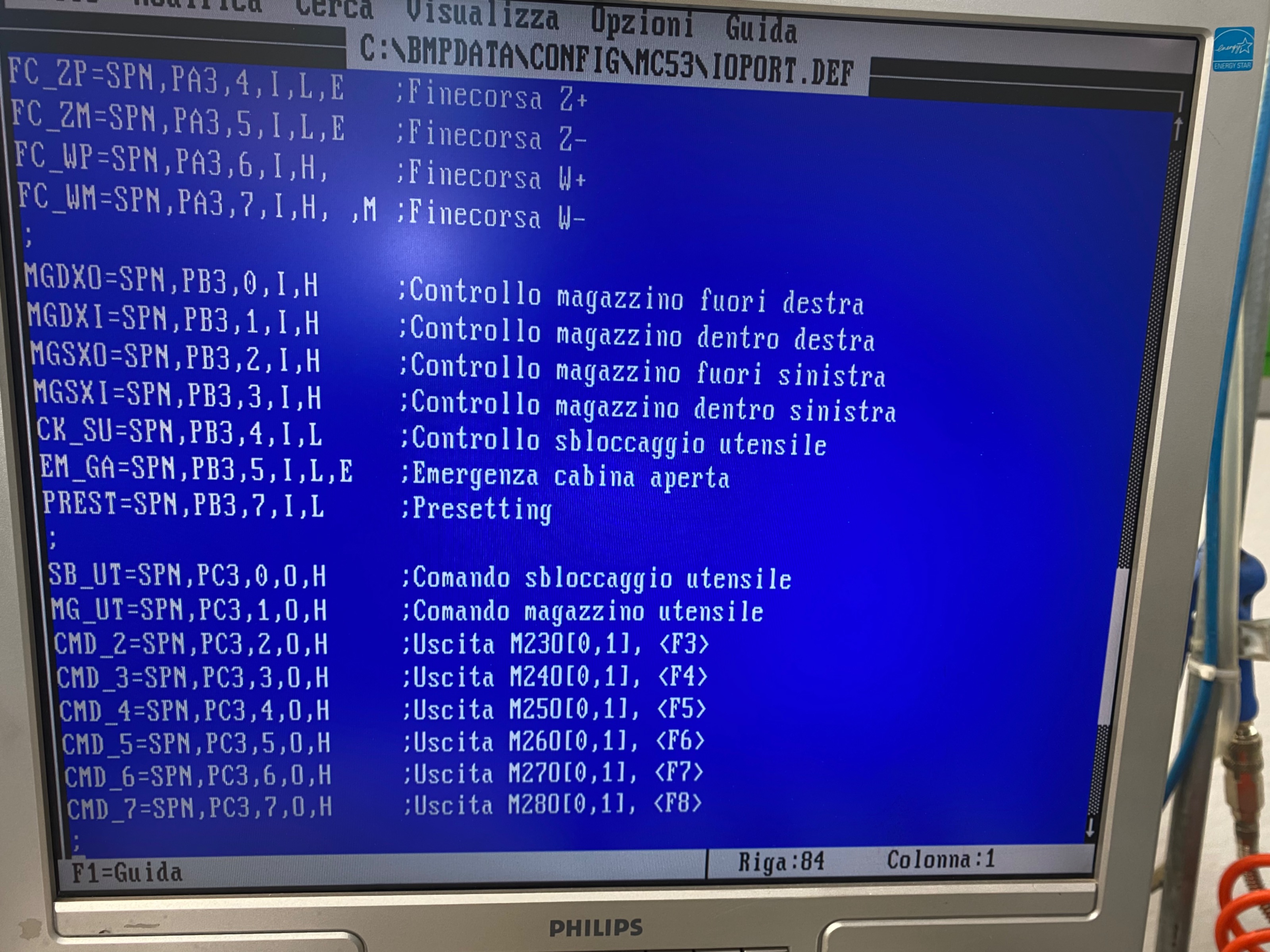

The boards behind the push-button panel are difficult to access if I don't disconnect the whole panel ... I'm afraid then I won't be able to reassemble everything correctly. I see what I can do! I found in the software a draft of the drives required by MC53, they refer to the updated version (i.e. the one of the wiring diagram), in this older machine there are fewer, there are no lights and the advance potentiometer is missing, there is only for the spindle.
In the meantime, I am attaching a photo of this too.
Thank you
Thank you

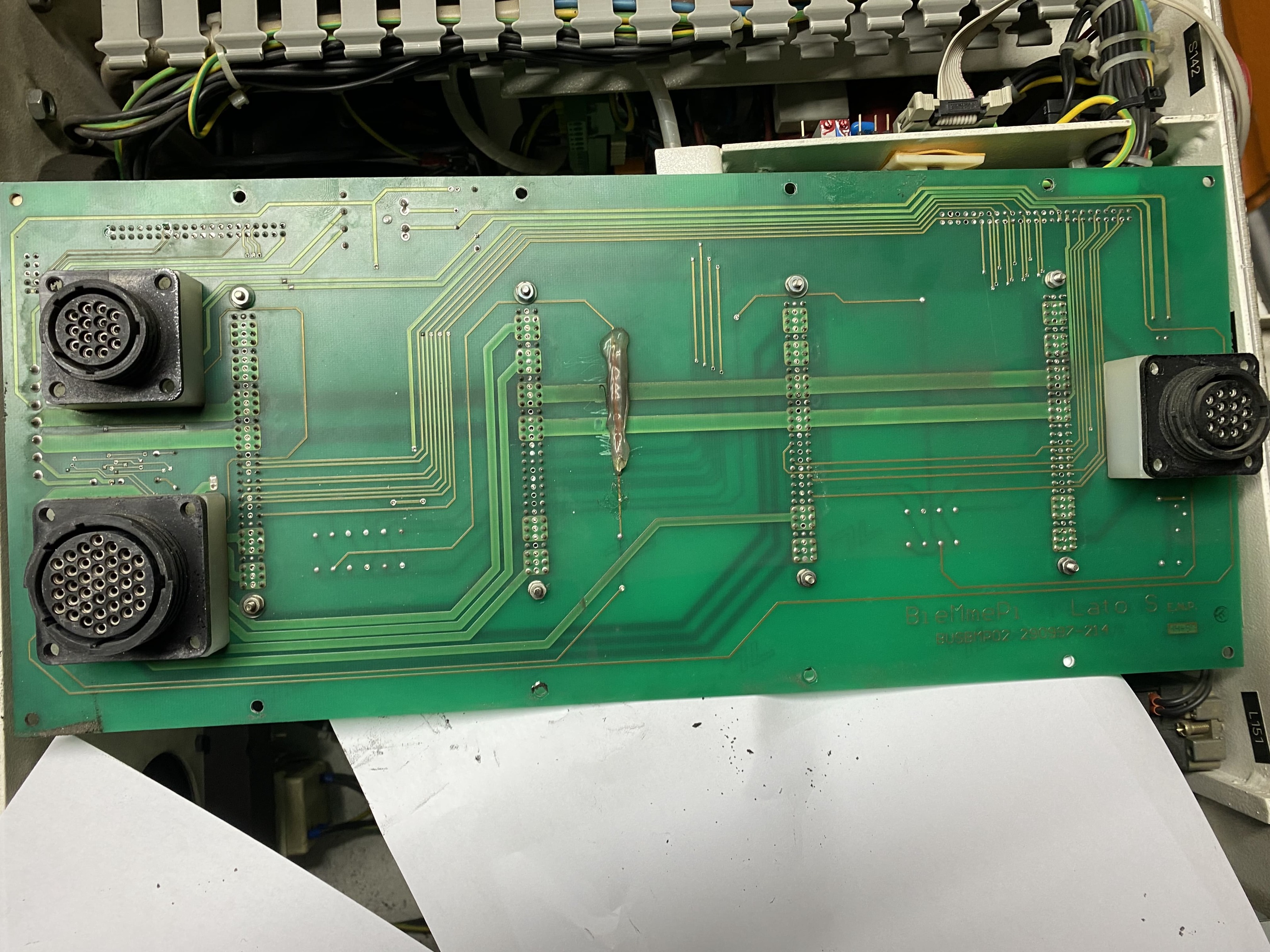

06 Oct 2022 22:08 #253638
by clayd_lopunk

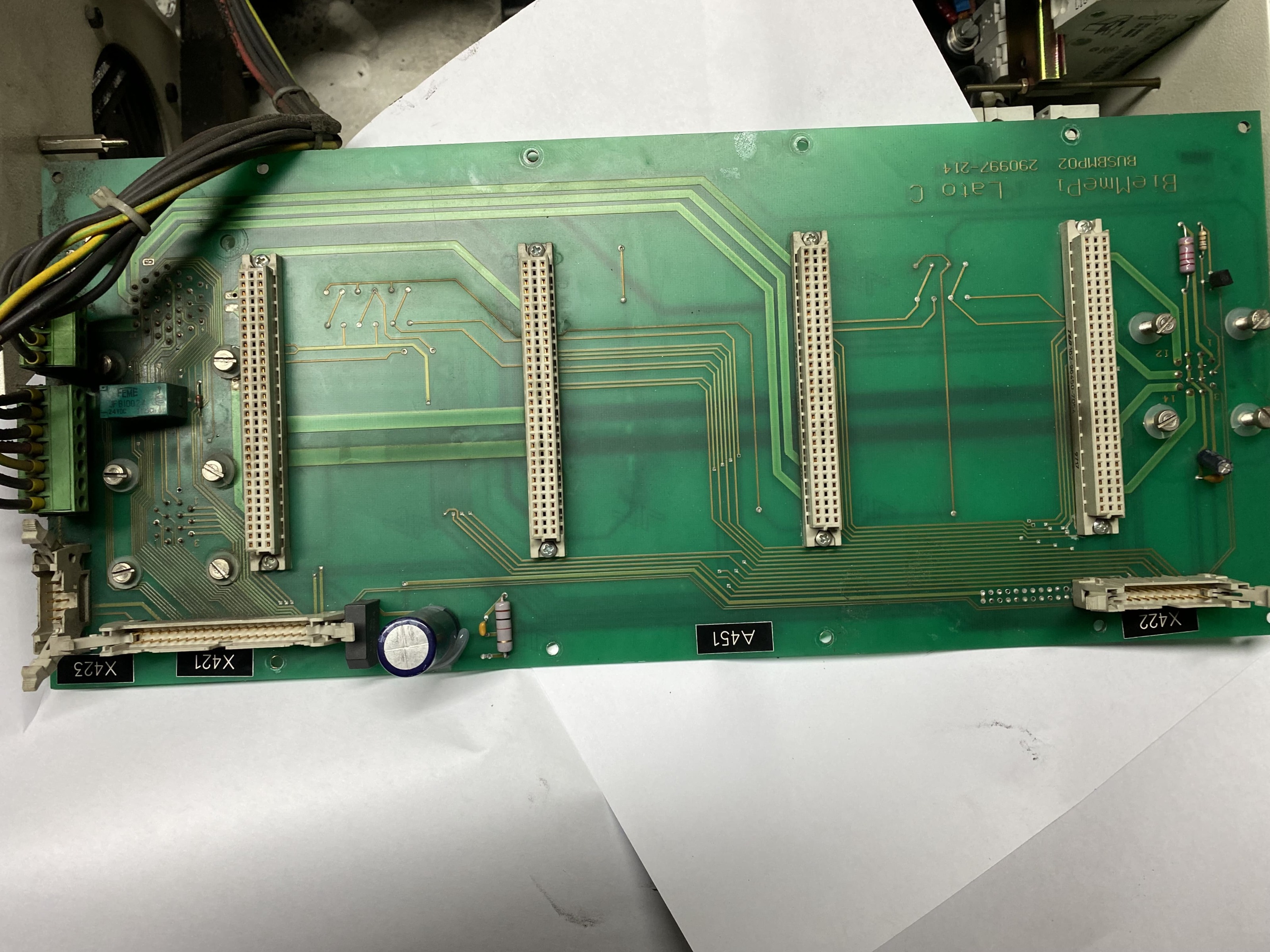

board
- clayd_lopunk
- Posts: 60

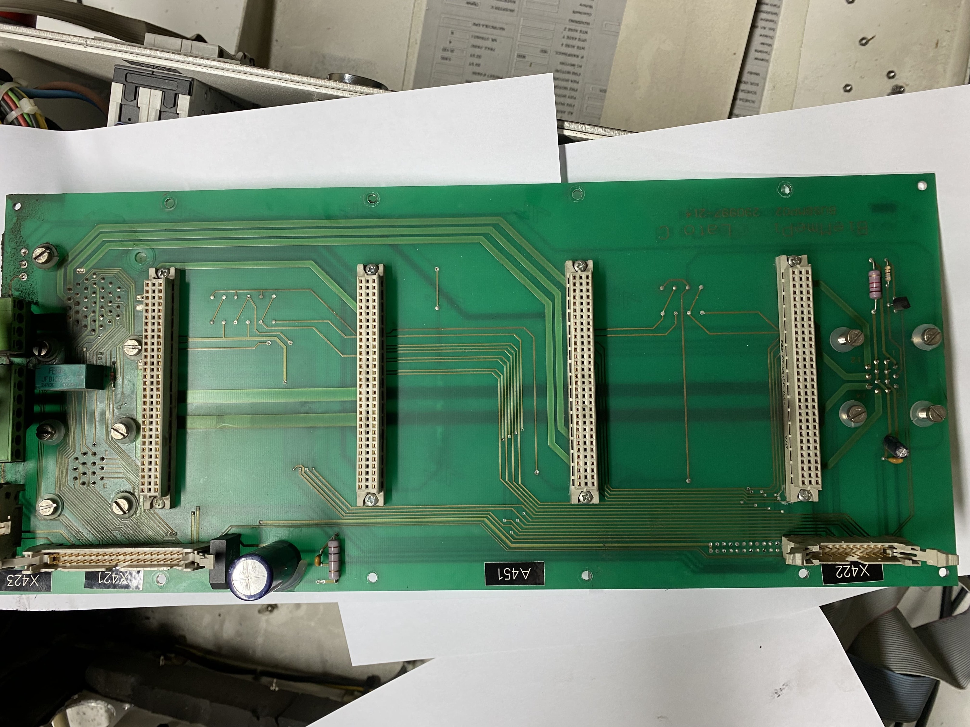

06 Oct 2022 22:18 #253639
by clayd_lopunk
b1
