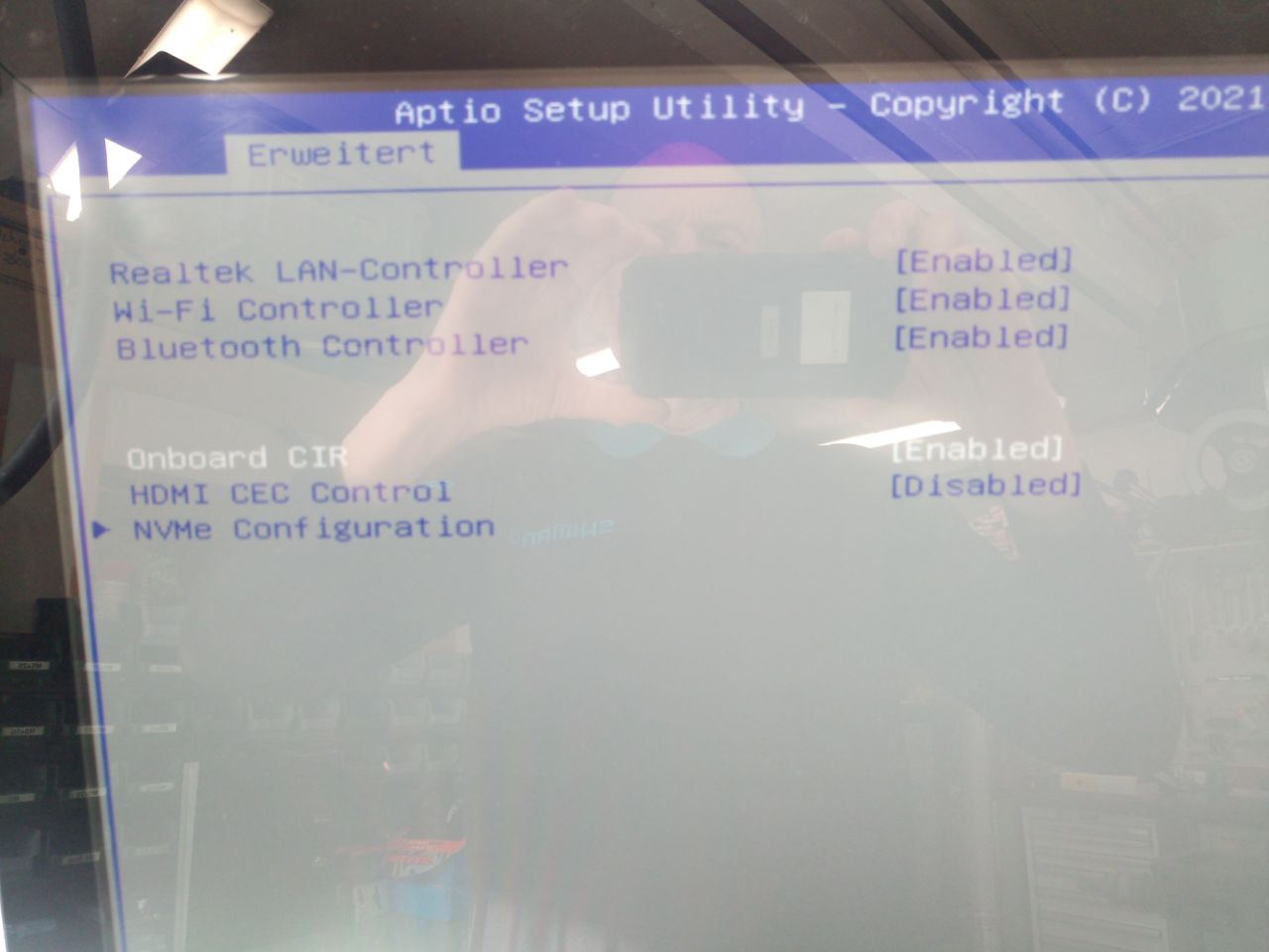

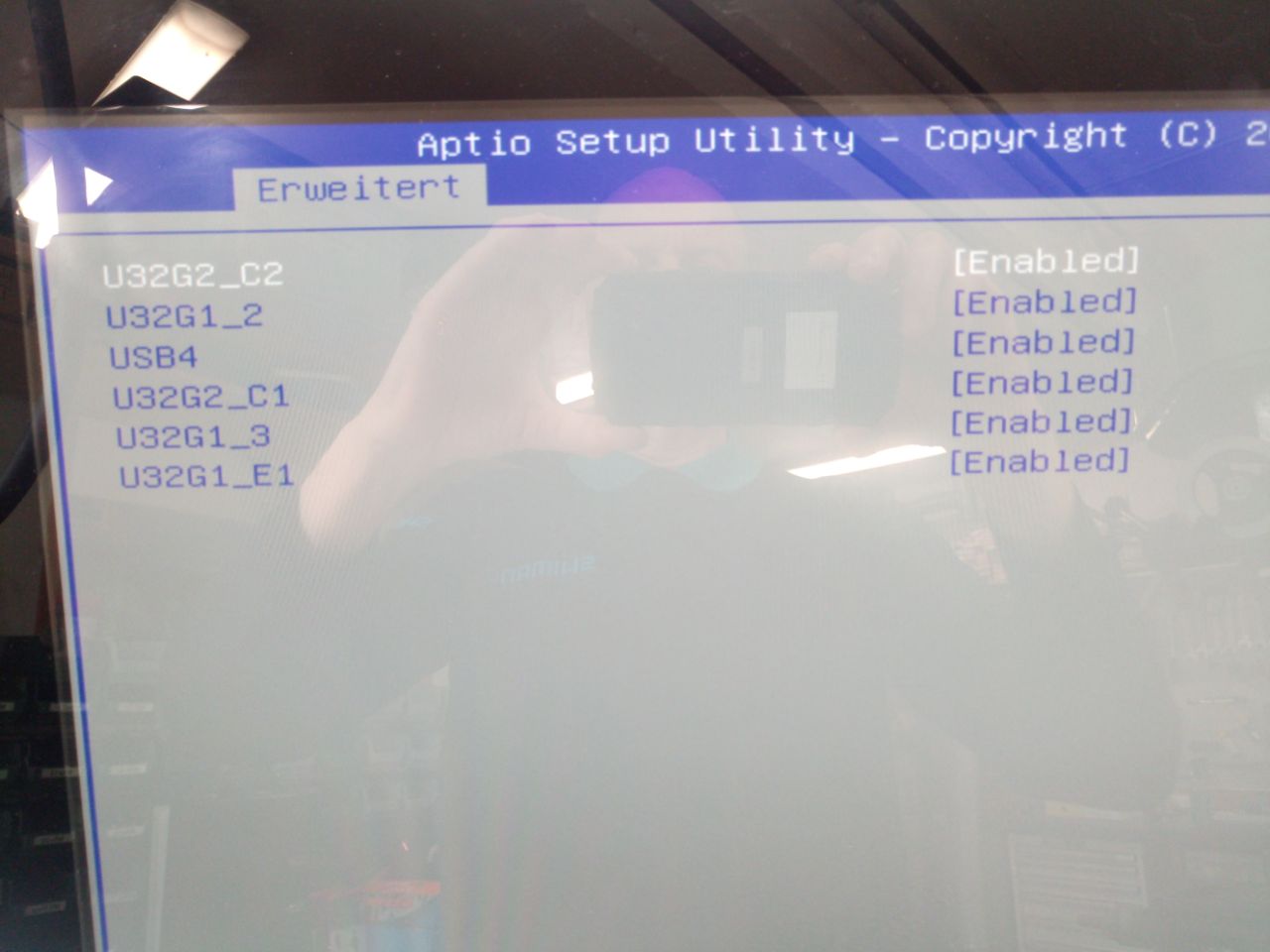

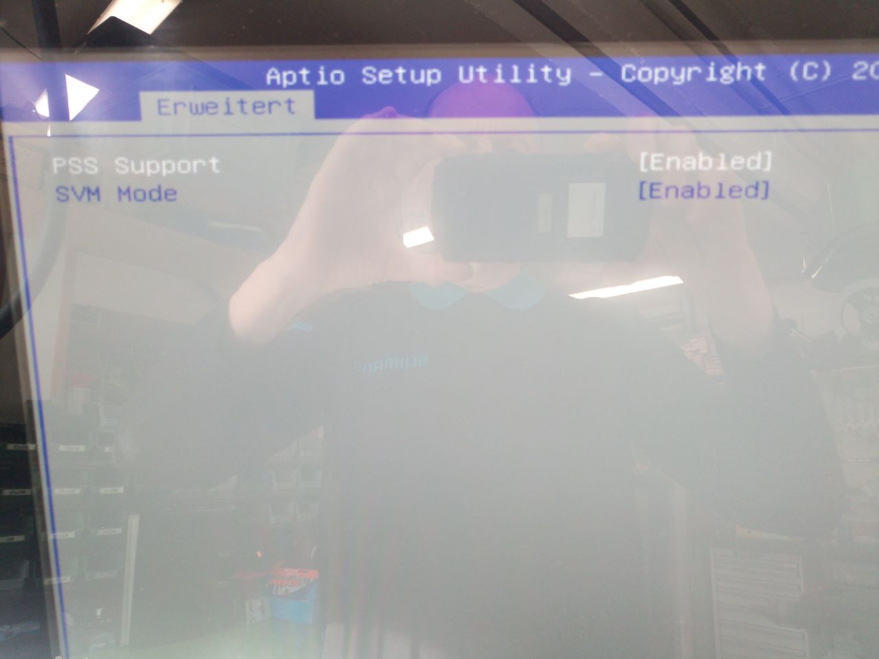

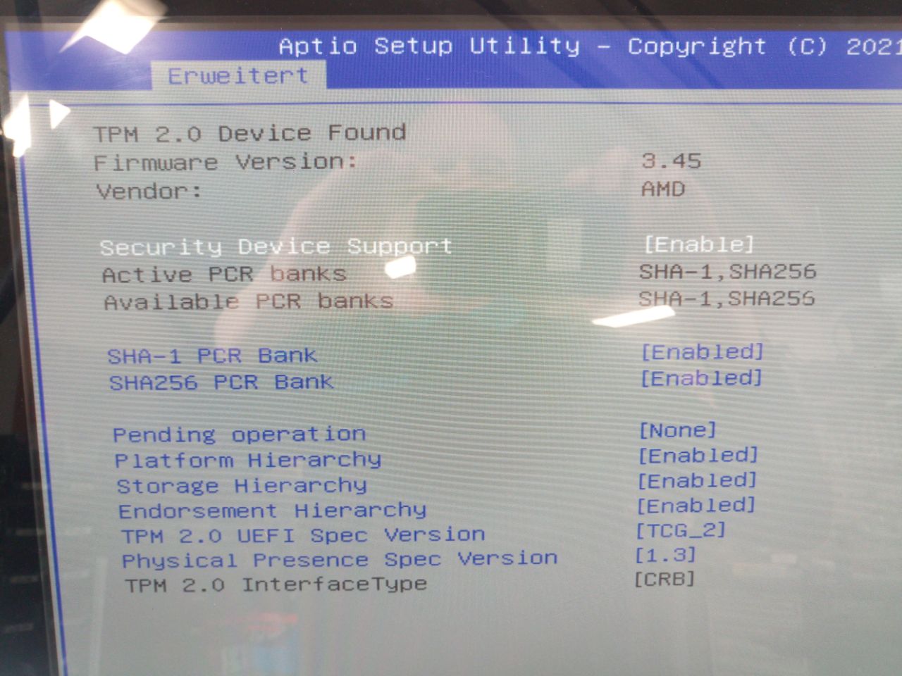

On your last BIOs picture:
forum.linuxcnc.org/39-pncconf/52373-pncc...7i76?start=10#298822
There were 8 sub options. All of them need to be investigated.
My guess is that you still have some power management / EIST /Cool and Quiet
/ Turbo mode / CPU speed switching enabled This will ruin the system latency

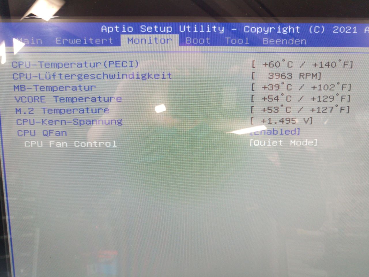

25 May 2024 14:14 #301411
Replied by tommylight on topic PNCconf 7i92H and 7i76
Yeah i keep forgetting this as it is not a wide spread issue, but Asus boards, enabling Q Fan speed will mess the latency badly as soon as it kicks in.

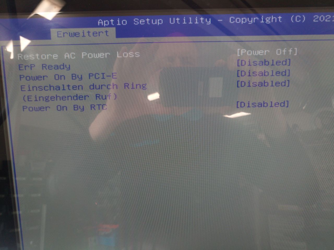

27 May 2024 07:58 #301545
by stonebite
Replied by stonebite on topic PNCconf 7i92H and 7i76
So to go through the points from back then again
In the menu item
APM Configuration
Restore AC Power Loss > is power off
ErP Ready > is enable S4 S5 is now switched off
Power on by PCI-E > disabled
Power on by Ring > disabled
Power on by RTC > disabled
The following menu item is now new
CPU Fan Control now set to Quiet Mode instead of normal mode
i understand your statement, but i don't know all the technical terms in the AMI aptio menu and especially the terms you mention, i don't know what influence they have on the function and physically. if the fan is switched off, does the processor probably overheat?

27 May 2024 08:15 #301547
by stonebite
I have now set the fan speed to quiet mode, but when I am working on the PC and LinuxCNC is open, it still switches to an audibly higher speed. This is starting to annoy me. Shouldn't it be possible to run LinuxCNC? Unfortunately, I'm coming back to my statement that the ASUS PC with AMD processor was a terrible purchase.
