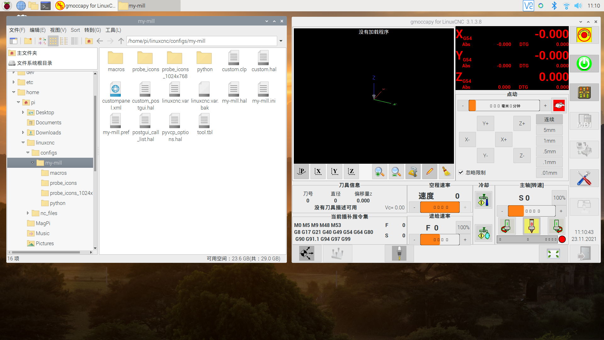

Some problems occurred during my use.
I want "probe_screen_v2" to work in "gmoccapy GUI", I followed the guide, but did not succeed. I used the same operation in "Axis GUI" but succeeded, I don't know why.
I use a parallel port board to control my machine. I use the P11 pin to receive the probe signal, but I don't know how to set up my ".hal" file.
I am a newbie, can anyone help me, thank you very much.

For my MESA based system which started out as a PP type I had:
# net min-home-x <= parport.0.pin-11-in
Now it's which is the same pin on the DB25.
net min-home-x <= hm2_7i92.0.gpio.014.in
I have my probe on the second PP documented like this:
#IO Connections for P1
#Pin# I/O Pri. func Sec. func Chan Pin func Pin Dir
# 15 20 IOPort Probe 1 Probe (In) Probe Input
# ---probe signal---
# begin Touch Probe
# DB25-2_15 is Touch Probe Input.
net probe-in <= hm2_7i92.0.gpio.020.in_not => motion.probe-input
# end Touch Probe
I believe you'd have to do this:
net probe-in <= parport.0.pin-11-in => motion.probe-input
you might need parport.0.pin-11-in_not if the polarity is backwards.
Hope that helps a bit.

- tuzki
- Posts: 48
22 Nov 2021 21:20 #227366
by tuzki
Replied by tuzki on topic Work with probe
- ikkuh
- Posts: 273
- Thank you received: 48
23 Nov 2021 03:09 #227385
by ikkuh
I have been using the screen for months now, most errors are fixed, the develloppers are very responsive and nice in case of a bug or question.
As I understand it Norbert is working on a new version of gmoccapy, you can wait for that too.
Replied by ikkuh on topic Work with probe
I do not mean to hijack this thread but why don't you switch to qtDragon? Chris has been busy the last few months to make it a very good and stable screen (and it look great too). You can use the gmoccapy probing routines if you want to remap M6. The probe-basic and VersaProbe screens are already built in and work fine. All you need is a properluy setup probe and the probe screens will work. For the M6 remap you have to do a little more work, but there is some progress in automating stuff and making things more user friendly.I have a problem using "probe_screen_v2" in "gmoccapy GUI". I followed the guide, I opened "gmoccapy GUI" and found that there was no interface about "probe_screen"
