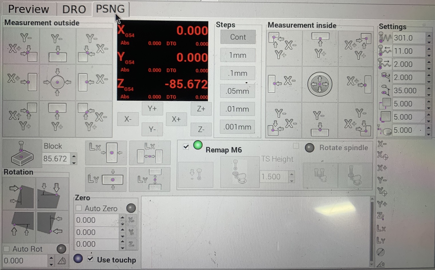

- alkabal
- Posts: 476
- Thank you received: 52
17 Jan 2022 16:33 - 17 Jan 2022 16:33 #232195
by alkabal
Replied by alkabal on topic Work with probe
Hello all.
The actual fork for probe screen next gen seem to be dead (i haven't the admin stuff...).
So i have actually created a new project on github, your welcome for test comment and propose change if you like it.
Some little change done to GUI, but stuff completly revised :
-Possibility to swap from 3D touch probe to Touchplate with a simple tickbox.
-Manual tool change with auto length use now built in python stglue remap. (i think about going back to a ngc version)
-You can bypass the auto length stuff with a simple tickbox.
-Config is done for use separate input for Touch Probe (or Touchplate) and Tool setter and the status is checked before each move.
Of course status is something like beta, use with precaution.
github.com/alkabal/PSNG_V3
Br
Br
