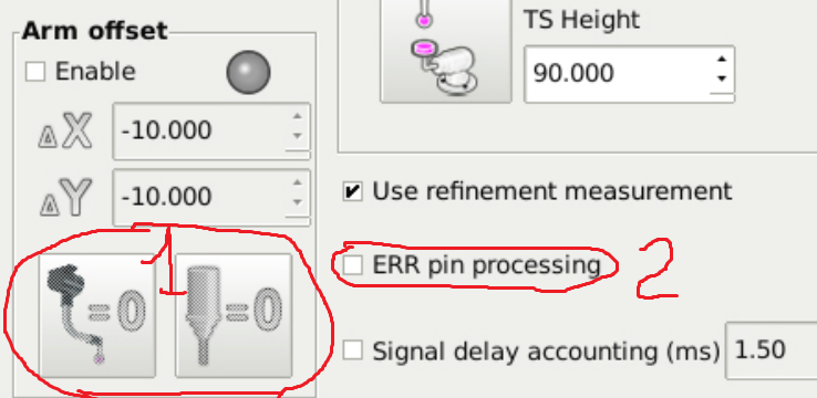

by Serg452
Replied by Serg452 on topic Work with probe
Another question. The remap enable button has disappeared. I use a tool in a cone BT40 and every time there is no need to measure. What should I do?
Last edit: 01 Jul 2023 15:34 by Serg452.
