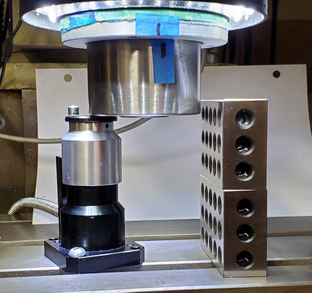

I asked myself that same question. From what I can see in the code, and it's been a few months since I looked, there is no stored reference for the tool touch off to be linked to. So it uses the work but that only needs to happen once per work cycle.
Say you install your raw material on the bed. Then touch off to it to determine the height of it. It knows this because it knows how long your probe is. This value is saved.
Next you call for a tool change. The code asks you to install the tool and then moves to the tool setter and probes the length of the tool and uses the tool setter height along with the earlier part touch off to determine where the tool tip is.
Now you can move to Z0 and the tool tip will be on the surface of the part ready for Z-1 for a 1mm deep cut.
The alternative, which I did, is measure the height to the milling table of the base of the spindle. I use TTS holders for the most part so my tools in the tool table are all referenced to that. The attached photo shows how I do this. The 1-2-3 blocks are used to measure the spindle based until they just slide under. At that point Z is set to 0 in the G54 co-ordinate system. And I know my mill table is 4" lower than that so I record that value. The G53 Z0 was set earlier with the homing command.
Next the tool setter is measured by moving the spindle down until it depresses and the system is notified that the internal switch closed. The math using 4" (z0) and Tool Setter trip point now gives me my tool setter height.
Now I have the two important values. The height of the tool setter relative to the table. The distance of the spindle base to the table at the G53 Z0 homed position determined from the 1-2-3 block calculation. From that I can now determine the length of the touch probe as it touches the table. That's stored in the tool table. The distance to the table from the spindle base at Z home is part of the touch off code.
What I haven't done to the code yet is tested if there is a non zero value in the tool table. If there's a non-zero value then the tool has already been measured on the tool height setter and that operation won't be needed. If the value is 0 then it measures the tool (like a drill bit in a Jacobs chuck) on the tool height setter.
Now the part still needs to be probed at least once but the tool setter isn't used every time. Each tool change just uses the tool table as normal.
I've not finished the code yet. Haven't used the mill for anything since I started playing with that and it was a few months ago. Hopefully I documented enough of what I did in the MillMockup.pdf I've attached.
