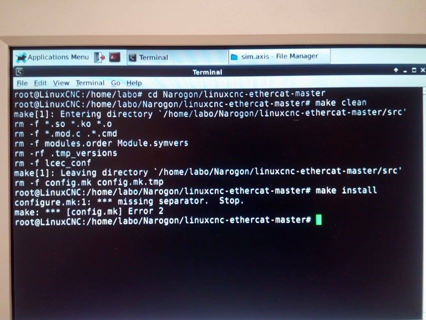

28 Jan 2016 17:55 - 28 Jan 2016 17:57 #69202 by Markux
Replied by Markux on topic Ethercat HAL driver
I dled your fork and I tried doing make and install, both resulted in:.
"configure.mk:1: ***missing separator. Stop." and an empty config.mk file.
Last edit: 28 Jan 2016 17:57 by Markux.
28 Jan 2016 17:58 - 28 Jan 2016 18:02 #69203 by narogon
Replied by narogon on topic Ethercat HAL driver
have you tried?
make clean
make install
I've not made any changes on configure.mk config ...
Only lcec_config.c, lcec_config.h, lcec.h and lcec_main.c
And lcec_el7041_1000.c
Last edit: 28 Jan 2016 18:02 by narogon.
28 Jan 2016 18:08 - 28 Jan 2016 18:09 #69204 by Markux
didnt before but I did now.
the directory where the master from sittner and your fork are, is not the same.
Am I going to have problems to keep on using whatever I had before? seeing he removed a bunch of stuff o.O
sry my linux machine is offline, this is why i posted the screenshot, i know it is more convenient posting the code, but...it wouldve taken a while :/
Last edit: 28 Jan 2016 18:09 by Markux.
28 Jan 2016 18:09 #69205 by narogon
it only removes the compiled files from the directory you are. Let me check again the fork
28 Jan 2016 18:35 - 28 Jan 2016 18:49 #69206 by narogon
Try to download it again. It has lot of mistakes :( :( from my modifications this morning.
I've just checked it.
Sorry for that.
Last edit: 28 Jan 2016 18:49 by narogon.
