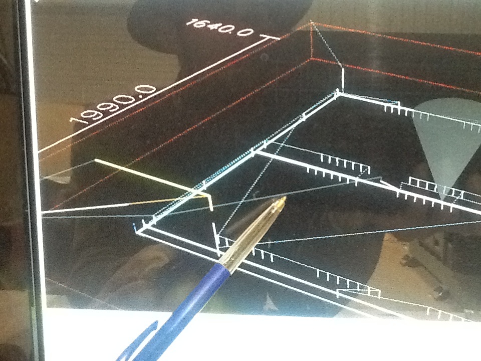

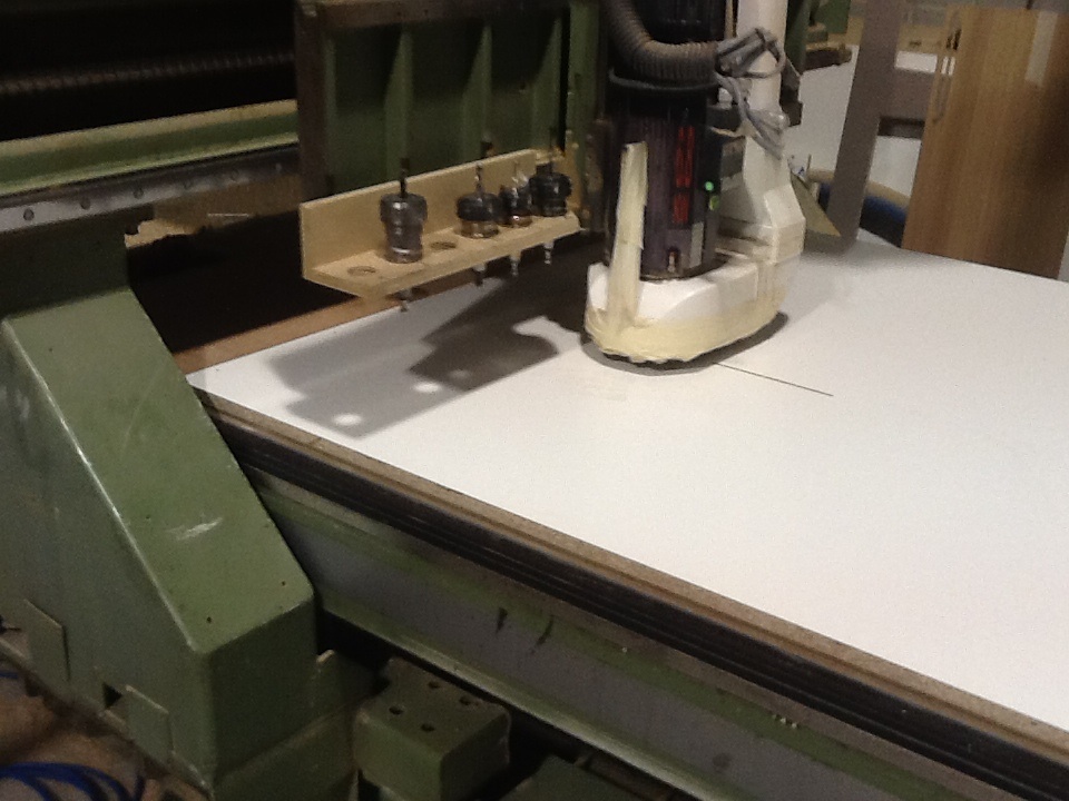

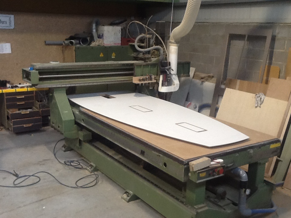

The machine is set with Bosch ac servo. Tacho to the drive encoder to linux. mesa 5i20 7i33 7i37
Yes the DRO is showing the moove, and the plot have record the moove.
Here some picture, the pencil show the move. The result is on the white melamine sheet.
My Gcode is strange :) i know.
I cut it in parts with a lot of underscore in case i need to start again at a tool change position.
And recently i have mix G61.1 with G64P to win some time during positioning move where i dont need any acuracy.

25 Oct 2014 04:07 #52377 by andypugh
Replied by andypugh on topic Gmoccapy - A new screen for linuxcnc
OK, that's a big, serious machine and runaways there have scope to be very bad.
What are your following-error limits? Do you trigger a following-error fault during these moves?
I am trying to work out if these are commanded moves being accurately followed, or something hardware / control-loop related.
(As an example, a wiring fault on a tachometer would send the drive running full-speed in a random move, but LinuxCNC would spot that the axis wasn't where it should be and shut-down when the F_ERROR limit was hit.)
Actually, that's another thing, do you get a following-error?
Can you take the tool out, move the Z to a safe height, and repeat with Halscope running?
25 Oct 2014 05:15 #52378 by papaours
Replied by papaours on topic Gmoccapy - A new screen for linuxcnc
I am not in front of the computer but this kind of move are bigger than what i have set! The gantry id quite heavy....
I am have use the machine a complete year under Axis with 2.5 and never get any problem.
The strange thing is Pusch PAUSE then STOP and here she jump.
Tow day ago it was worst, she completely Erase g54 XY offset on the middle of a cut and went out of 350mm
Hopefully i am not using any fixture
I tell you Halloween is coming and she want to kill me.
One idea will be to try with 2.6.3 and Axis Display if it happen again.
Next month i will start retrofiting a bigger one with 3.5m/s/s acceleration and 75m/mn XY speed...... I hope we found what going wrong around
Any way i dont think Ferror will save me because when i look at the Gcode on right screen the line where she jump was highlight. ( i have not sitch on Start frome here ) wihout stable MDI mode it is yo hazardous to Start on the middle of a moove without any G43 or M code.
Last thing, the crazy moove was perfectly executed, cordinated XY g61.1 then plunge g64 and cut.
A mechanical error could not be so perfect.......
It's a ghost !!!!!
