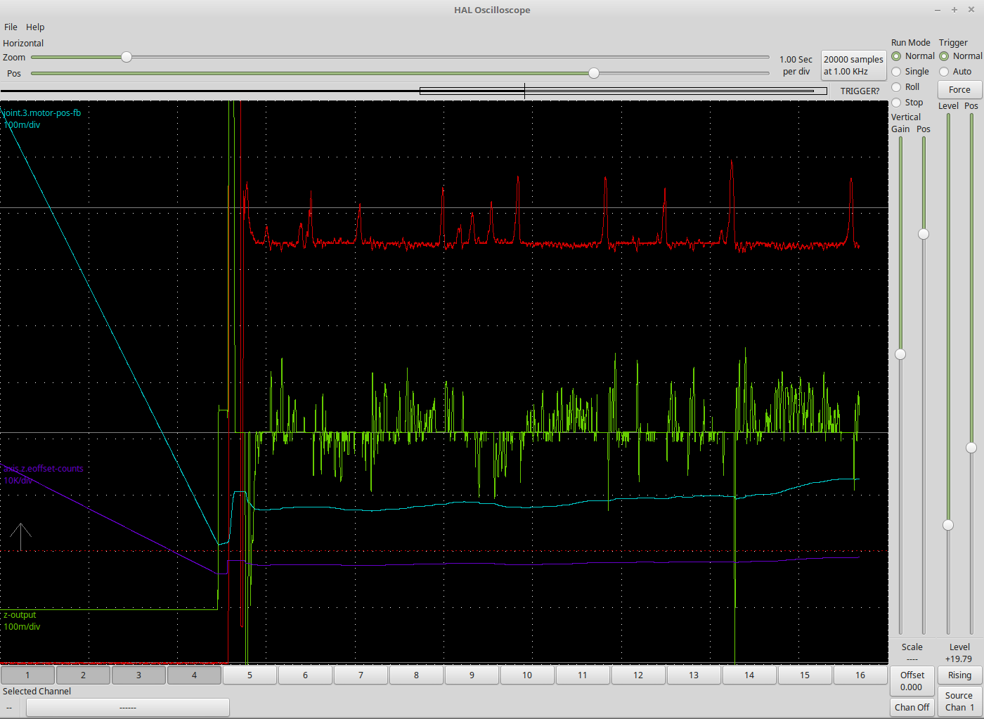

18 Apr 2019 02:58 #131099 by islander261
Replied by islander261 on topic Another plasma component...
Phill
I had always thought of automatic fallback to the float switch when it is activated first but the setting the retries solution should be workable as you usually know when you want to use the float switch VS ohmic.
I still had a large number of false shorted probing failures. Every time I checked with the test button the torch was clear. I must admit that with my Gmoccapy configuration I always probed very slowly down and 1/16 the probe speed up. I have my debounce set to 5 times so that may be why I didn't get many false alarms.
I run my table like a milling machine and not like some Mach 3 configuration from PS. I home the machine on startup to establish the machine coordinates. The machine Z zero is at the top (away from bed) of the Z motion. Then I place the material on the table and set the work piece zero by jogging the torch to the correct location (I have a couple of laser line generators to make a crude set of cross hairs). I then set the G54 X zero and Y zero offsets to that location. So at this point my machine knows where it is and the offsets to the work piece. When I probe the material I set the work piece Z zero to the top surface of the material using a G92 Z0 (one could also use a known offset). Then I start cutting. At the end of the Gcode file I always do a G92.1 to clear the G92 offsets. So when cutting my DRO always shows the height above the material the torch is. Oh, I do have a "permanent" G54 Z offset so that the work piece Z is the actual approximate height above the slats.
Here are a couple of videos that show the probing I described previously.
I also grabbed a halscope of part of the outside cut on one of the crabs. The big voltage spikes are the slowdowns for the sharp corners. Look at how nice and steady the voltage is in between. One thing I found when working out the corner lock on my system is that one needs to keep the height hold active until the speed gets back to 99% of the target speed. !00% always caused problems over being reliable. What happens is the arc voltage lags the torch speed a bit so if you restart THC at the same point you held the height the voltage is still way high and the torch dives.
For those that haven't done much of this it is a good plot of a real (non straight line) cut.
John
