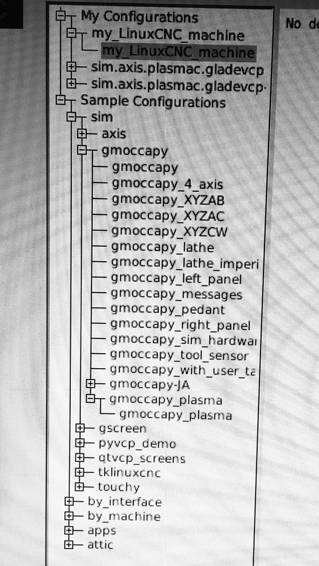

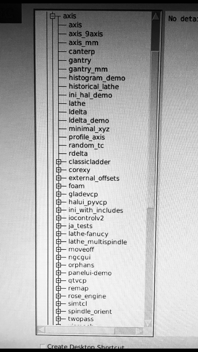

JT Knives, as mentioned earlier, the problem is (I think) that you built your plasmac config as the root user either becasue root was logged in or you used sudo when compiling. In this instance, that means you as the user does not have permissions that are required to run LinuxCNC. So it is finding the other config

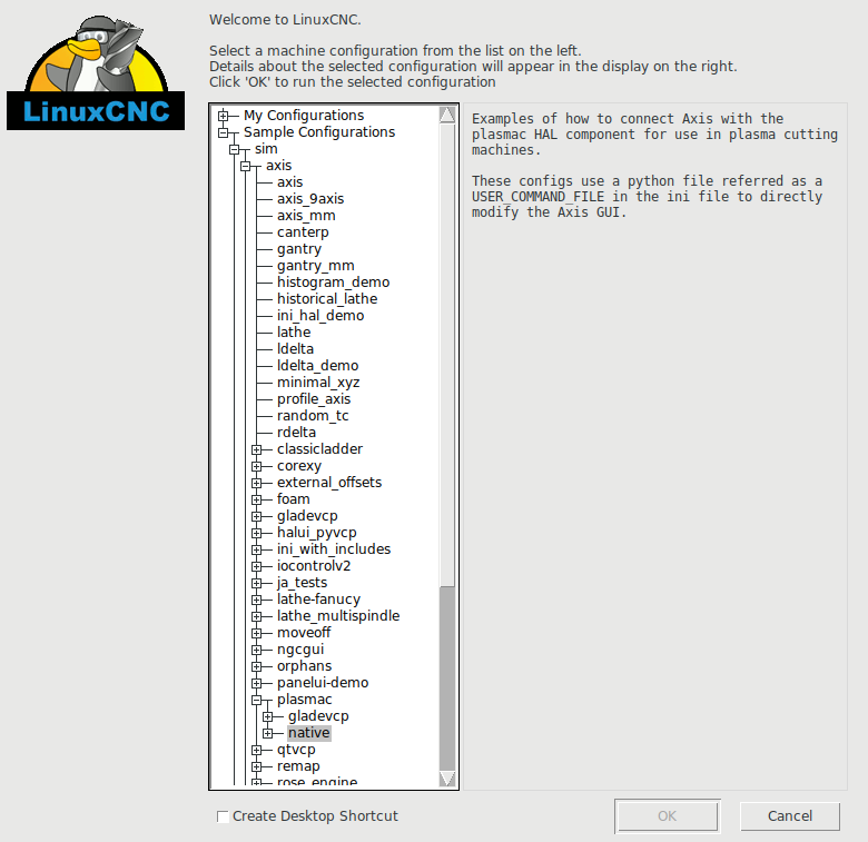

This should be:The one you cloned is my fork of linuxcnc so you would have master branch...
I just completed a brand new install and it does work...
Cheers, Phill.
JTknives wrote:
jtknives@plasma:~$ git clone github.com/phillc54/linuxcnc.git ~/plasmac
This should be:
git clone https://github.com/phillc54/linuxcnc-plasmac ~/plasmacI just completed a brand new install and it does work...
