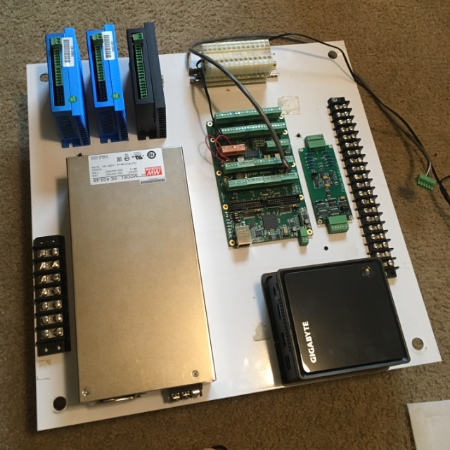

Thank you so much for all your help. i do have a working ini and hal file but it was just put together to connect to the 7i76ed and test my stepper motors. I have not connected the thcad or any of my limit switches yet. still muddling my way throught that.
