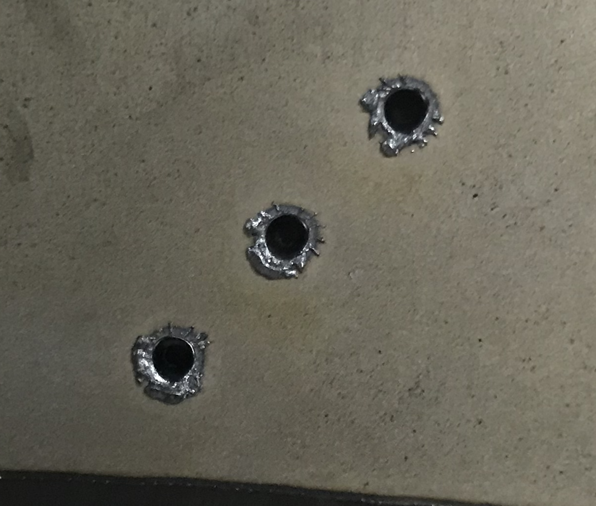

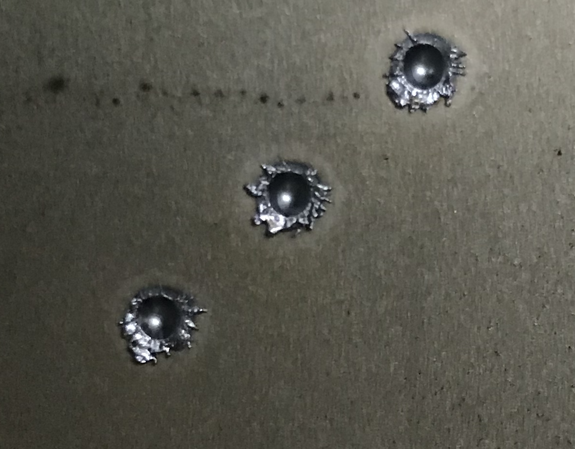

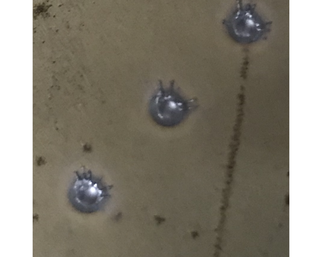

Success! Using Phill's experimental plasmac.comp (and remembering to rebuild LinuxCNC), my machine made 3 nice dimples in a row. I set the torch on time to 299. I think Phill said this would cause the torch to fire and then turn it off when it got an Arc OK signal. The really good news is I could make dimples with my usual fine cut consumables in cut mode. I did try using the marking/gouge mode but there was no difference (at least with my fine cut consumables).
The following pictures are of 18g CR steel, fine cut consumables, cutting mode. The dimples are at (0.25", 0.25"), (0.5",0.5"), and (0.75",0.75") to give you some idea of the size:
45a at a pierce height of 0.15" - it did not completely pierce the material but you can feel the dimple on the back side.
10a at pierce height of 0.15" - makes a nice dimple
10a at a pierce height of 0.25" - makes a nice dimple but more shallow. I did this as the Hypertherm cut charts for dimpling use this height.

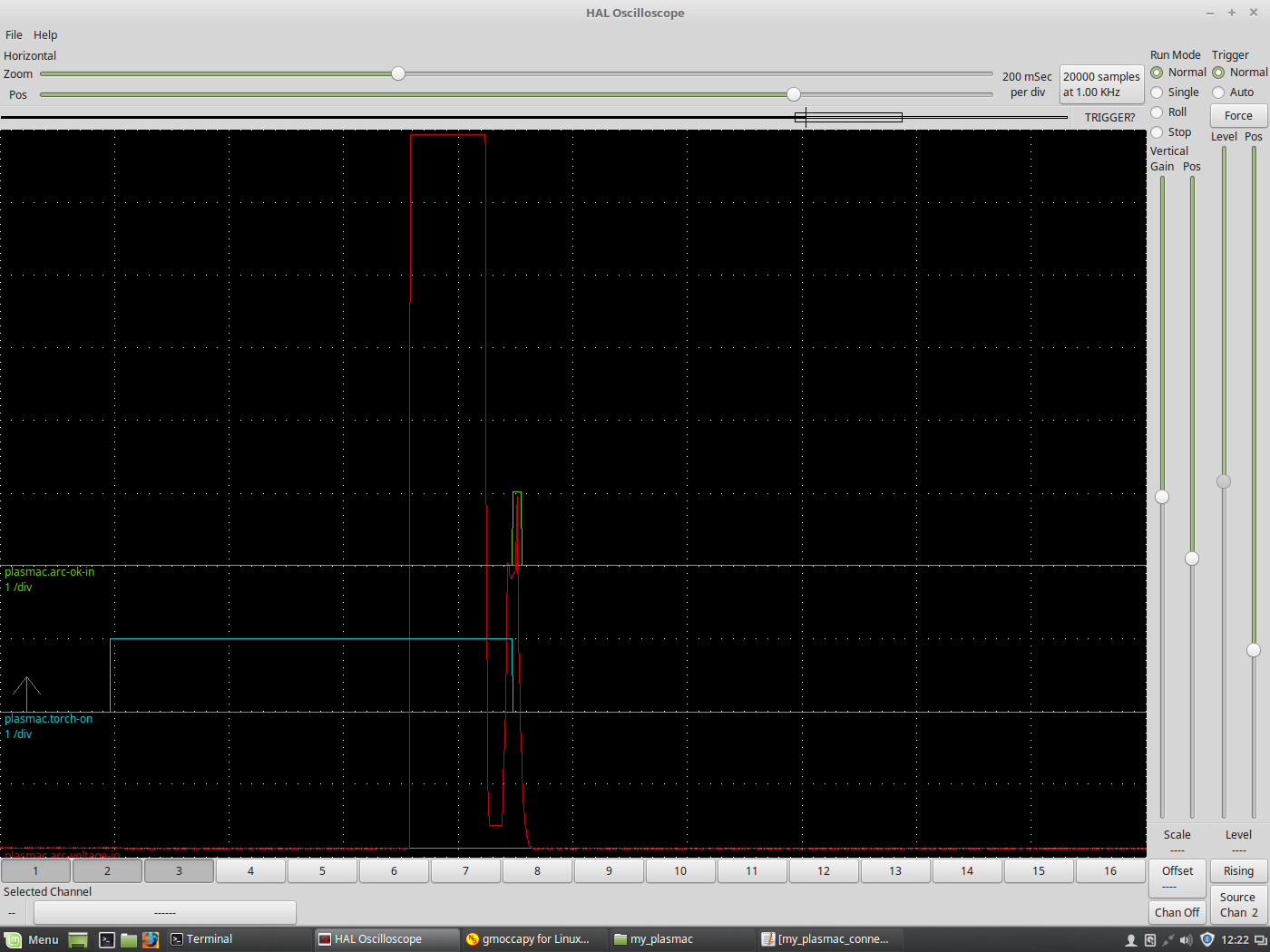

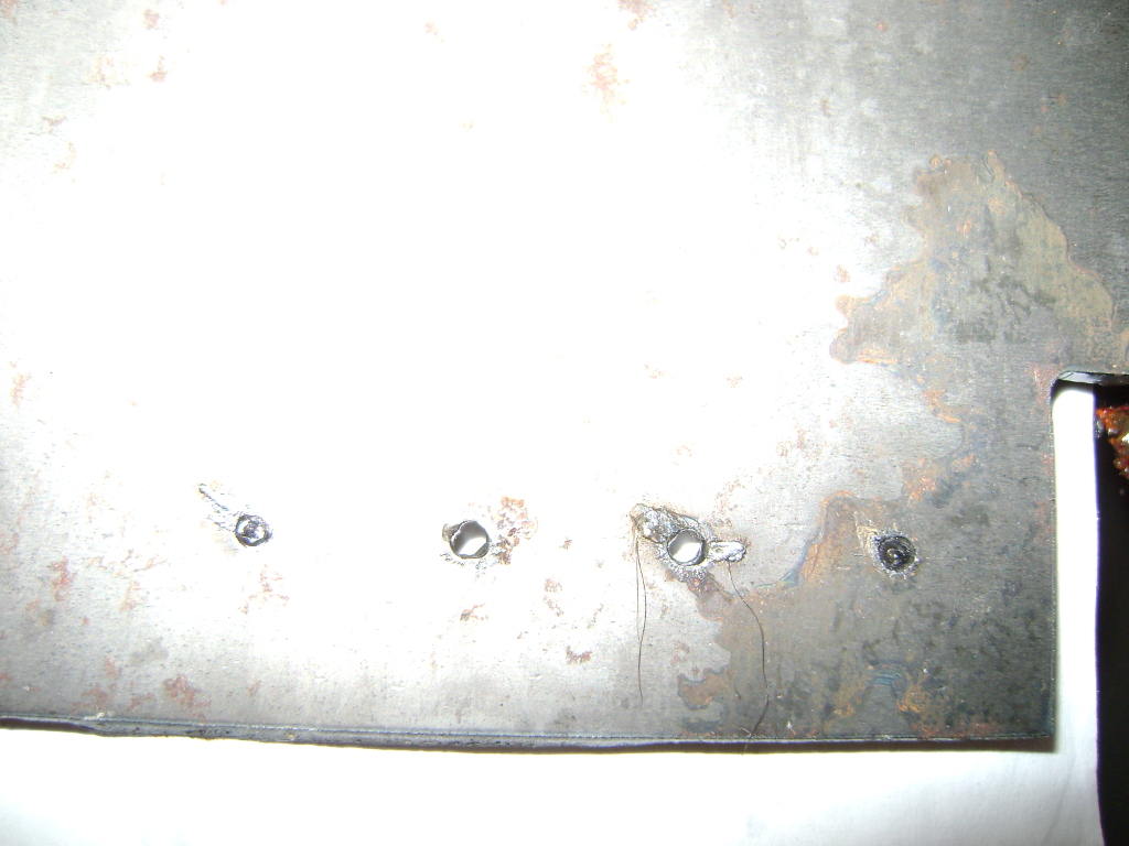

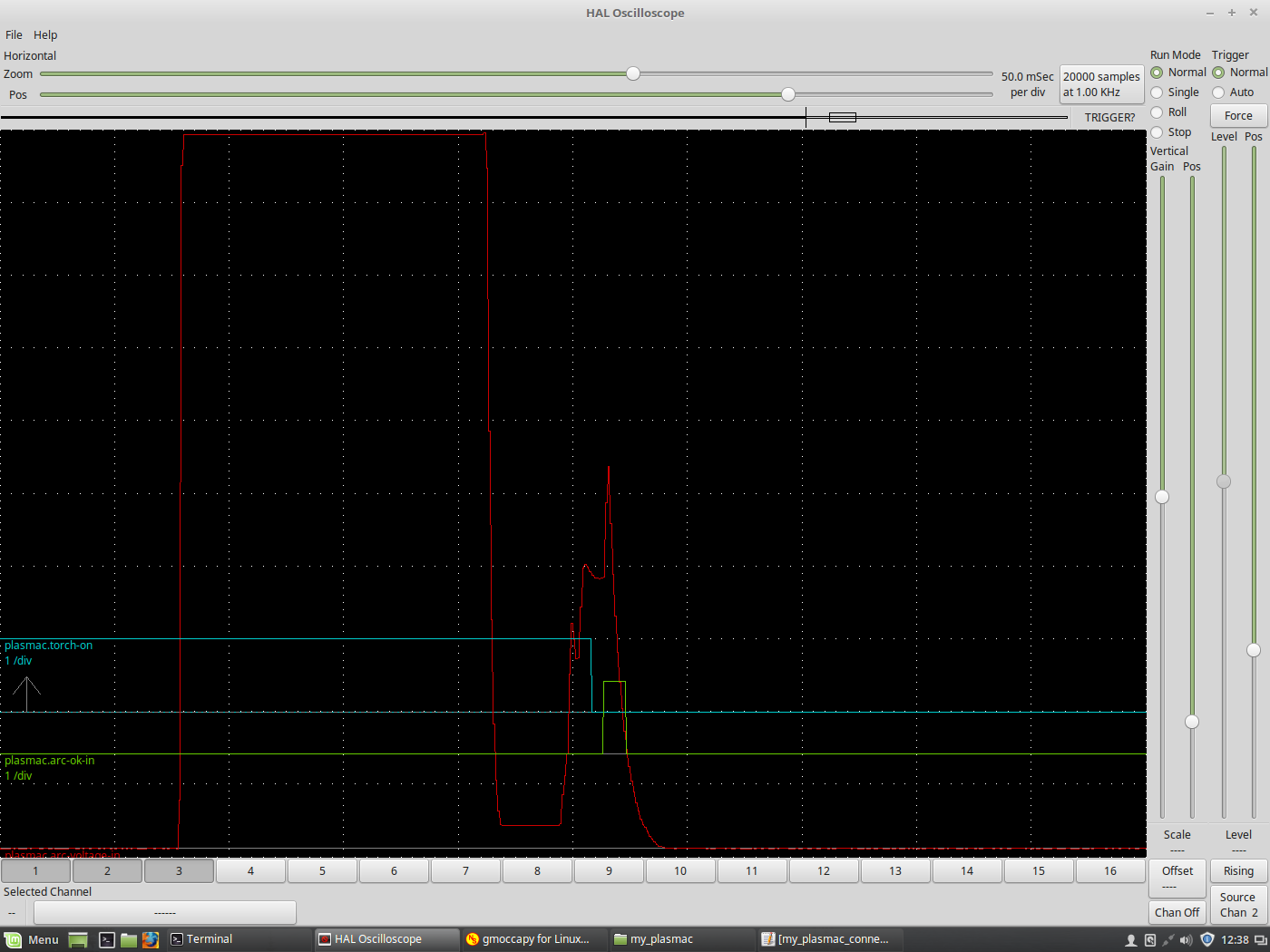

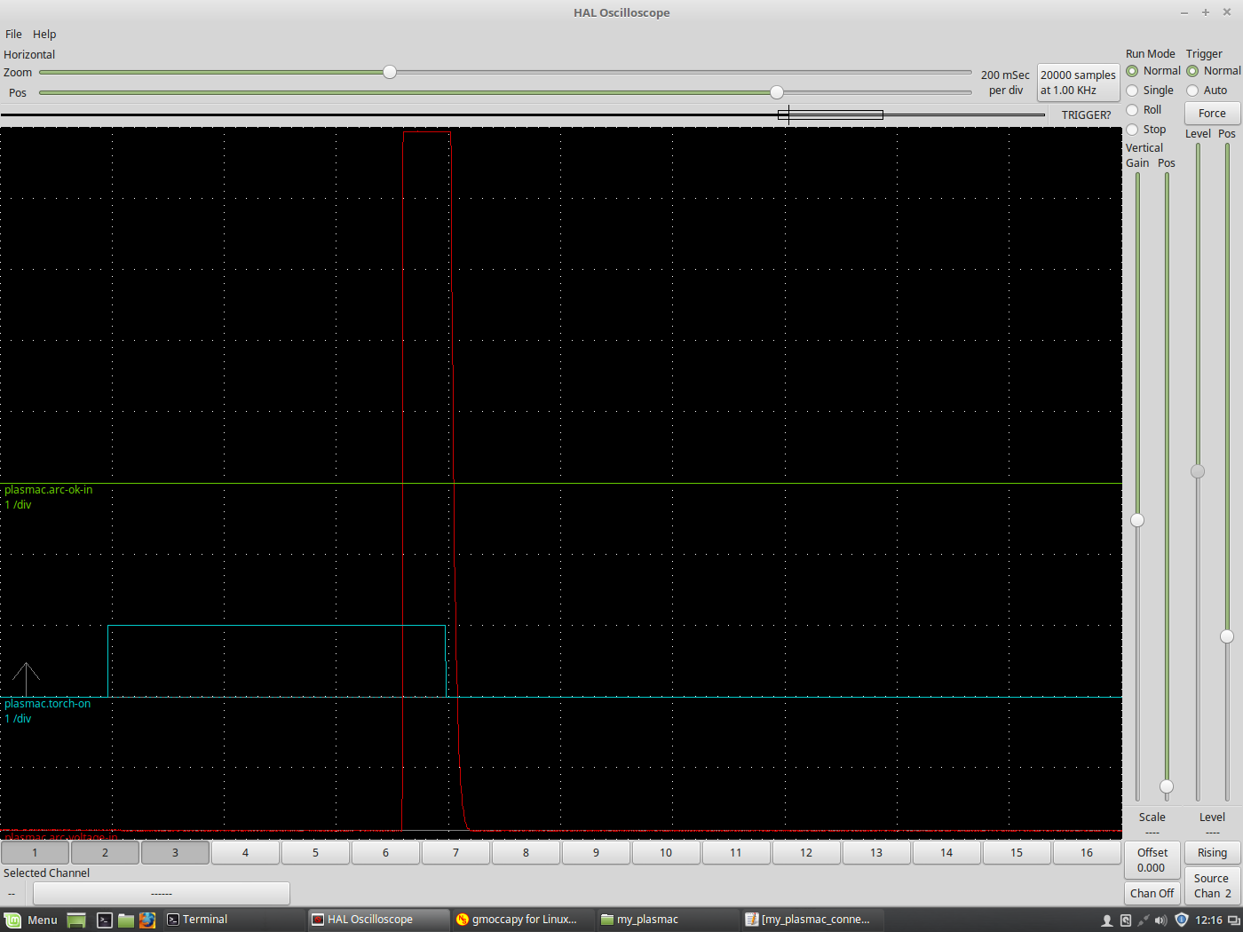

I did a few tests with my TD A-60 and did manage to make a couple of marks. The power supply was set to 45A and the torch height was .090", the correct height for piercing with the Finecut consumables used. I tested using the torch pulse function at pulse widths from .1s to .9s. The test material was 14ga (2mm) hot rolled steel. Sorry I haven't looked into using the center punch post or PlasmaC functions.
Some top level observations:
1. The power supply didn't produce any arc voltage until the plasmac.torch-on pulse width was .6s or greater.
2. The arc voltage starts to decay rapidly 7ms to 10ms after plasmac.torch-on goes low.
3. The power supply OK to Move signal (plasmac.arc-ok-in) is delayed from the apparent arc transfer by about 15ms.
4. At approximately 2.5ms of arc time past OK to Move (plasmac.arc-ok-in) going true the center punch mark produced an approximately .039" (1mm) deep mark. I had no way to finely control this time during the test so the next longest increment punched all the way through the material.
The pulse times from right to left are .7s, .8s, .9s and .7s. While in the photo it appears that both .7s dimples went all the way through the material I wasn't able to push a 30ga wire through either hole. When I examined the back side of the material it confirmed that the .7s pulses (about 2.5ms arc time after Ok to Move went true) did not penetrate the material completely.
I have attached Halscope screen shots for pulse times of .6s to .9s.
6_10... 1412-16-19.png is .6s pulse width
7_10...1412-22-48.png is .7s pulse width, far right dimple in photo
8_10...1412-26-50.png is .8s pulse width, second from right in photo
9_10...1412-30-10.png is .9s pulse width, second from left in photo
7_10-2...1412-38-32.png is .7s pulse width, far left in photo
The results for using a TD torch or using a HT power supply will be different.
John
Last edit: 14 Sep 2019 21:15 by islander261. Reason: clearifying attached screen shot origins
The following user(s) said Thank You: phillc54, thefabricator03

I am sure that without using external hardware (as Keith does) or fast arc voltage monitoring the path to success will be different for HT and TD power supplies. My TD A-60 requires a torch fire signal at least .7s long to get the torch to fire even briefly when using the torch fire button on Plasmac (maybe some knowledgeable TD engineer can weigh in on this) . The OK to Move signal is also very slow, I typically use zero pierce delay up to 10ga steel. I believe that stopping the arc is fairly quick once the torch fire signal is removed. This is sounding like it is time for a little halscope investigation.

John,
What is the first arc voltage pulse, is that HF start?
Rod,
The experimental component I posted will do that, for values over 300 the delay is (300 minus value)mS after Arc OK detected.
Edit: Or did you mean after any arc voltage is sensed?
Last edit: 15 Sep 2019 01:39 by phillc54.
15 Sep 2019 03:23 - 15 Sep 2019 03:25 #145196 by islander261
Replied by islander261 on topic Center Spot Sheetcam Post
Phill
We will need to find an ESAB or TD engineer for the real answer to that question. This power supply and torch are conventional blow back start the same as all the newer HT ones. I do know that the entire time that I have been using halscope to work on THC and corner hold problems my TD A-60 combined with my Franken torch the arc start has always looked like that. Maybe one of our deep pocketed friends with a HT power supply and torch can provide the group with some good arc start halscope plots for comparison.
I am thinking that an adjustable dead time and a rising voltage trip point should make for a good center punch divot. From my halscope plots I am seeing the OK to Move going true a short delay after the arc voltage reaches 40V. I have no way to know what the current set point is when the pilot arc is struck between the nozzle and the electrode, I do know that there is a good sized inductor in series with the output which will cause voltage to lead current in the circuit, the classic negative reactance like an arc lamp or welding machine once the arc starts. My current guess is that the arc voltage dip is when the arc actually transfers to the work piece and the rising voltage is when the constant current starts raising to the set point. Again my guess is that the OK to Move goes true when the arc current reaches the set point and the arc voltage is above some firmware set point. This is all a guess mind you, maybe a real plasma cutter engineer will speak up here.
John

John,
Thanks, that certainly is an interesting waveform and not one that I expected. I also didn't expect that much delay from the torch on signal until the arc voltage rise. It makes doing things with timing a bit hit and miss. It would definitely be interesting to see plots from other machines with the same conditions.
