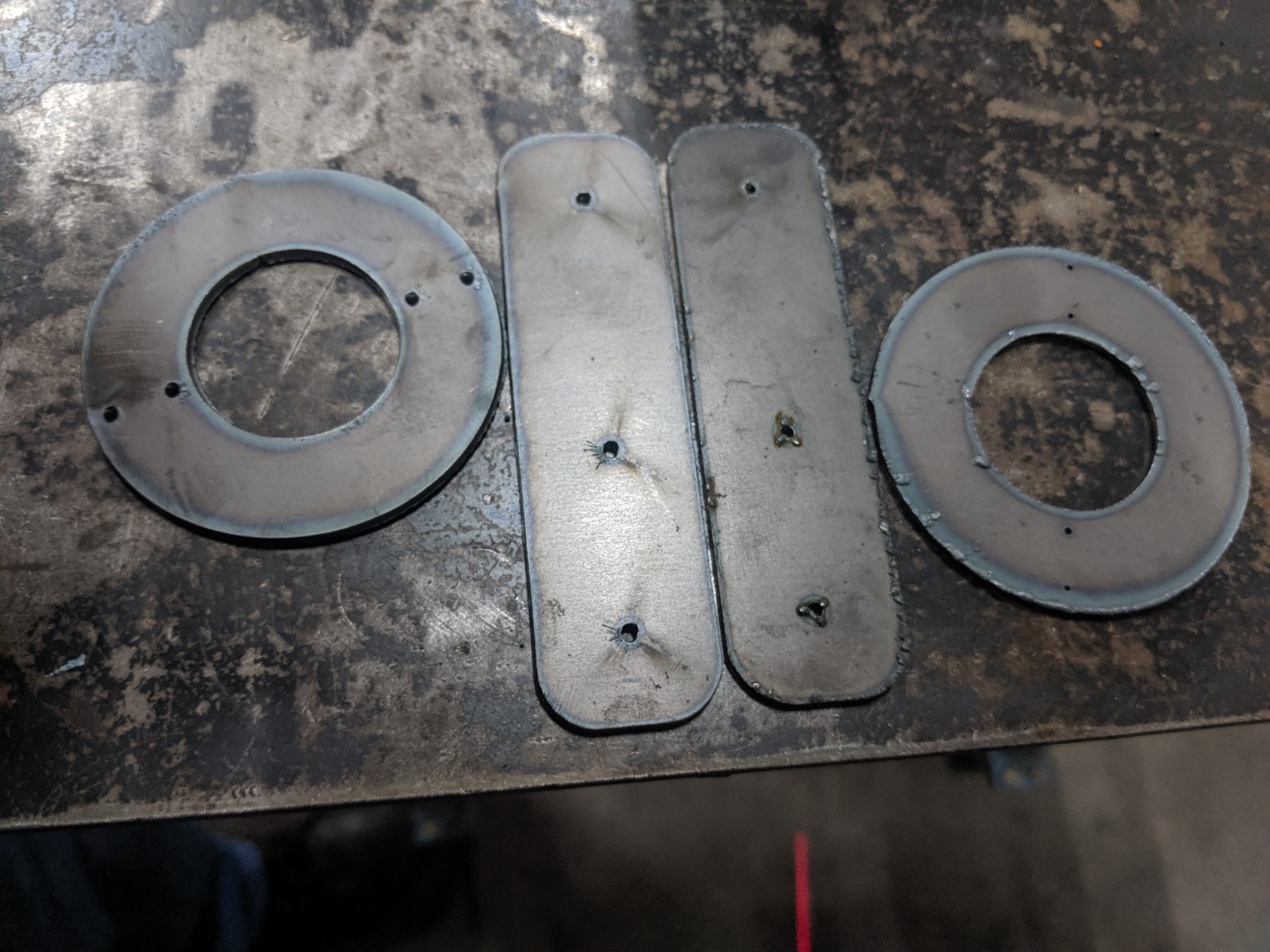

12 Sep 2019 08:32 #144943
Replied by rodw on topic Center Spot Sheetcam Post
Well, I thought I'd post this pic which shows front and back of the donuts with the spotting function and front and backs of a part spotted with my normal wait until ArcOk method. Front sides are on the left.
The holes are much more evenly shaped (eg more circular).
When thinking about it, simply turning on torch for a fixed period is too simplistic because some relays in use will be very slow. I think some opto isolated relays have a 600 ms on delay. So the delay needs to commence from when the arc has been sensed by the THCAD. Therefore, this feature can't be used by Promas etc and will require a THCAD.
It might be able to be offloaded to my ohmic sensing component if you wanted to keep Plasmac more generic
