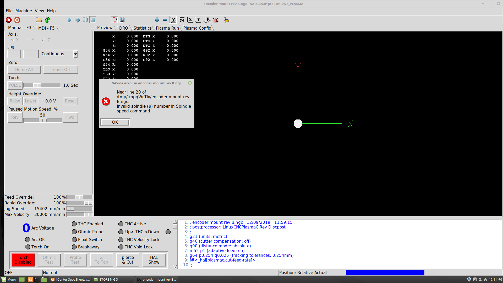

Replied by phillc54 on topic Center Spot Sheetcam Post
You may need to run the Configurator in upgrade mode.
- thefabricator03
- Visitor
12 Sep 2019 02:11 #144873
by thefabricator03
Replied by thefabricator03 on topic Center Spot Sheetcam Post
Same thing after running configurator,

- phillc54
- Posts: 5711
- Thank you received: 2100
12 Sep 2019 02:29 #144879
by phillc54
Should be a SPINDLES = 3 in your .ini file I think in [TRAJ] section
- phillc54
- Posts: 5711

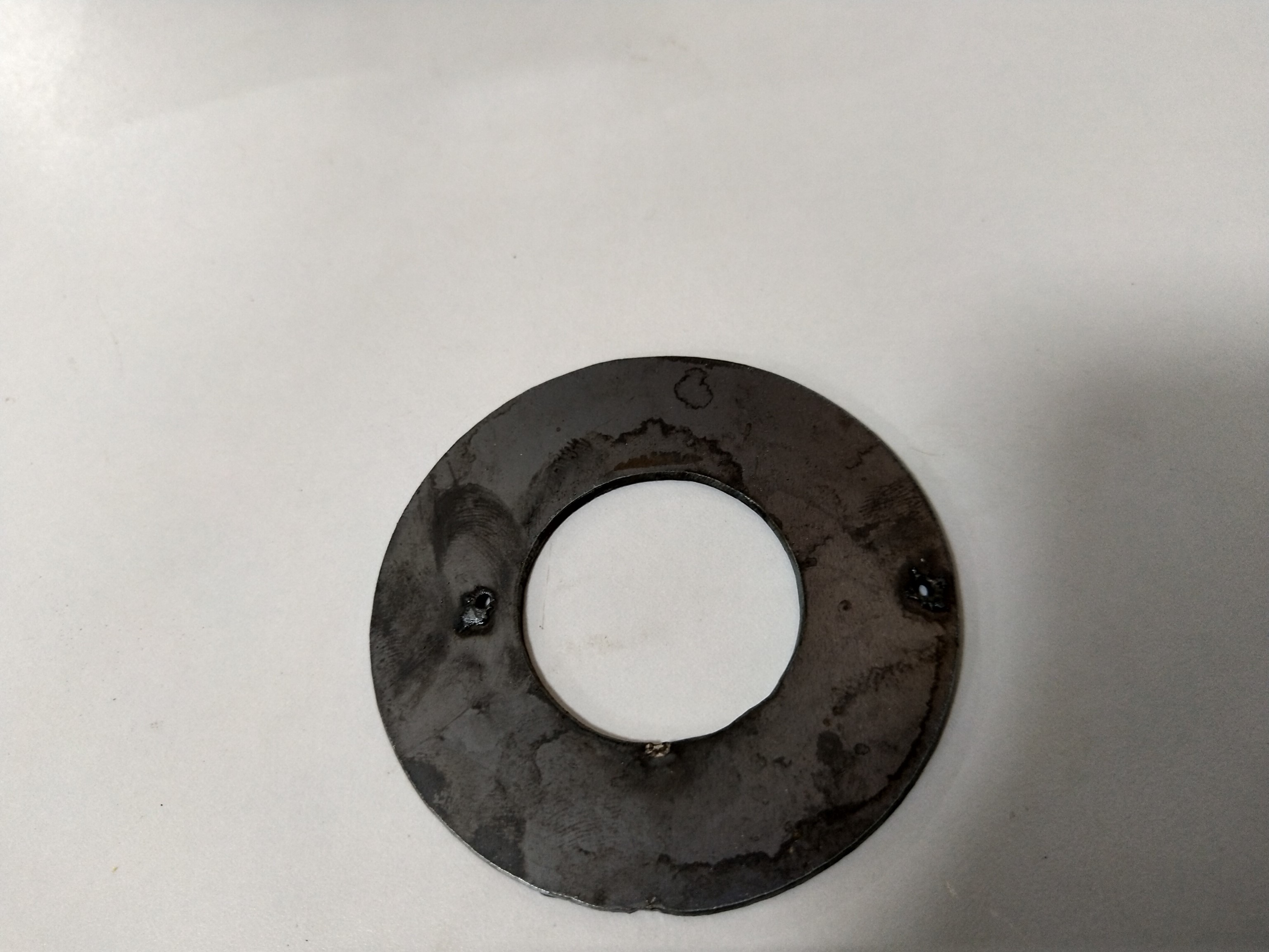

- thefabricator03
- Visitor
12 Sep 2019 03:51 #144890
by thefabricator03
Changes the spindles to 3 and now it kinda works,
Now I think its a plasma cutter related issue but I am not 100% sure how we will resolve it.
I ran the part out and it only spots two of the four holes. Now PlasmaC is trying to spot the other two holes but the plasma cutter is not reacting quick enough. Maybe we need a delay of some sort,
- phillc54
- Posts: 5711
12 Sep 2019 03:57 #144892
by phillc54
One thing I noticed, shouldn't the cut direction be opposite.
The only delay is the Torch On Time but by the look of the holes it is on too long.

- thefabricator03
- Visitor
12 Sep 2019 04:04 #144895
by thefabricator03
I dont know about the cut direction, I have not selected reverse cut in sheetcam, and yeah I had the delay set for longer than needed for the first test.
- thefabricator03
- Visitor
12 Sep 2019 04:07 #144896
by thefabricator03
When PlasmaC is trying to turn on the torch, Its like the torch does not respond. I tried to turn down the motion speed to give the torch more time to respond but that did not help.
