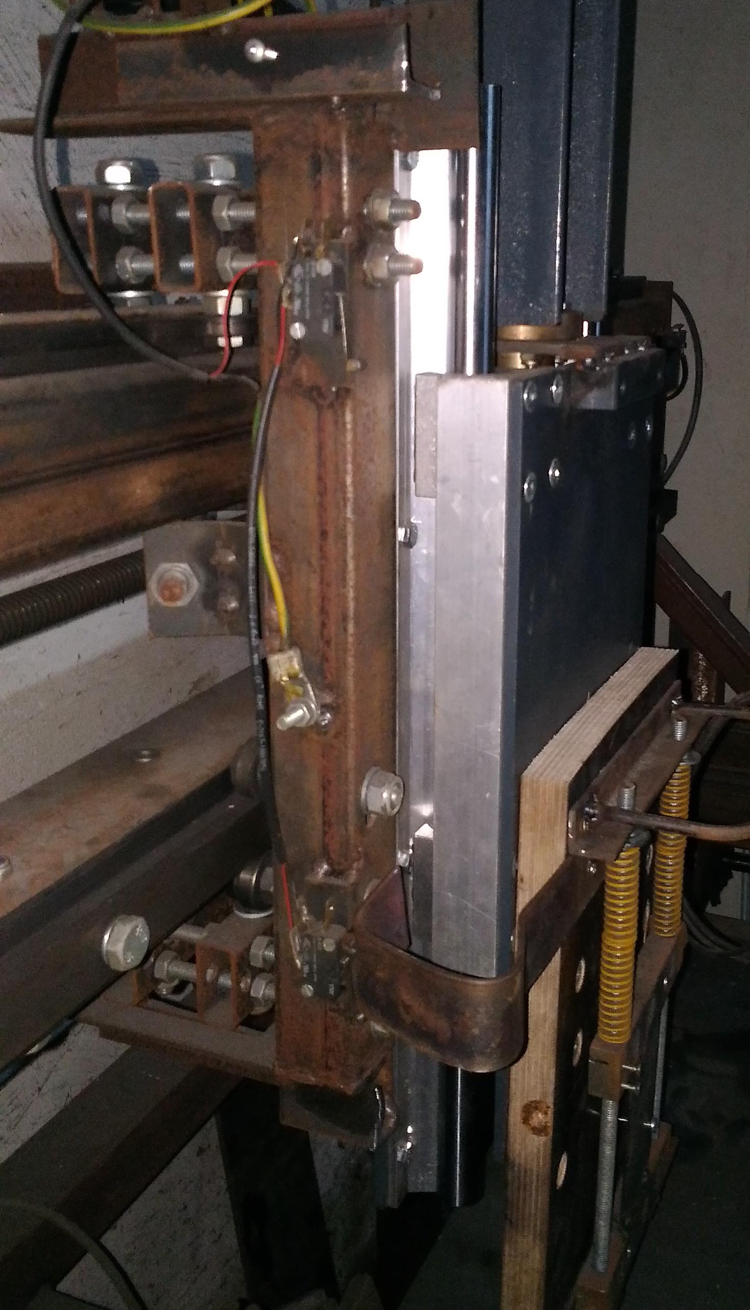

I think you would be better off with the home switch near the top of the axis rather than the bottom. When homed you want to be just below the top. If the home switch is at the bottom then the torch could hit the slats before reaching the home switch.

If you have limit switches, you can uses shared home/limit switches so it would be worth doing in my view. Be sure the home offset moves the axis off the limit switch though.

I will resume my issue, maybe my explanations haven't been clear.
The machine worked with Linuxcnc 2.7 for over 4 years but without THC.
Now I have installed debian with 2.8 and the THC150. Stepconf doesn't configure correctly the two motors on the Y axle. I have done the modifications in the ini and hal as explained by RODW and TOMMYLIGHT in the forum.
I have attached a picture of the limit switches of the Z Axis. The torch is mounted floating with the springs and has a separate limit switch.
My issue is that the Z Axis does not react while activating the limit switch during homing prcedure. What result in a crash in the table. I prefer the crash in the table then crashing in the other direction as this could damage my Z axis.
With the linuxcnc 2.7 I removed the torch for homing ( I have too otherwise it crashed), the lower limit switch was hit during homing twice and the machine moved up again on the defined position.
The INI
