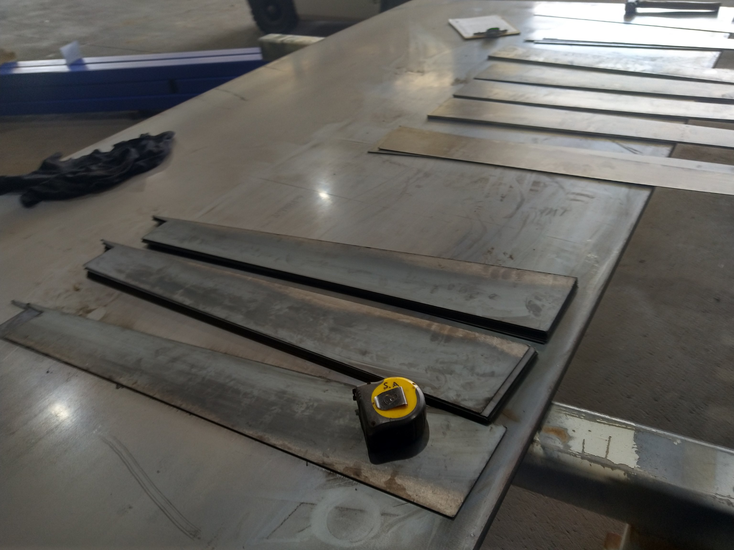

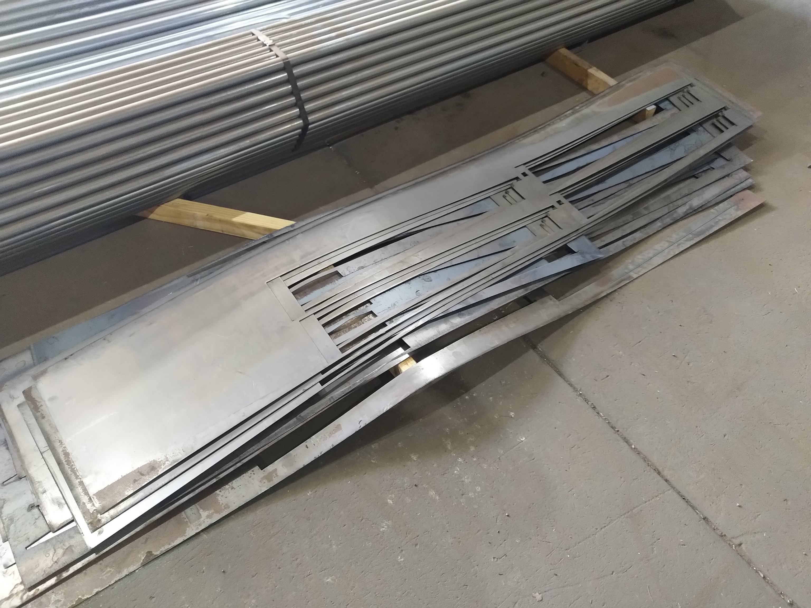

I did a fair bit of 1.6mm cutting the other day and had a bit of trouble with the probing,
This is a small portion of the stockpile I have of 1.6mm sheet. We had a few big jobs over the last couple of years that we could not use the full amount of the full sheet so I have two large pallets of offcuts,

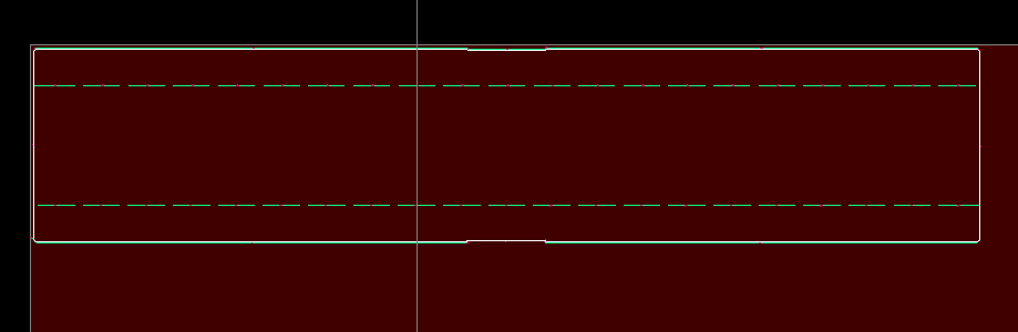

I've been working with Sheetcam trying to do stuff I've not tried before. I've been playing with using tabs along fold lines becasue I don't have a press brake. I'll probably only do this for prototypes and get production parts folded outside. But here is what I have so far.on a simple folded channel.
So if anybody can offer guidance on how to fold the perforated part and how long the cuts vs the tabs should be on 2mm steel, please let me know..
And what I am planning to make. A 1200mm long channel. I'm hoping its good enough to handle a 100 kg load with the brace in the middle.
To do this, you need to make your DXF files with the fold lines in it and then move the fold lines to a new layer in Sheetcam.
Create a separate operation for this layer with no offset and then on the Cut Path tab for that operation, there is a holding tabs button.
The trick in there is to click on the "place tabs" button to actually create the perforated line or nothing happens.
I've also had a play with the remnant offcut option to and that looks handy as well.
So it looks like before I do this, I need to get some material, make my slide out material rest, refill my water tray, test Phill's new probing routine and maybe even have a play with the void crossing stuff I did ages ago as with remmant cutting and sheet severing, that would be useful so I can cut right off the sheet.
Its probably worth mentioning that with remnant cutting to sever a sheet, Sheetcam starts in the centre of the sheet and makes two cuts, one to each edge from that point. Maybe its something Phill could consider changing his sever routine to do. (really neads void sensing to work well!)
