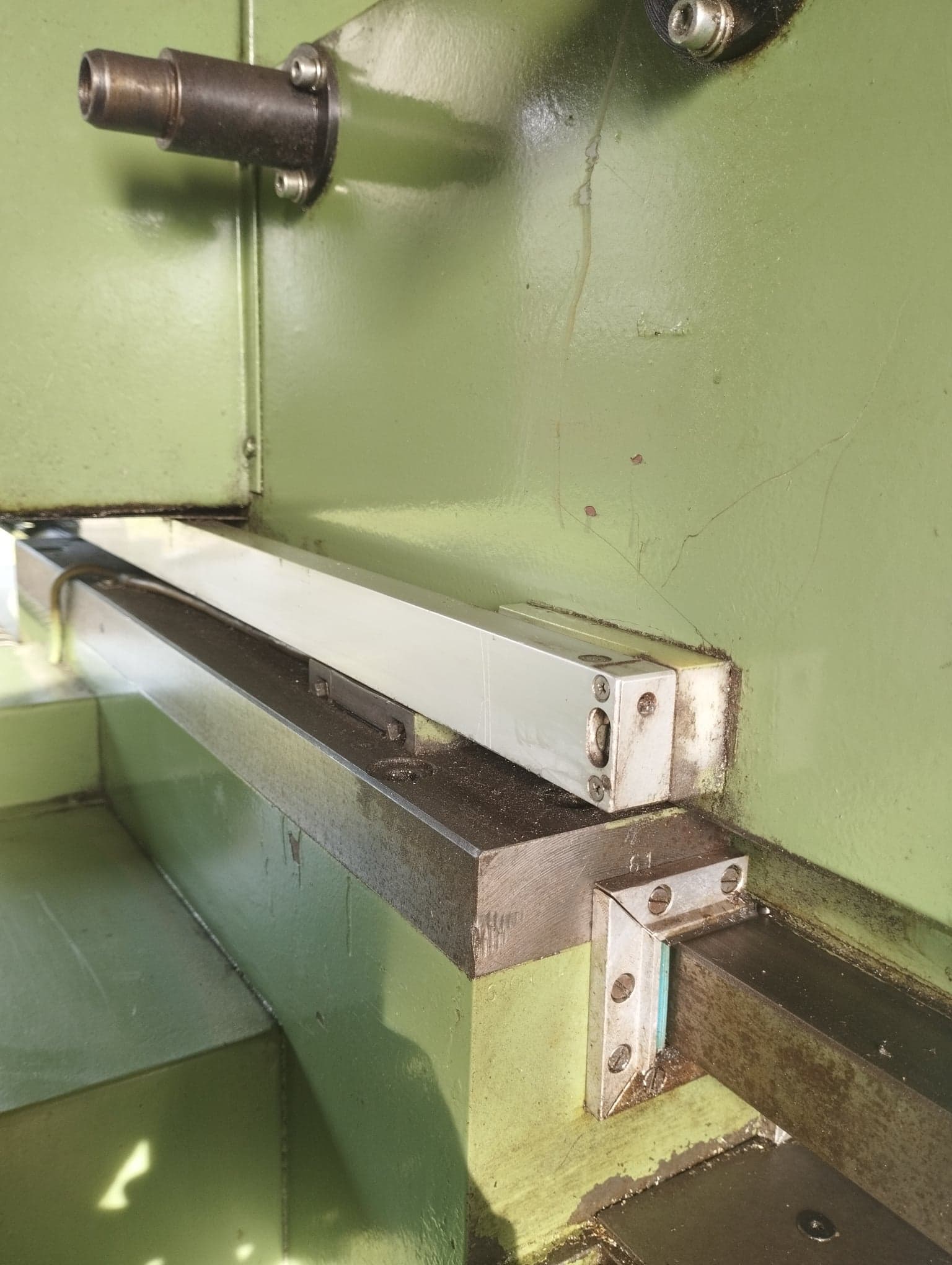

12 Jul 2022 11:55 #247164
by Kevin_Pawlus
Replied by Kevin_Pawlus on topic Retrofitting a TOS FNG 32 NC
Alrigt, I have ordered 1 pice 7i77 and 7i94 and it should be here on thursday.
I have photographed the drawings and will upload them on drive when I get Wifi again.
I've started to see if I can find everything on the machine. So far I have identified all of the 0-10v motor control cables and linear sensors.
Have I understand it correct that there is one enable signal to the motor and +10v means full speed one direction and -10v full speed the other direction?
I have not seen any model number or anything on my linear sensors, I'm not sure how they work and how to plug them in the Mesa board.
- Posts: 22036
- Thank you received: 7504
12 Jul 2022 12:04 #247166
Yes.
The enable is usually a pin that has to be tied to ground/common to enable the drives, not always.
That and more should be in the schematics, avoids making assumptions.
Replied by tommylight on topic Retrofitting a TOS FNG 32 NC
Yes.
