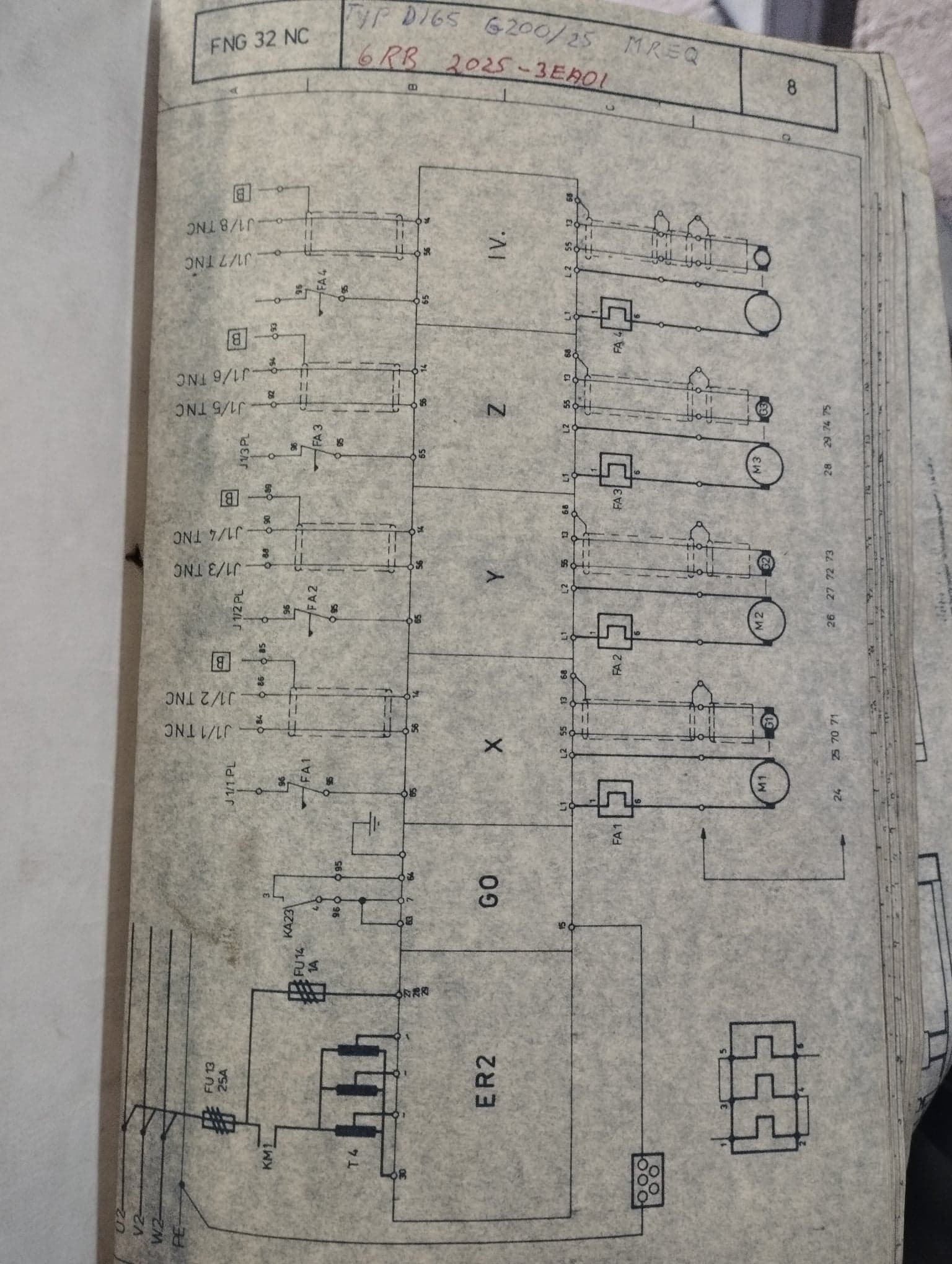

The siemens 6rb drives generally have more than one enable.
IIRC....pulse enable, regulator anable and axis enable.
i have had problems when trying yo enable all of them at the same time.
On my last retrofit, i enable the pulse and regulator together, when estop is released, and axis when the machine is switched on.

- Henk
- Posts: 408
- Thank you received: 92
12 Jul 2022 14:04 #247173
by Henk
Replied by Henk on topic Retrofitting a TOS FNG 32 NC
ER2 is the power supply sectiom of thw drive. It consists of a rectifier and a cap that rectifies the 165vac 3 phase from the transformer shown. Terminal 27 28 and 29 get 3 phase line voltage and powers the electronics.
G0 is another card in the drive. It contains the pulse and regulator enable signals. Pin 7 here is 24v dc to be used to enable the drive as shown on pins 63 (permanently enabled) and 64 through the relay contacts.
each axis, in your case 4 of them has its own speed control card. For each of them, pin 65 is the enable for that axis. This enable power should also come from pin 7 on the G0 card.
G1 ....G3 are dc tachogenerators mounted on the motors. They provide velocity feedback to the drive. Take note of the polariry of the motor supply wires and the tacho wires and dont mix them up or swap the polarity. It will cause the motor to run away and can damage the power transistors. These tacho signals stay as is and will not be connected to anything else.
the linear scale signals must go to the mesa 7i77. You need to check what type of signal is coming from the scales. You may need interpolators to convert from sin/cos to 5v ttl. Check the diagrams for something labled EXE...

Thanks for the reply
I meant nr 65, not nr85 before. Okay, so I take the voltage from pin 7 and connect it through a relay and then on to nr65 and when the relay is on the motor is enabeld?
After I have enable the whole drive with KA23.
The linear scales are Hedenhain LS403.
There is some electrical info on page 20 here but Im still unsure what signal.
siebert-automation.com/wp-content/upload...ing-Instructions.pdf

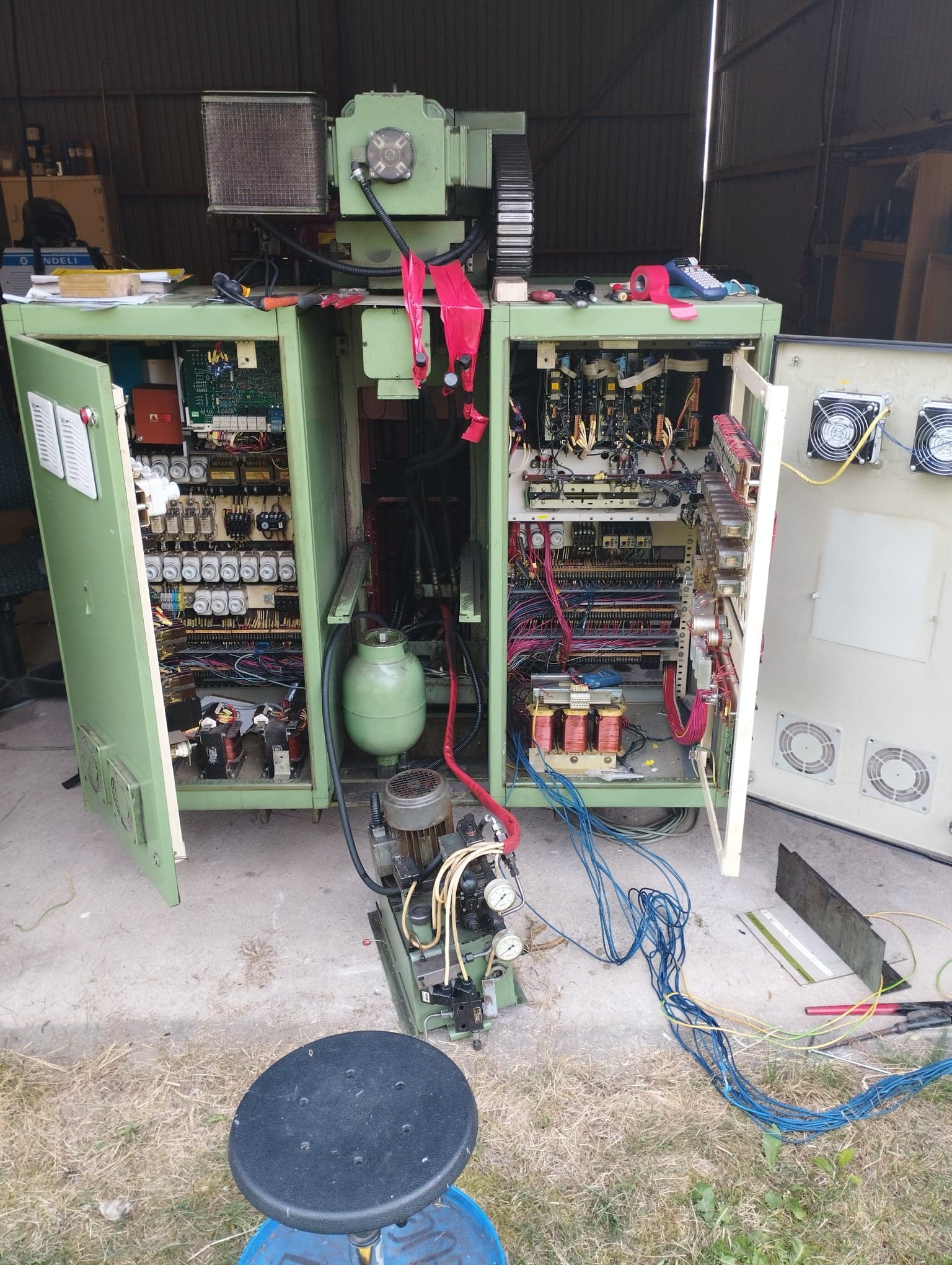

14 Jul 2022 14:50 #247317
by Kevin_Pawlus
Replied by Kevin_Pawlus on topic Retrofitting a TOS FNG 32 NC
I recieved the Mesa boards yesterday (wednesday) and I ordered monday. Very fast!
I have started removing parts of the old control system and labeling cables. I also 3-D printed an holder for the cards EXE boxes are also on the way.
I'v read the manual of the card and I don't really understand what can of signal the board outputs. I will power the field with 24VDC. Is the enable output for each motor +24VDC when high? And can it be used to power a relay. The existing enable circuit goes through a relay, so if I activate the relay I have the motor enabled. I hope to use the existing circuit.
