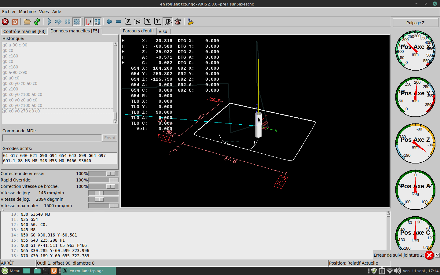

Can you post your GCode?
[edit]
Oh, one other imortant thing concerning limits:
LinuxCNC does only check axis values against limit values. It does not check joints. So this means that if your coordinate system is tilted or rotated by A or C when using non-trivial kinemtics, those limits are not aligned with your actual joints anymore and have not really any meaning.
So maybe you are not really exceeding your physical limits. This is really where we get to the limits of the current state of linuxCNC.
So if you have limit switches on both ends of the axis you could try to disable the limits in the INI.

So I deactivated all the limes of each of the axes
Ok put those lines back in.
I don't know how much experience you have with 5axis cnc machines. Maybe you know what you are doing but
I really think you're wanting to much to quickly. 5axis simultaneous is really a lot more complex than 3axis.
So stop running this gcode for now and focus on getting to know the 5 axis kinematics.
You need to start with small stuff like following the point of a pencil stuck to the table or something.
What I suggested was to set the tilting and rotating tables at 0° then touch off at the center/top of your rotating table.

the program I have attached to you is simply chamfers on a rectangular piece (milling while rolling) not much simpler.
to overcome the problems of limits, I programmed a very small pocket.
no more limit problem. on the other hand always problems of joinutres.
I have noticed that the accelerations of the axes are too fast. apparently the limits given in the .ini file are not respected as for a "trivkins" configuration.
Are there no other joint parameters to perform?
Thank you for all the advice, I'm studying all the docs you send me. I'm sure I'm not too far off the mark, but like you say, I still have a lot to learn.

Hello,
I managed to move all my axes simply with a "mid" command on the G1 A 20 F50 axis. I considerably reduce the feed speeds. No more joining or limit problems. On the other hand, the axes do not follow the pivot point and go in all directions.
My configuration defined the "C" axis in 4th join.
If I understand correctly the linuxcnc doc the "C" axis would correspond to the 5th join ..
is it correct ?
I tried, it doesn't work, but, do I have to change something else in the configuration files ?
thank you

You need to keep the joint numbering in order. Maybe compare with the simulation config:

- JackRay
- Posts: 226
- Thank you received: 14
concerning the configuration of the .ini file it's ok for me. I think my Problem comes from an error or an oversight in my .hal file
Thank you
- Posts: 4819
- Thank you received: 2177
But really you should be able to figure out what is wrong by just setting A at 45° and C at 0° and jog your axis in x, where it should be just moving the x motor, and in y, where it should move motors y and z at the same speed.
