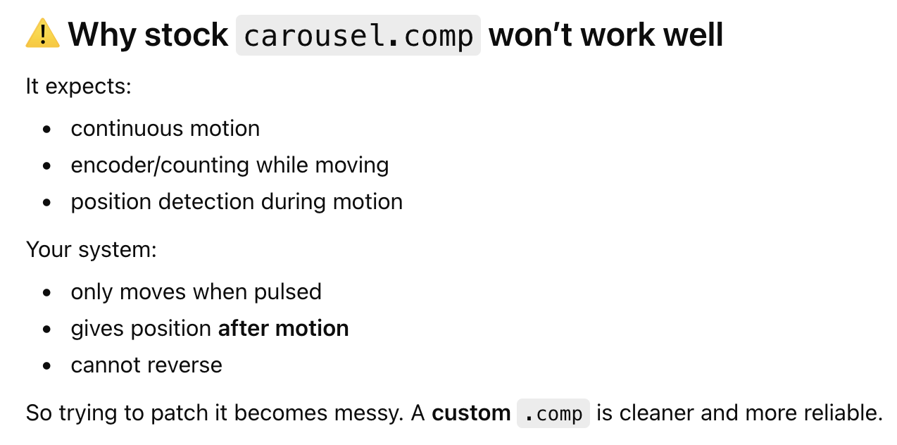

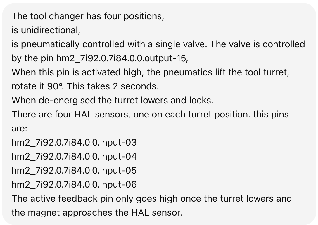

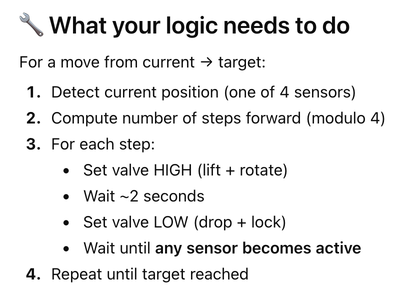

I was trying to work out how to address not having any feedback on the turret arriving in position. Because I am a shit programmer, I tried Chat GPT yesterday.
This is the set of requirements I gave:
The AI summary is rather accurate.
After a couple of back and forth, adding requirements, and accepting some AI suggestions, the result is the attached files.
Scary good how fast and efficient this is for a small project with very limited requirements, and how well it documents and explains the code. It would have taken me a few evening to get to this level, and my code would have been a mess of half-arsed work-around to avoid the gaping holes in my programming knowledge.
It failed to compile yesterday, due to some unknown character. I suspect the apple text editor has added some hidden ascii code. The attached files I cut paste into a different text editor. Off to test them now.
