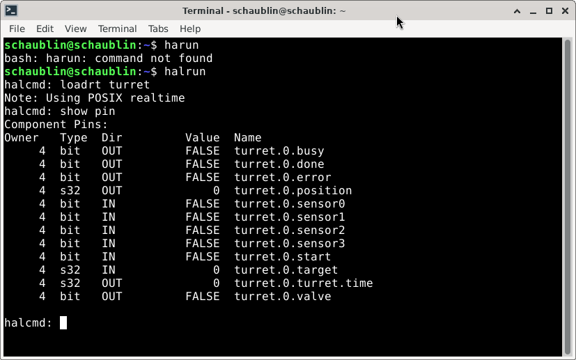

You still have the:
.turret.hal:1: Unknown command ''
error, there is something on the first line of that file causing the error.
Try running it through a dos/win to Linux script, might be some strange character there.

I tried a few different ways to identify and remove strange characters, and even completely rewrote the code by hand into visual code studio. It compiles without error and runs without error in Halrun, but only fails as part of a full linuxcnc start.

Are looking at the right file? The error is in 'turret.hal' (ie the hal file) NOT 'turret.comp' (the component)

Oh. Doh!!!!!
Thanks a lot. I was so focused on the comp, I missed the obvious.
