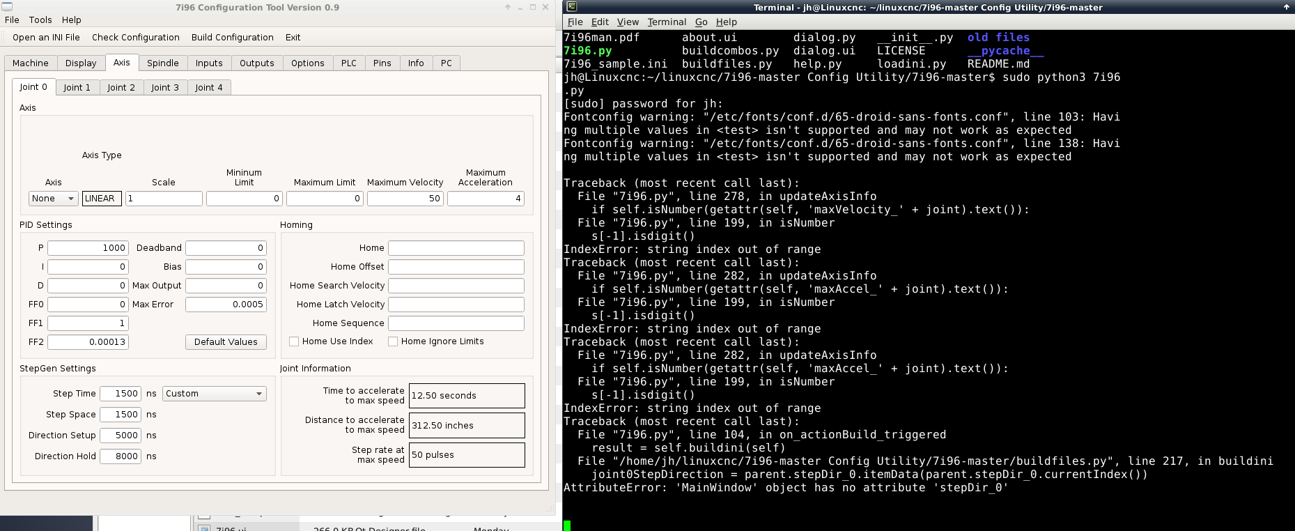

I have been experimenting with the tool some more, this time I am filling in actual numbers from a working ini and hal that I created manually. For the sake of speed I only populated the Joint 0, X axis fields.
I can set all of my parameters in all tabs and the tool will build an empty directory every time. If I change joint 0, "Axis" from X to None, it will write the files albeit they are missing the Joint 0 information. I have not found another setting that affects the file builder.
I launched the conf tool from the Linux CLI to see if I could get anything else to happen. The output is in the attached screenshot. Behavior was the same, it would build files if I changed Joint 0 from X to None. It is entirely possible that my system is causing this issue, but I don't have a good way to troubleshoot that.
Hope this helps,
Jamie

Did you download the latest version, I fixed that yesterday.
If you click on Check Configuration prior to me fixing this you would see what is missing. Now since yesterday sometime check configuration is ran before build files.
To run the configuration tool you only need to do ./7i96.py running as sudo will put the wrong permissions on the files I think.
