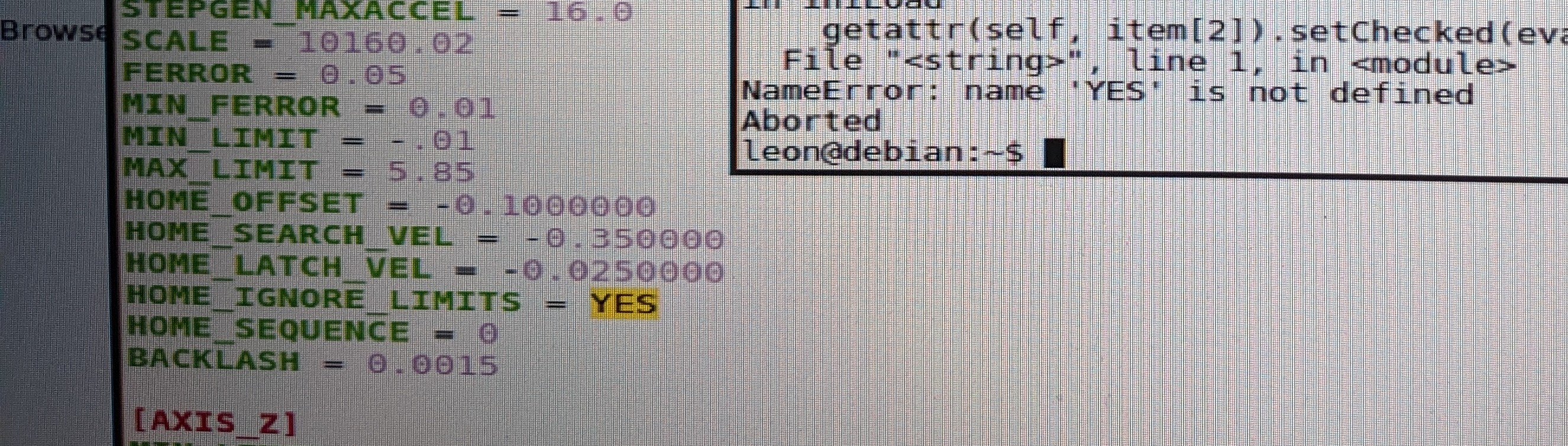

14 Nov 2019 23:23 #150394
by Leon82
Replied by Leon82 on topic 7i96 Configuration Tool
In my ini file I have ignore limits =yes
I get an error saying yes is undefined.
Should I change yes to a 1?
14 Nov 2019 23:35 #150395
Replied by andypugh on topic 7i96 Configuration Tool
Try YES and also maybe adding a space after the = ?

14 Nov 2019 23:47 #150396
by Leon82
I typed it on my phone, but there is a space and yes is all capital

14 Nov 2019 23:48 #150397
Replied by tommylight on topic 7i96 Configuration Tool
1

14 Nov 2019 23:54 #150398
by Leon82
That worked.
I restarted my machine just to double check they gave me an error that the joint was on the limit switch but it seemed to home fine. Worst case I can change it to yes after after I switch everything over
1
That worked.
15 Nov 2019 00:07 #150399
Interesting, as the docs say "YES"
linuxcnc.org/docs/2.8/html/config/ini-co...t__lt_num_gt_section
1
