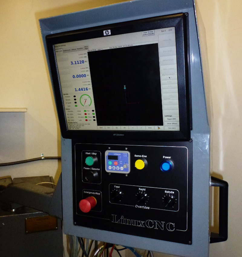

I am in the middle of doing a retrofit on the same machine. Over the holidays I installed the new controller and powered it up. Overall things have gone well, all of the controls work and the servos are tuned and working smoothly. But I ran into a big glitch with the encoders. I am using the original ERO-115 encoders and 4 EXE 602D interpolation boxes. The scale is off and also inconsistent. I looked at the A B quadrature signals with halscope and they look bogus (inconsistent phase, symmetry). I am surprised it works as well as it does. Not sure what is wrong.
Being farther down the path I can probably save you quite a bit of time. I would be happy to share details about my configuration and the land mines I ran into. I created a custom GUI with a touchscreen that you might want to look at.

I would love to get your files for the custom panel. I definitely like your setup. What size monitor did you go with and how did you mount it? That is my next job.
Also, did you build a custom panel for the space the original controller was installed in? Looks nice.

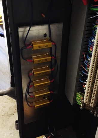

For the VFD you only need a 2 HP unit. I used a Hitachi SJ200 from AutomationDirect with good success. A larger unit may be more difficult to fit into the cabinet. I added external braking resistors and put an encoder on the spindle.

What size braking resistor did you go with?

04 Jan 2016 18:19 - 04 Jan 2016 18:24 #67861

I am using a 15" HP L5006tm touch screen that I got on ebay for $80. I was not sure about how well the touch screen would work. With my limited experience so far must say that I am really happy with the usability. I divided functions so that the touch screen only has setup and I only use physical buttons for operation. That ended up being reasonable, but after plying a bit I would be less hesitant to put more functions on the touch screen. You should plan on having a wireless keyboard available for the rare, but important times when you need it.
I built custom panels to mount the monitor and the new controls when the original monitor and TNC151 were. Since my machine was initially working (before I broke it) I used it to make the panels.
For the braking resistors I used 7, 6 ohm, 50w resistors (DigiKey part # A102165-ND) wired in series and mounted on a piece of 1/8" aluminum. That provides 300w of dissipation and it barely gets warm after repeated braking.

Nice breaking resistor setup! I'm going to copy you!

Attached is a tar file with my configuration files and the new GUI.
