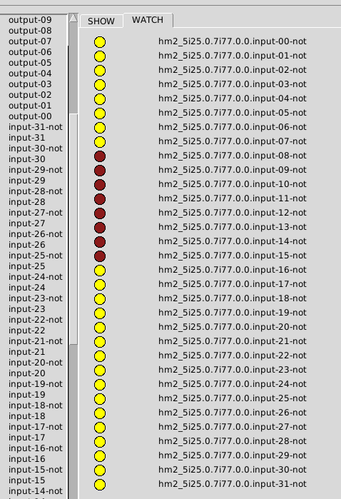

Well I checked it with 24 vdc on the pins directly and had the same results.
The screen dump below shows the pins before checking.
The TB8 pins that show the red color at the start are the problem.
Is the any other test or are they just bad?
I don't need that many io's so it isn't a problem now.
