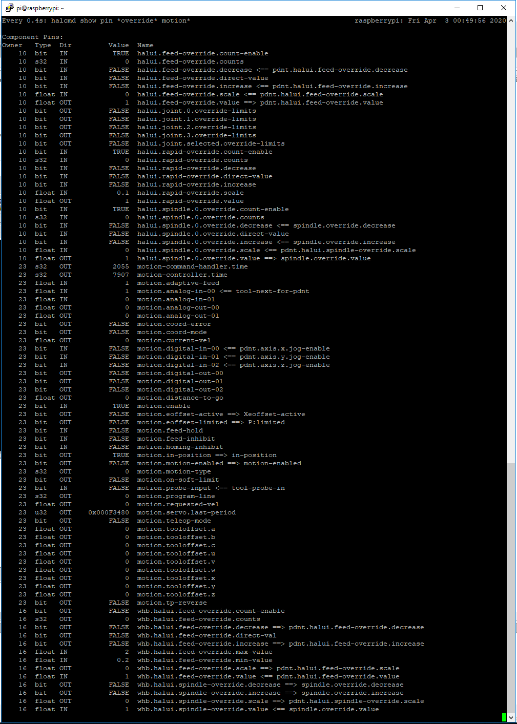

02 Apr 2020 22:42 - 02 Apr 2020 23:26 #162507 by alkabal
Replied by alkabal on topic XHC-WHB04B-6 LinuxCNC not working
Hi
Ok thanks for suggestion i will check for some motion.pin.
But only for stuff that can be used when program.is.running ? (like spindle override and feed override)
Except that a pendant is mostly a user component, or i'm wrong ?
Is this have more sense ? "In Mpg mode the step speed is in percent of max-velocity"
(if yes the good pin it is halui.max-velocity.value for calc ?)
i have do some test using halui.max-velocity.value * feed-button-position * 0.01 and i see the machine cant' move more than 16mm with one pulse but off course i think is better to use smaller value.
resulting value :
2% : 70 x 2 x 0.01 = 1.4 = move 1.4mm
5% : 70 x 5 x 0.01 = 3.5 =move 3.5mm
10% : 70 x 10 x 0.01 = 7 = move 7mm
30% : 70 x 30 x 0.01 = 21 = move 16mm
60% : 70 x 60 x 0.01 = 42 = move 16mm
100% : 70 x 100 x 0.01 = 70 = move 16mm

02 Apr 2020 22:50 #162512 by alkabal
I see any nothing usefull in motion pin
02 Apr 2020 23:41 #162515 by andypugh
Replied by andypugh on topic XHC-WHB04B-6 LinuxCNC not working
USB ones are, yes.
MPGs connected by ABZ wires to encoder counters in HAL and buttons connected to HAL can be realtime all the way.
03 Apr 2020 03:06 #162527 by alkabal
Ok i understand, but in all way i can't see any motion override or jog related pin.
I have do a big cleaning for source code and use max-velocity for mpg
Two more stuff liked but no idea for do this for now
-swap spindle speed displayed on the pendant from Override % to Current-velocity regarding to used button (spindle+/+ or override+/-)
-Restore the MPG/CON/STEP usage for now the code force MPG at startup and does not allow to use the CON mode.
