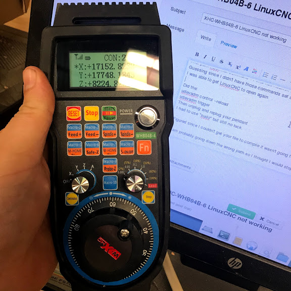

16 Oct 2019 00:23 - 16 Oct 2019 00:31 #147958
by randypetersen
Replied by randypetersen on topic XHC-WHB04B-6 LinuxCNC not working
Thanks for all the info,
So I got my unit today, I like the look and feel of it.
Spent a few hours trying to get it setup, without success.
Added file:
/etc/udev/rules.d/90-xhc.rules
with the following line:
SUBSYSTEM=="usb",ATTR{idProduct=="EB93"},ATTR{idVendor=="10CE"}, MODE="666"
With your xhc-hb04.cc file I followed the instructions here:
wiki.linuxcnc.org/cgi-bin/wiki.pl?Using_...Wireless_MPG_Pendant
After fighting some dependency issues this is the error I ended up with:
I changed line 31 to: #include <libusb-1.0/libusb.h> just to get past an error:
xhc-hb04.cc:31:20: fatal error: libusb.h: No such file or directory
added "HALFILE = xhc-hb04.hal" to my ini file
commented out some lines regarding axis3, i am guessing since I don't have an "A" axis.
Also lines:Guessing since I didn't have those commands set up?
I was able to get LinuxCNC to open again.
Did the:
udevadm control --reload
udevadm trigger
Then unplug and replug your pendant
I had to use "sudo" but still no luck.
Figured since I couldn't get your file to compile it wasn't going to work for me.
I am probably going down the wrong path so I thought I would stop and ask the experts.
Any input would be appreciated.
Is there a good "HOWTO" to follow along to?

Last edit: 16 Oct 2019 00:31 by randypetersen. Reason: added image - for interest? :) & hal/ini files

Debug file information:
Note: Using POSIX realtime
libusb_claim_interface: Device or resource busy
./xhc-hb04.hal:91: Pin 'halui.spindle.0.override.increase' does not exist
Commented the next few lines that gave me errors out, and I am at:
./xhc-hb04.hal:35: waitpid failed xhc-hb04 xhc-hb04
./xhc-hb04.hal:35: xhc-hb04 exited without becoming ready

I had the [XHC-HB04] in my main ini, although the way you have it should work
Ah I see the typo:
SUBSYSTEM=="usb",ATTR{idProduct}=="eb93",ATTR{idVendor}=="10ce", MODE="0666"
If you need sudo the device won't become ready
Ah I see the typo:
Last edit: 16 Oct 2019 21:50 by satiowadahc. Reason: Clarity

Hey I got LinuxCNC to start!!!
The stop button works, but can't seem to get anything else working at the moment, probably cause I kept commenting out lines to get it to start up.
I think I missing something on why it kept saying PIn doensn't exist... For the moment I was just commenting them out to see if I could get anywhere. Any guesses on what I am missing?
Mostly in the XHC-HB04.HAL file...
Do you think I need to move those INI lines you mentioned?

Not my forte but, did you add your user the the dialout group ?
Without it you will not have full access to USB ports. Learned that from using arduinos.
