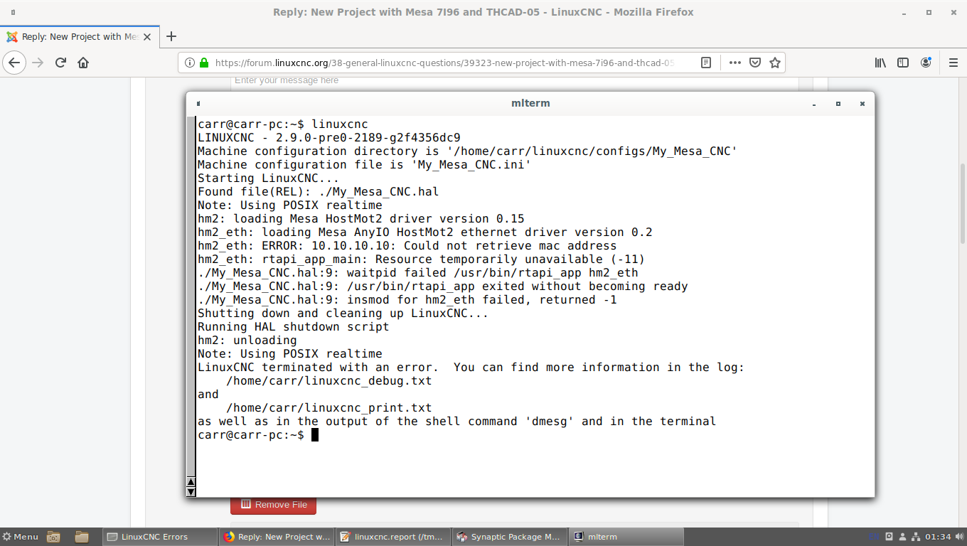

OK I did the debian install route and that worked then I downloaded the zip file to get linuxcnc install and it installed 2.9 will that work with mesa cards? I started the pnconfig wizard and went through the steps and went to open the gui and it gives me a error again.

14 Jun 2020 07:10 #171571
by TexasCNC
Replied by TexasCNC on topic New Project with Mesa 7I96 and THCAD-05
I fixed the address for the board on my connections to 10.10.10.11 still get the same error

14 Jun 2020 08:43 #171581
Replied by rodw on topic New Project with Mesa 7I96 and THCAD-05
Can you ping the card? If you can't sort out the network side first.

14 Jun 2020 14:54 #171605
by TexasCNC
Yes I can computer is set up with
Ip-10.10.10.11
Mask- 8
GW-10.10.10.1
I can ping the board
10.10.10.10
Ip-10.10.10.11
Mask- 8
GW-10.10.10.1
10.10.10.10

14 Jun 2020 15:03 #171607
Replied by tommylight on topic New Project with Mesa 7I96 and THCAD-05
Attach hal and ini files, and also the debug part of the error.
