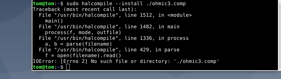

It looks like it couldn't find ohmic.comYou probably need to be in the same directory as ohmic3.comp when you run halcompile or maybe enter the full path to ohmic3.comp
IOError: [Errno 2] No such file or directory: 'ohmic3.comp'

you might need to use sudo halcompile --install ./ohmic3.comp
Sometimes linux needs the "./" before a filename to tell it to look in the current directory

Wrong folder, that has to be run on the folder where ohmic3 is located.

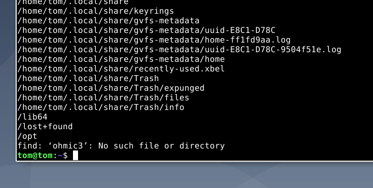

I would be wonderful to know where the folder is.
And that is only one of the problems shown.

locate ohmic3
should help (assuming you are not running a RPI or other similar CPU)

ohmic3 does not seem to be a part of LinuxCNC
Were you supposed to have downloaded it from somewhere?

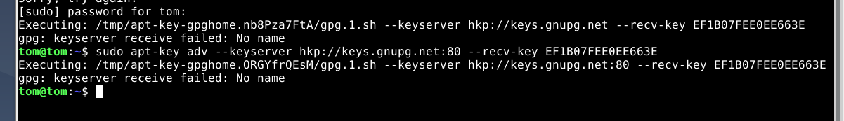

I am getting the same, it seem the keyserver has been taken offline. sks-keyservers.netI also have problems getting the key in the buildbot routing Phillc posted
Edit2: This is probably the more correct one:
sudo apt-key adv --keyserver hkp://keys.openpgp.org --recv-key EF1B07FEE0EE663EThis one seems to be ok for the moment:
sudo apt-key adv --keyserver hkp://pgpkeys.eu --recv-key EF1B07FEE0EE663EEdit1: This one looks ok as well:
sudo apt-key adv --keyserver hkp://keyserver.ubuntu.com --recv-key EF1B07FEE0EE663E
