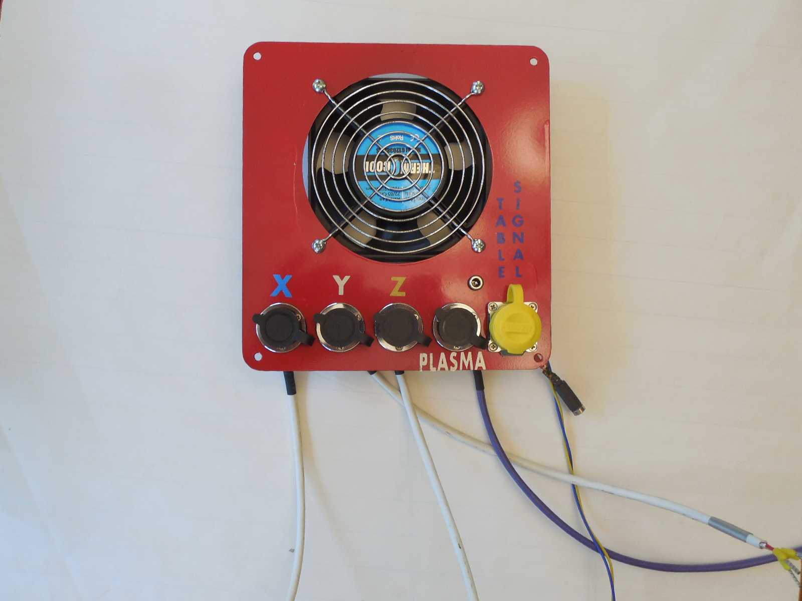

If each of these is wired back individually then you could use six individual 7i76E inputs as:My setup now has a single switch for each axis, located on the moving parts, there is a switch trip at each end of travel for that axis.

- acourtjester

You shouldn't have to but it is an option and you have plenty of inputs available. I assumed from the pic on that post and the following statement that you had already changed to individual ones.
