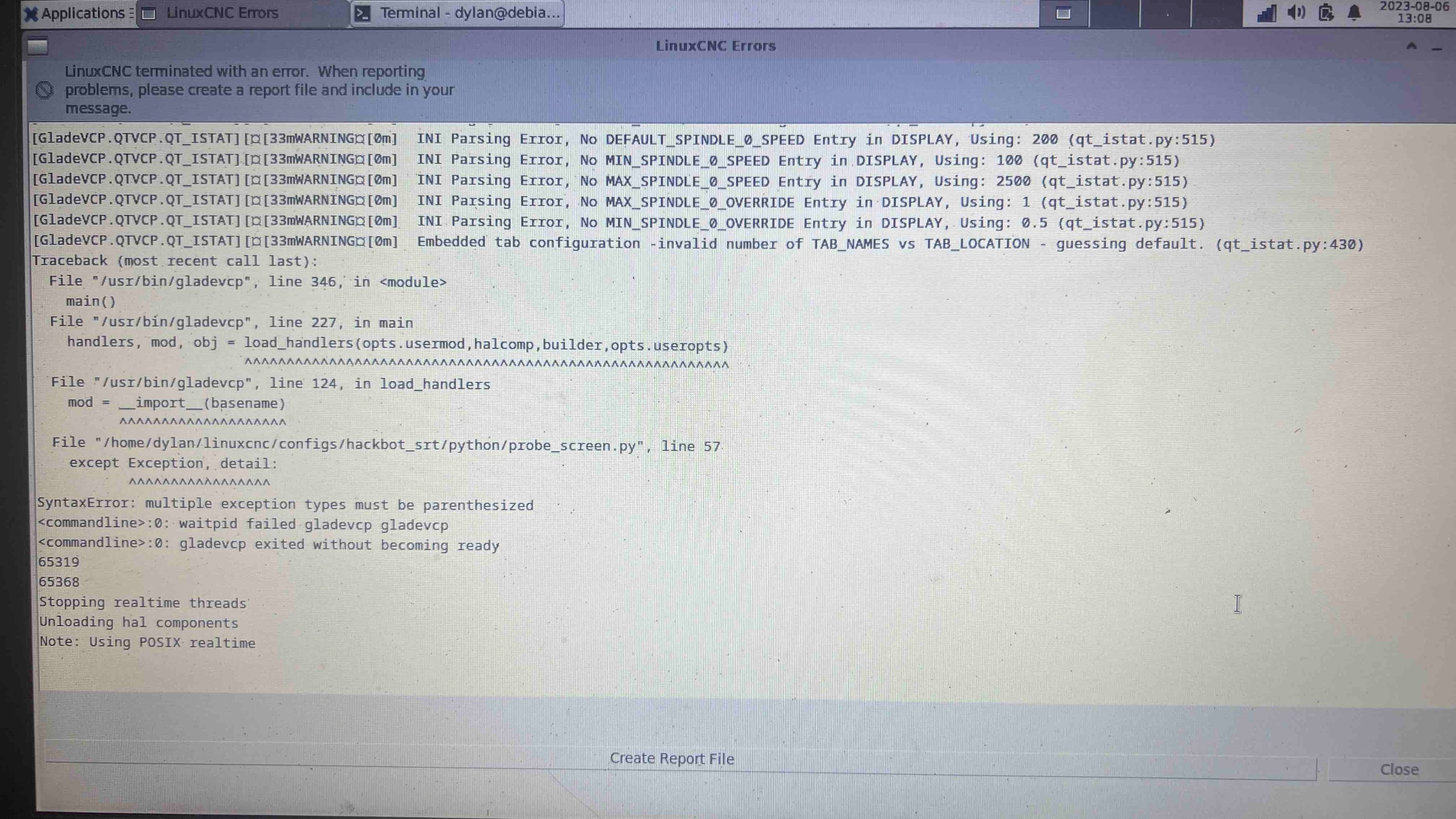

06 Aug 2023 19:17 - 06 Aug 2023 19:18 #277138 by IronManDylan
Replied by IronManDylan on topic Please Help - How to Configure a 5 Axis Head-Head
Aciera
Okay, did that, now looks like I am getting python syntax errors, missing parenthesizes.  I have added image.  So maybe we are getting further along the program. Fixing those now, will report back.

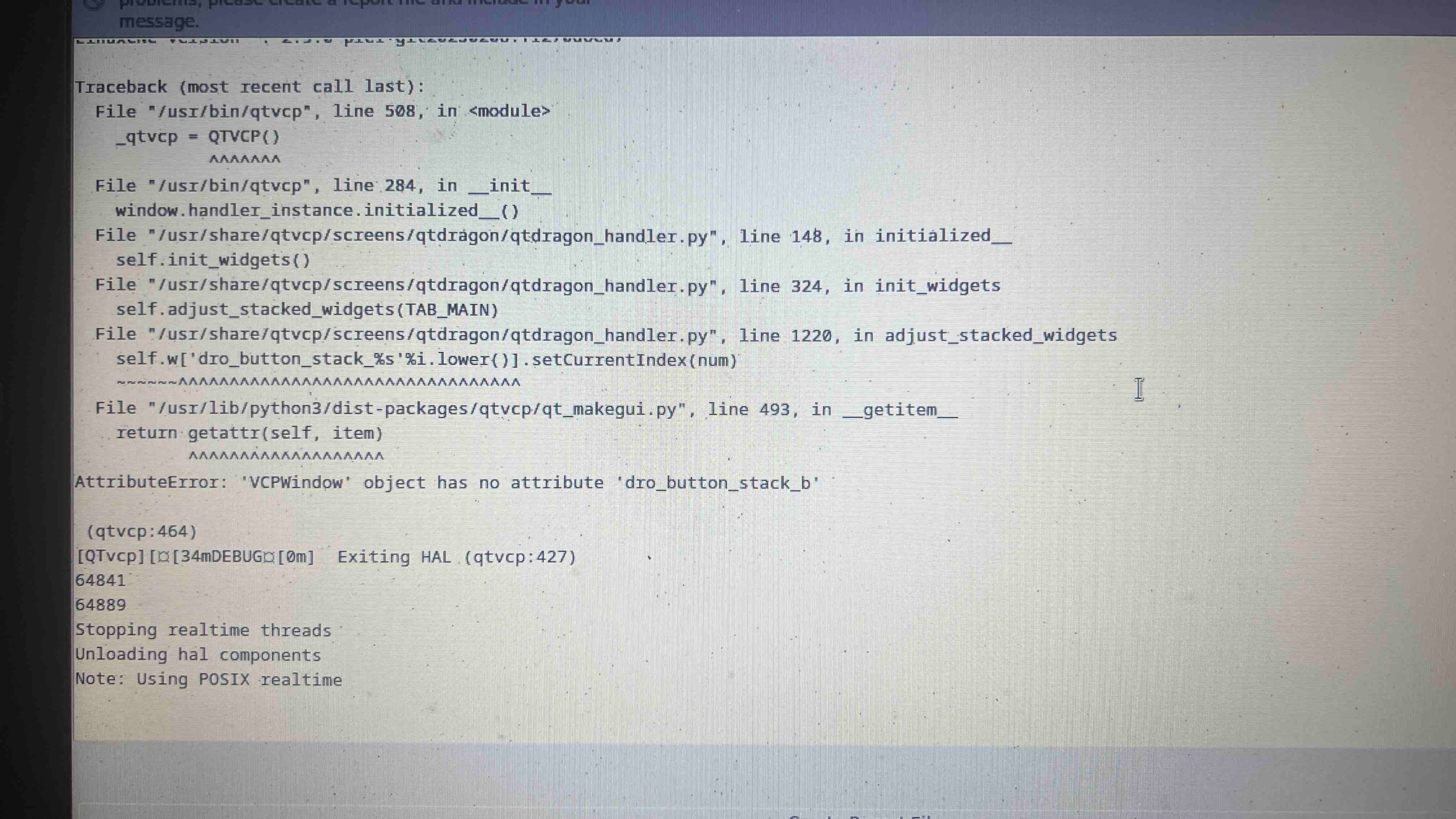

Rodw
I attempted qtdragon and got an error.  Image attached.  It looks like it cannot find b.  Assuming that is b axis.  Qtdragon explicitly states it is for 3 and 4 axis, so maybe it is lost with trying to find the b axis?

06 Aug 2023 19:27 #277141 by rodw
You would need to take the errors up with cmorely in the QTVCP section. I did see its 4 axis only but if that's the case, it really needs to support more axes. GUI's should not restrict linuxcnc's feature set to my mind.

06 Aug 2023 19:29 #277142 by Aciera
Yes, looks like the python code has not been updated to where it needs to be. If it doesn't work out for you I'll have a look if I can get it working on my test machine tomorrow.

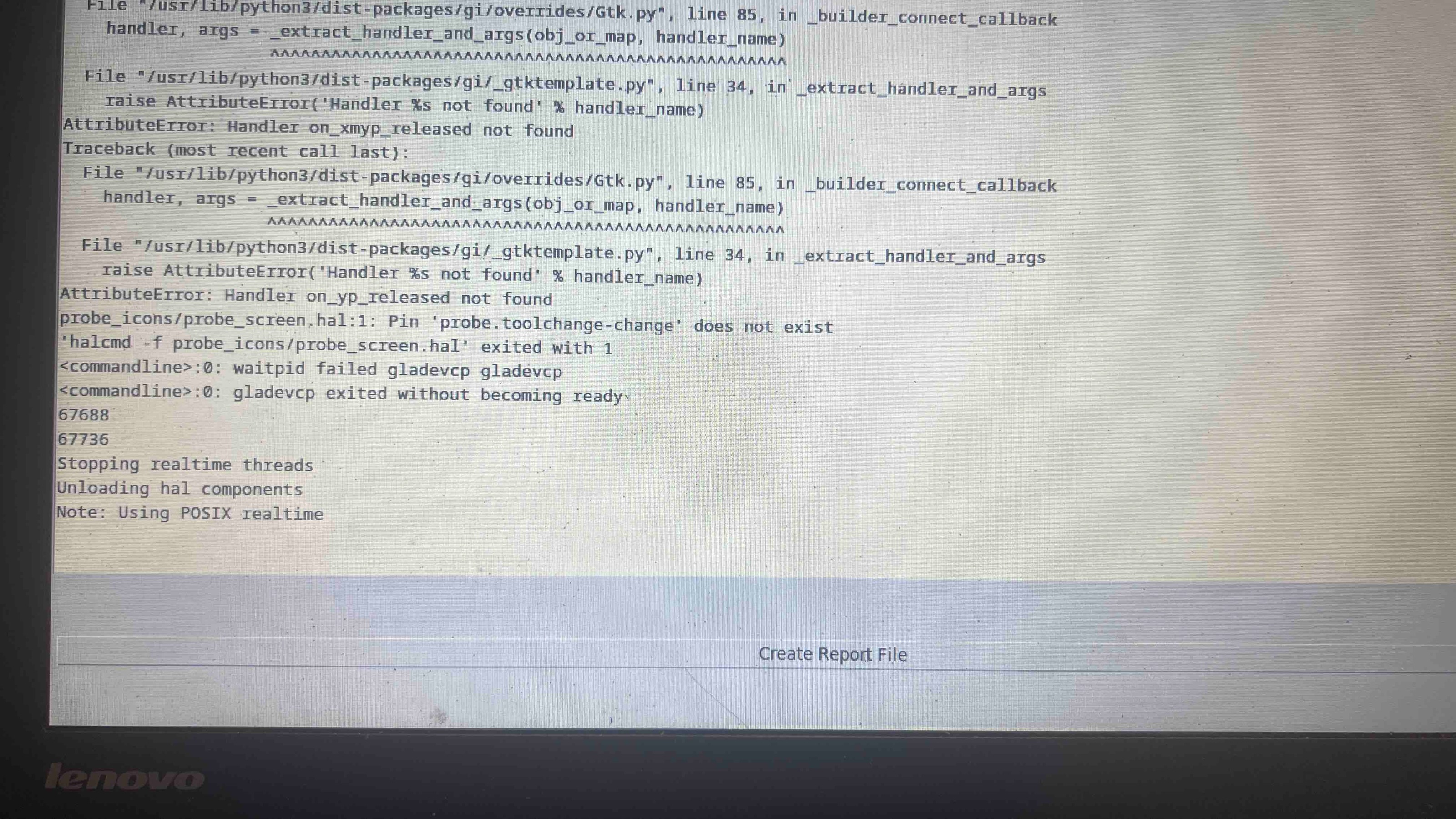

06 Aug 2023 20:06 - 06 Aug 2023 20:07 #277152 by IronManDylan
Aciera
I chased out a bunch of bugs and think I have the python mess handled.  However, I have hit this bug and cannot seem to move past it.  Picture provided.  I do not know where 'probe.toolchange-change' is coming from, have looked through all the hal files.  There is not a "tool change" icon in probe_icon, so it is weird that something is trying to call that.  There were some things I forgot to comment out in main hal file that I updated but did not make a difference.  Have provided zip for reference.

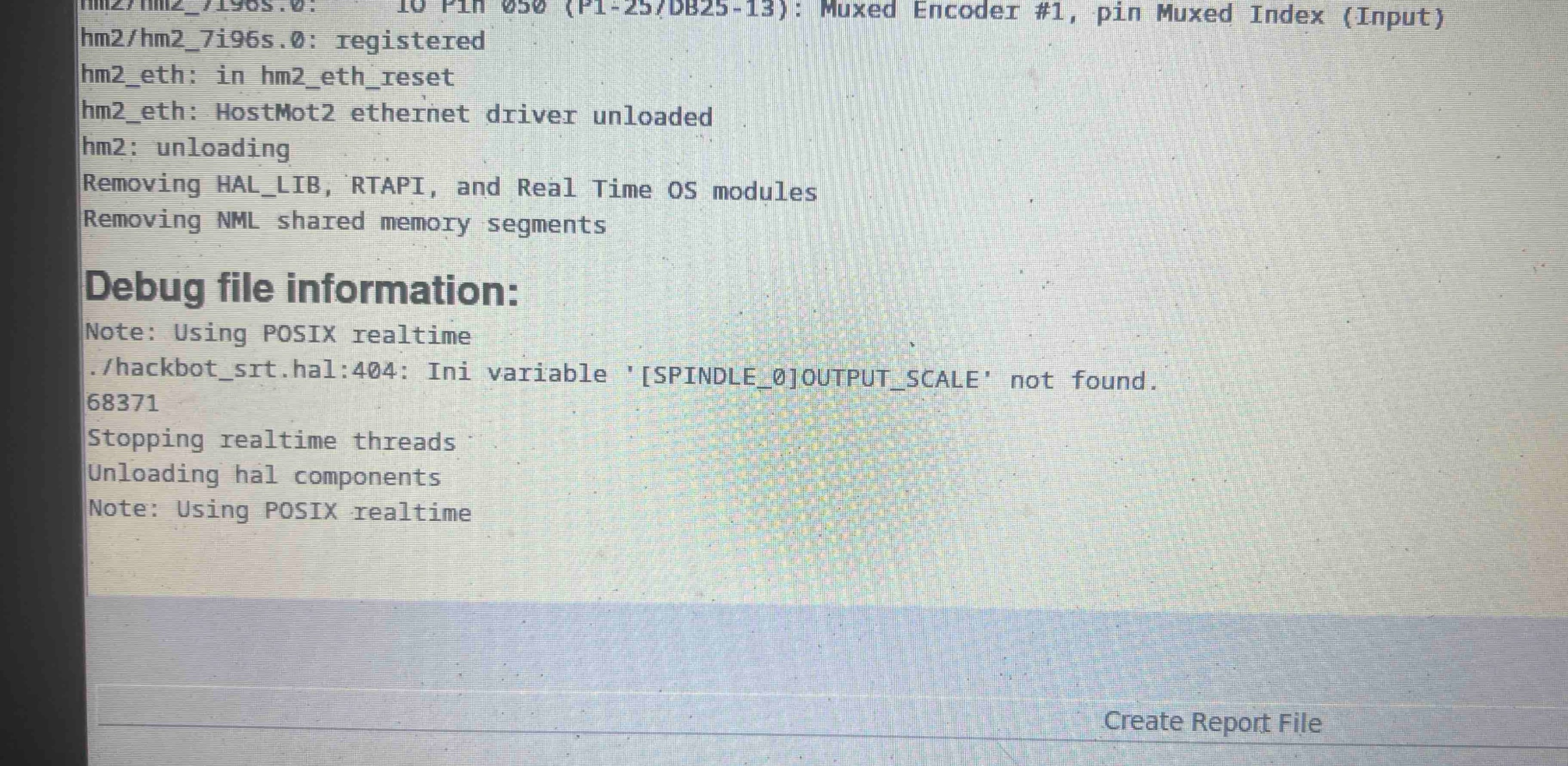

06 Aug 2023 20:23 - 06 Aug 2023 20:23 #277156 by IronManDylan
PCW
I got the following error, image attached.  It appears that [SPINDLE_0]OUTPUT_SCALE is being called but isn't defined anywhere.  If I knew which pin to set it to I would but I don't...

06 Aug 2023 21:32 #277168 by PCW
You would need to add that constant to the spindle section of your ini file
