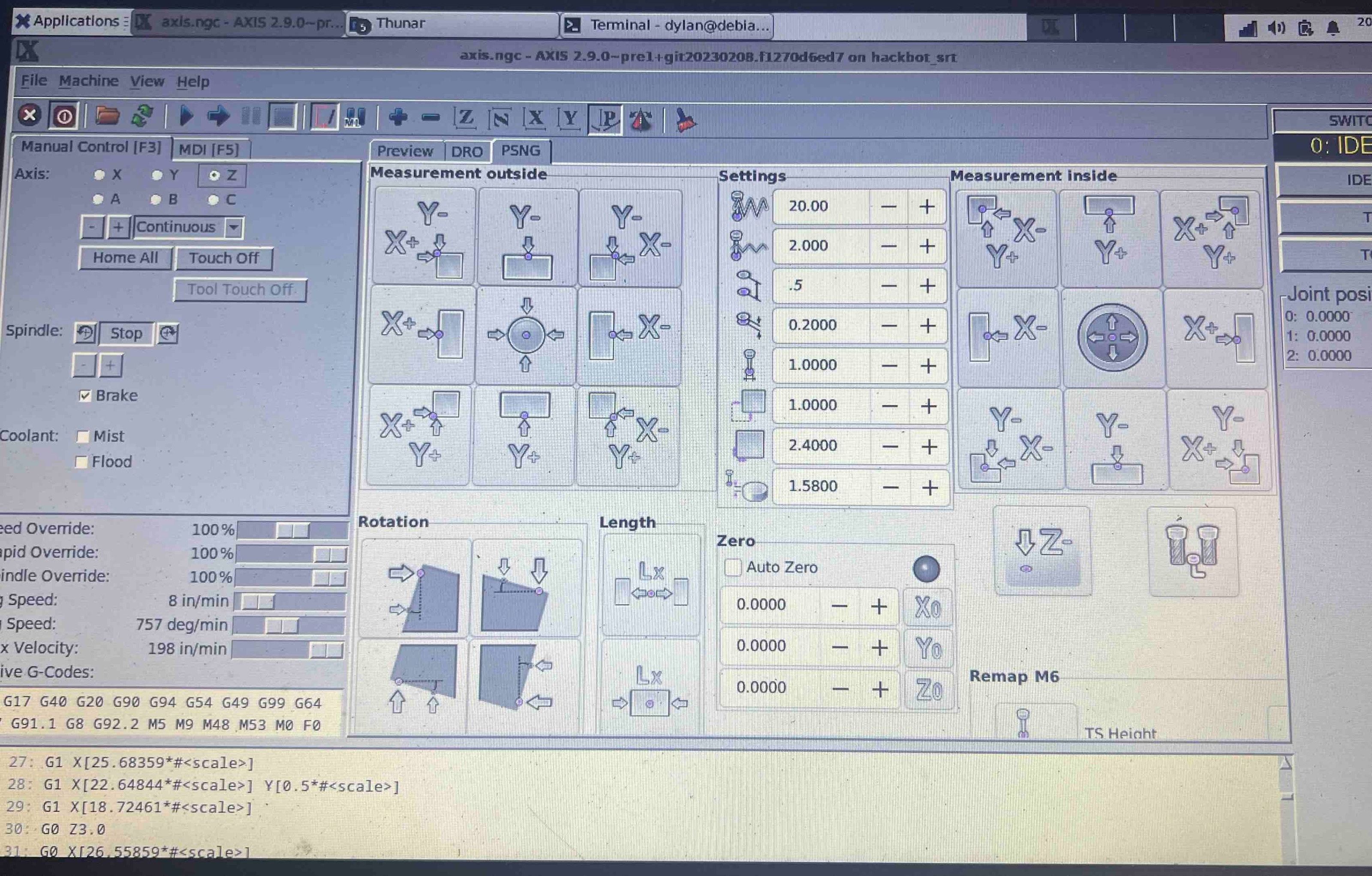

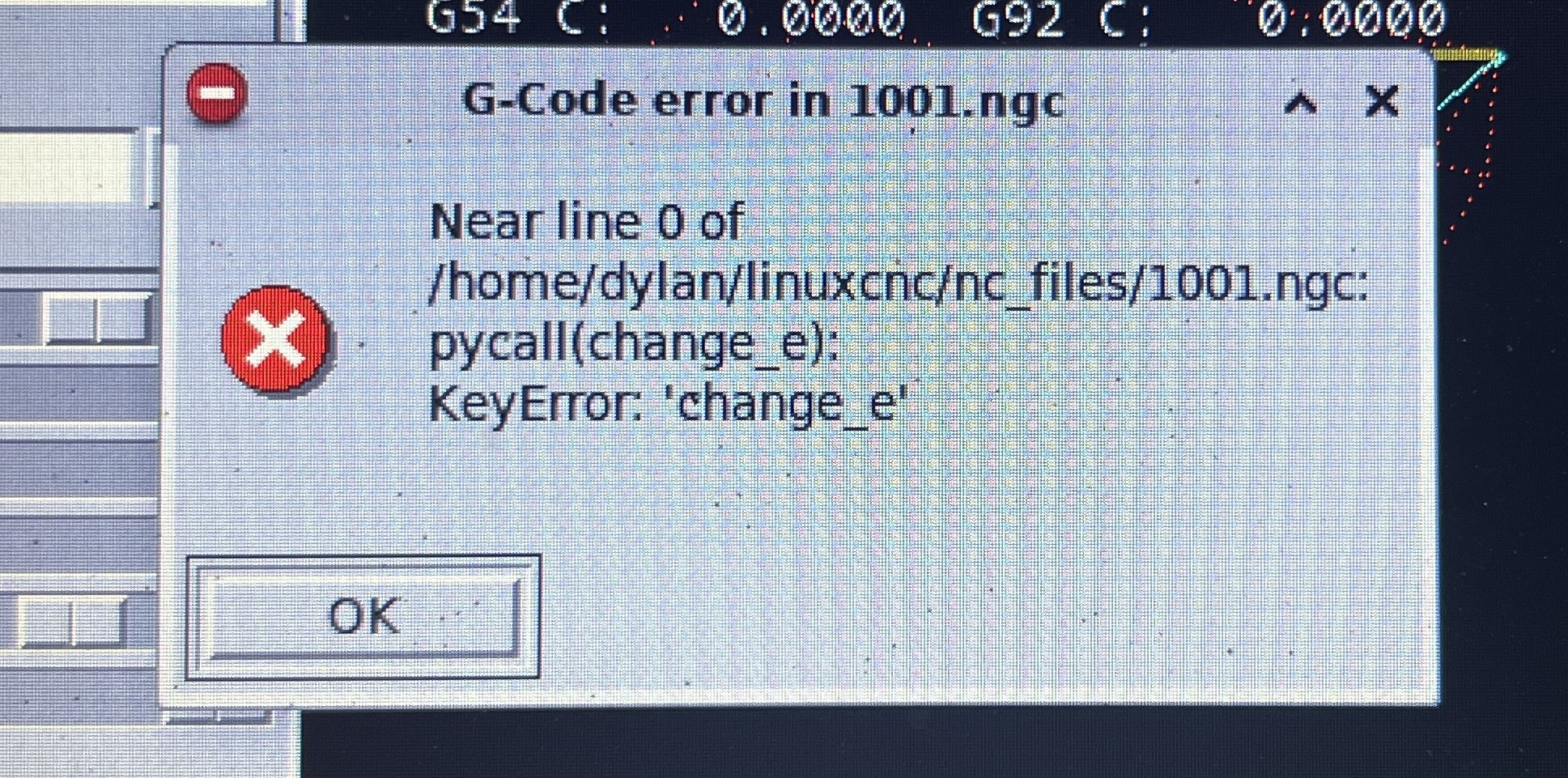

probe update:
I followed the directions I found here: github.com/verser-git/probe_screen_v2.8
This seem to incorporate the 'psng' and python files that you were suggesting.
But I am still getting the attached error. I have added my config file as reference.
- IronManDylan
- Posts: 151
- Thank you received: 22
07 Aug 2023 15:27 - 07 Aug 2023 15:59 #277245
by IronManDylan
Replied by IronManDylan on topic Please Help - How to Configure a 5 Axis Head-Head
Update
Probe menu does seem to be working! Also, probe signal appears to be coming through, at least for probing z, will need to mess with it longer to make sure there aren't any bugs. The issue I was having is that the 'psng' folder did not have all the needed files in it, once I updated those it began to work
Now if we can get this spindle timer thing working I should have a fully functional machine
edit: the probe rapid speed is inane though. Definitely makes me feel like I’m going to crash the machine. And adjusting rapid override doesn’t seem to help. I wonder if that is due to it being written for mm and/or if there’s a way to adjust this speed in the software somewhere
Last edit: 07 Aug 2023 15:59 by IronManDylan.

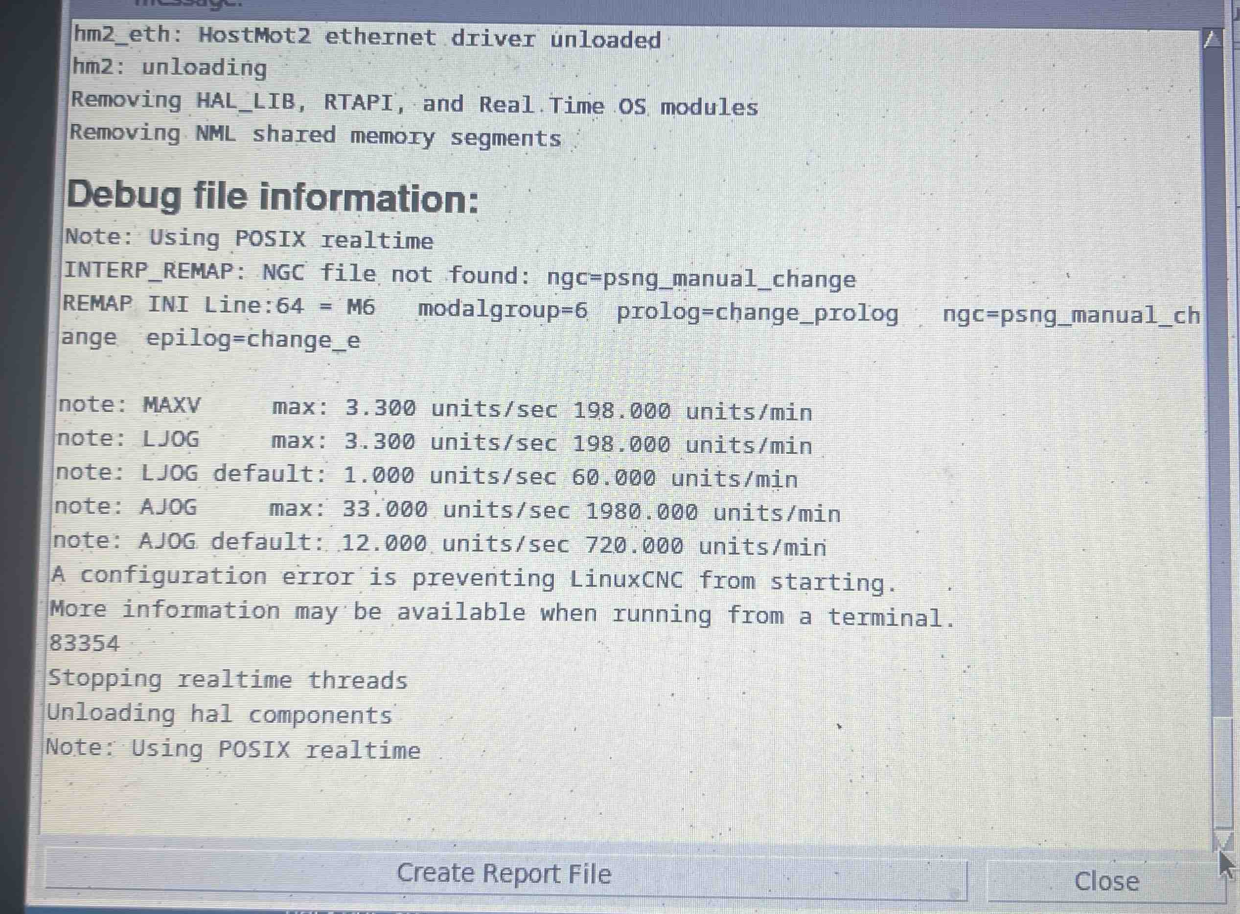

- IronManDylan
- Posts: 151
07 Aug 2023 19:40 - 07 Aug 2023 19:48 #277269
by IronManDylan
Aciera
It appears to be in units/min. At least changing it seemed modify it to inches/min.
But now there is another problem. I cannot upload gcode. For the life of me idk why adding a probe module to Axis would make it so that I cannot upload gcode. But I am getting the error 'KeyError: 'change_e'' when I try to upload gcode. Same thing with the gcode that tried to autoload upon opening axis. Image of error is attached. I will also attach the gcode file so that you can look at that.
Tommy
I believe Rodw said what you attributed to Aciera unless I have missed a message somewhere. My spindle does not have an encoder or VFD feedback. Ie there is no spindle speed feedback of any kind. I just want a delay to allow time for the spindle to spin up. I have set the pin you are referring to to spindle.0.at-speed. When I do so I get an error stating that spindle.0.at-speed is already linked to spindle-at-speed. When I comment out that line (#net spindle-at-speed => spindle.0.at-speed) I am able to get the configuration to launch. I have tried all this before but this time I was still able to control the spindle through MDI which last time I was not able to (maybe I forgot to have the VFD turned on last time). Last time I got to this point I tried to run gcode and did not get the delay I was looking for. Perhaps the delay time is in microseconds and not seconds? I am unable to run gcode to test right now.
G04 P5 would be fine too if I can get the post processor to add these lines. I send out so much gcode I will forget to do it and crash the machine if I have to do it manually...
edit: so now it seems like the machine can do (almost) everything it needs to do except the one thing that it absolutely has to do haha.

07 Aug 2023 20:07 #277274
Replied by Aciera on topic Please Help - How to Configure a 5 Axis Head-Head
Ok, fixed the terminology, thanks.
Regarding the error when loading a gcode file I'll have to see if I get that on my test machine as well tomorrow. Although if I recall correctly then my sim config auto loads a demo gcode and I don't think I got any errors.
Can you please post your current compressed machine config where the error occurs?
- IronManDylan
- Posts: 151
07 Aug 2023 20:20 #277275
by IronManDylan
Aciera
Apparently the file is too large even when zipped, idk how it got so large. Try this google docs link and let me know if it works for you: drive.google.com/file/d/1L3hDe-gguBDeSKf...qnB/view?usp=sharing
I hope we can figure it out. I feel we are so close.

- Posts: 4819
- Thank you received: 2176
07 Aug 2023 20:31 - 07 Aug 2023 20:38 #277277
Are you using an Apple machine to compress your folder?
[edit]
Reason I'm asking is that there are a whole bunch of file copies like '._<filename>' in the archive which basically doubles the size. This seems to stem from an apple way of doing things.
So if you are indeed compressing your folder on a mac then please use the linux procedure instead:
Right click on the config folder and choose 'create archive' or maybe 'compress' (I forget what bookworm uses)
[edit]
