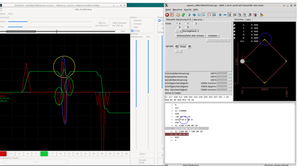

Hallo,
I tested the new version today and noticed that when I round the corners P64 P10.0 the speed of the axis (joint) does not behave as expected (yellow circle).
The acceleration (green circles) is interrupted by (blue circles) whereby the change in acceleration (jerk) appears to be too large.
At P64 P0.0 the axis (joint) behaves as expected.
Can this behavior be set via parameters?
Gruß
Rüdiger

@Rüdiger
May this be a result of the missing (?, the screenshot is hard to read) Q parameter? From the readme :
Important Runtime NotesWhen using the S-curve trajectory planner, always use the
command combination. IfG64 P[x] Q[x]is not specified, the interpreter may:Q[x]A standard input should look like this:
- Remove or filter out small segments.
- Convert arc segments into line segments.
G64 P0.01 Q0.0

As far as I know, the Scurve Trajectory Planner plans the tool's trajectory using jerk, acceleration, and speed, which works very well, but doesn't take the constraints of the individual axes into account.
For example, the trajectory speed is constant in a 90° corner, while the axis speeds change without considering constraints.
This can be seen in my previous post.
I hope I explained the connections correctly.
gruss
Rüdiger
This is correct. In the source code the trajectory path is used to calculate xyz coordinates.
There it doesn't apply any calculation to reduce any speed for x or y or z. So if Z maxvel is very low, it does not reduce
speed for z.
speed for z.
