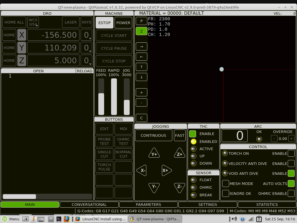

I think I have now successfully moved my config from the plasma via the backup from screen to another pc that I have put MXlinux on (thanks Snowy) it shows QTplasmac as V1.0.95
I then moved the ssd to my PC driving the plasma that all worked fine.
So then I wanted to update the original plasma ssd as it was on V1.0.32 I used apt-get update and apt-get dist-upgrade which ran fine I could see python 3 flashing past in the list.
But it did not change the QTplasmaC to the latest version is is still at 1.0.32
Have I missed somthing?
Edit the original ssd is linux 2.9
Last edit: 25 Sep 2021 14:17 by Clive S.

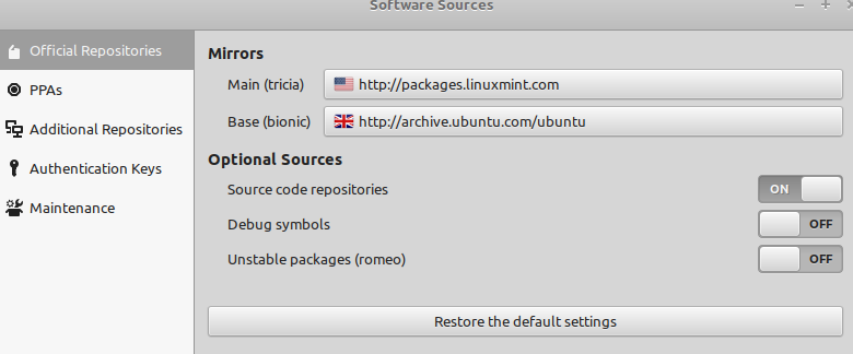

What distribution is the repository pointed to in the synaptic package manager?

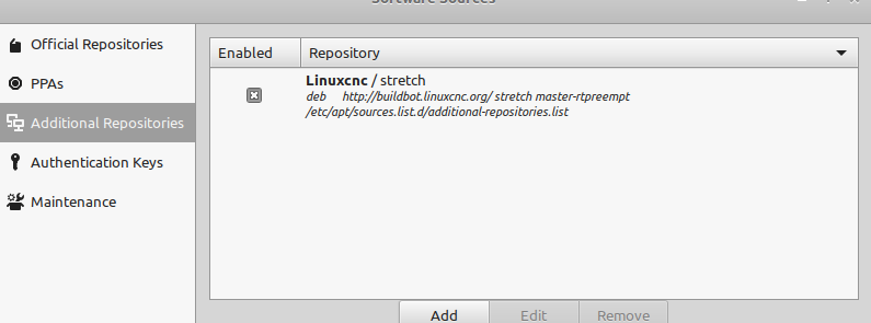

25 Sep 2021 15:19 - 25 Sep 2021 15:23 #221559
by Clive S
Does this help?
Replied by Clive S on topic LinuxCNC Install using MX Linux 19.4 - Geared Toward New Users - Discussion
Glad to hear it!
Does this help?
Last edit: 25 Sep 2021 15:23 by Clive S.

It does. For deb and deb-src (which it looks like you may be missing, at least in the photo you provided) you need to edit the entry and change “stretch” to “buster”.

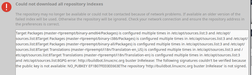

EDIT: I'll leave the below as a testimonial that you simply can't trust Windows users with Linux. Problem Fixed... I had found some random keyserver phase in a random post on this site and just copy-pasted with the port:80 added. Monkey CTL-C, monkey CTL-V. Didn't work (see below). Should have copied the actual keyserver stuff from the actual instructions and added the ":80". Success, and the follow-on repository addition worked.
Thanks for the installation guide. I have MX running, but got an error when trying to add the buildbot repository.
NOTE - I also got lots of failures when trying to do the 'keyserver' step. Finally tried the 'port 80' thing from the buildbot page and it appeared to work.
This is probably an issue on my end (network?), but I really don't know how to troubleshoot Linux enough to get any further.
Anyone decipher what this error is and how to fix it?

There is an issue with the keyser specified on the Buildbot page, try this one instead:
hkp://keyserver.ubuntu.com

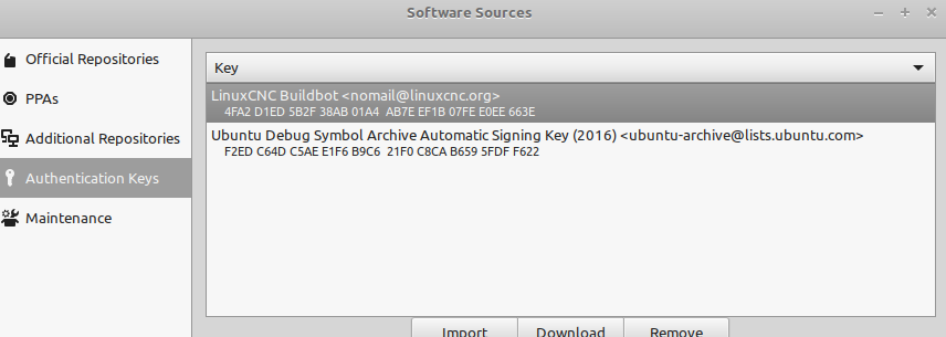

LinuxCNC seems to be using two keys, one for "base" and the other for buildbot.
Found out yesterday while giving Mint 20.2 another run with Master, it did not go well ...
