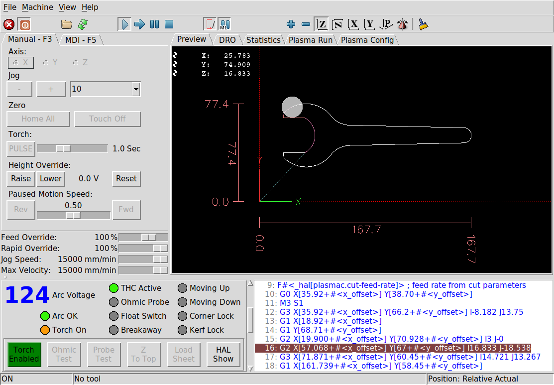

Axis is back!!!
Another update, some minor updates plus an Axis version is available again, I hope I remembered to put all the changes in.
To make my life easier I have moved the configs. Instead of being in configs/sim/gui/plasmac they now reside in configs/by_machine/gui.
All the files bar the ini files reside in the parent and the configurator will only copy files pertaining to your gui.
Cheers, Phill.

sorry but I can't get the arc-ok input to work .. trying the only one that comes on is breakaway switch.
net plasmac: float-switch <= hm2_7i80.0.gpio.035.in
net plasmac: float-switch => debounce.0.0.in
net plasmac: arc-ok <= hm2_7i80.0.gpio.039.in_not
net plasmac: arc-ok => debounce.0.1.in
why does breakaway turn on?

22 May 2019 07:35 #134554
by phillc54
Can you post ALL your HAL files

The best way to isolate the fault is to start by watching the signals in halshow. That will show you what is going on at the hardware pin level and let you make sure they are connected to the pins you think they are.

Actually I think:should be:Plus all the other lines appear to have a space after the : which should not be there.
Cheers, Phill.
net plasmac: arc-ok => debounce.0.1.innet plasmac:arc-ok => plasmac.arc-ok-inCheers, Phill.

it was just this: net plasmac: arc-ok => plasmac.arc-ok-in
that I had mistakenly linked to the debounce.
the translator put the spaces but they are fine
