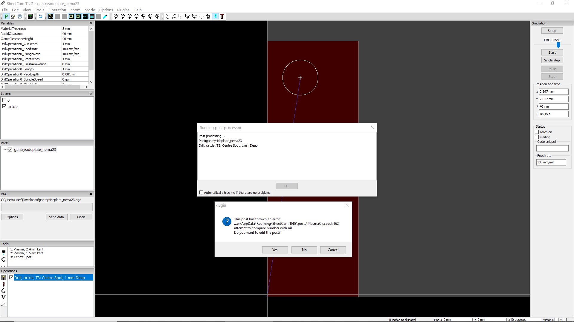

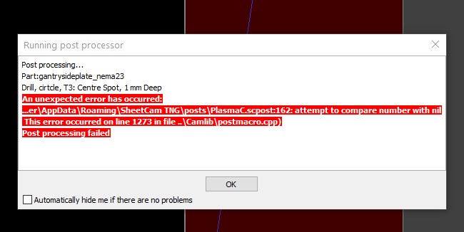

10 May 2020 06:09 - 10 May 2020 06:10 #167250 by Clive S
Replied by Clive S on topic PlasmaC Just using pierce for circle centre
Create one named "Centre Spot" don't worry about the parameters and use that.
I have done that and failed. It spotted on the edge of the circle Then I tried using the drilling tool which at first seem to work on screen sheetcam but then the PP fails.
Last edit: 10 May 2020 06:10 by Clive S.
10 May 2020 06:15 #167251 by phillc54
Replied by phillc54 on topic PlasmaC Just using pierce for circle centre
OK, when I first made this PP I was lazy and used a normal plasma tool as the centre spot tool then set the diameter so the leadin starts at the centre
