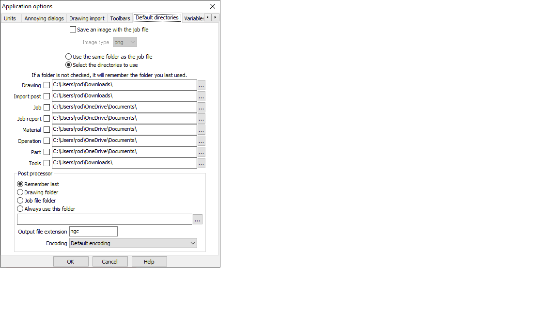

Simplest solution is to go into Sheetcam
Options/Application Options/Default directories and set the output file extension to ngc
While you are there, if using Sheetcam on your Plasmac PC, set your folders to your prefefences.

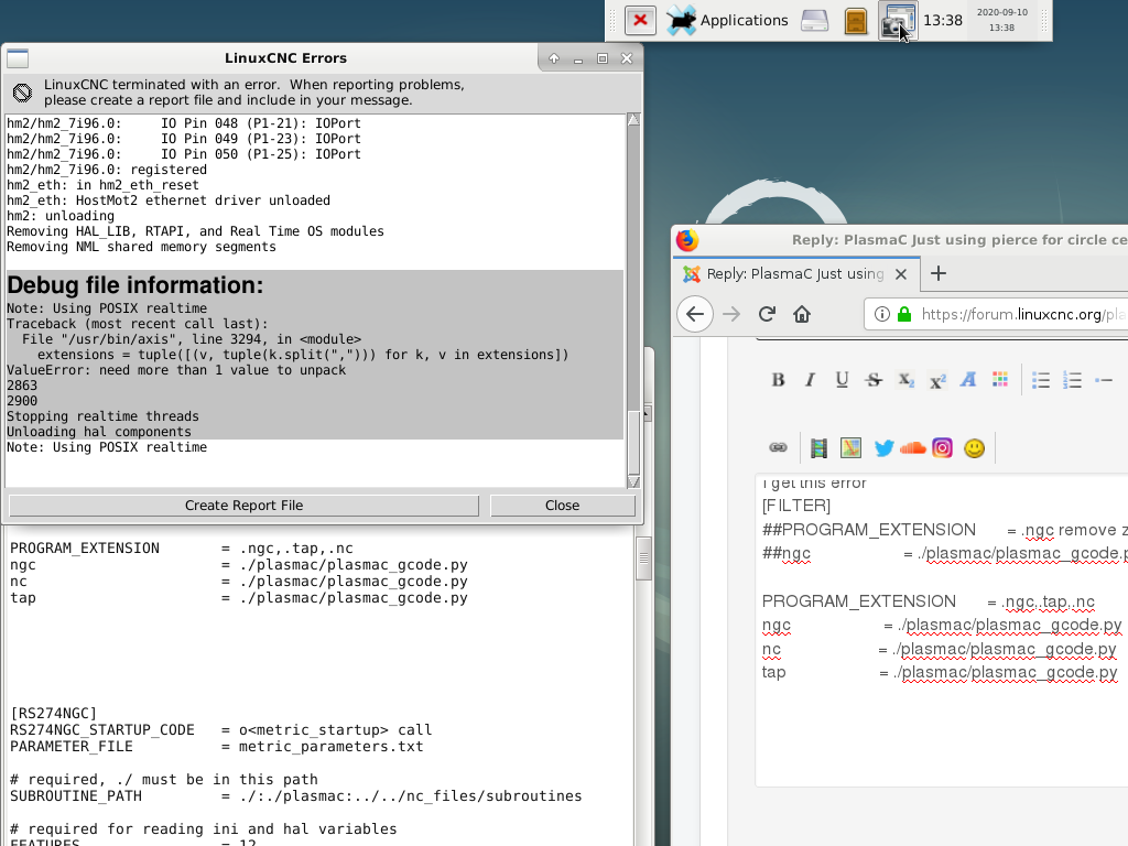

Have I got this correct as it throws an error I also tried it with ./plasmac/plasmac_gcode.py
on each line
Also where would this go
PROGRAM_EXTENSION = .ngc,.nc,.tap (filter gcode files)

10 Sep 2020 07:40 #181620 by Clive S
Replied by Clive S on topic PlasmaC Just using pierce for circle centre
Sorry Clive, my bad.
This is how I ran it on a sim of Deans config:
[FILTER]
PROGRAM_EXTENSION       = .ngc,.tap,.nc
ngc                     = ./plasmac/plasmac_gcode.py
nc                      = ./plasmac/plasmac_gcode.py
tap                     = ./plasmac/plasmac_gcode.py
What am I missing
[FILTER]
##PROGRAM_EXTENSION = .ngc remove z axis stuff
##ngc = ./plasmac/plasmac_gcode.py
I get this error
[FILTER]
