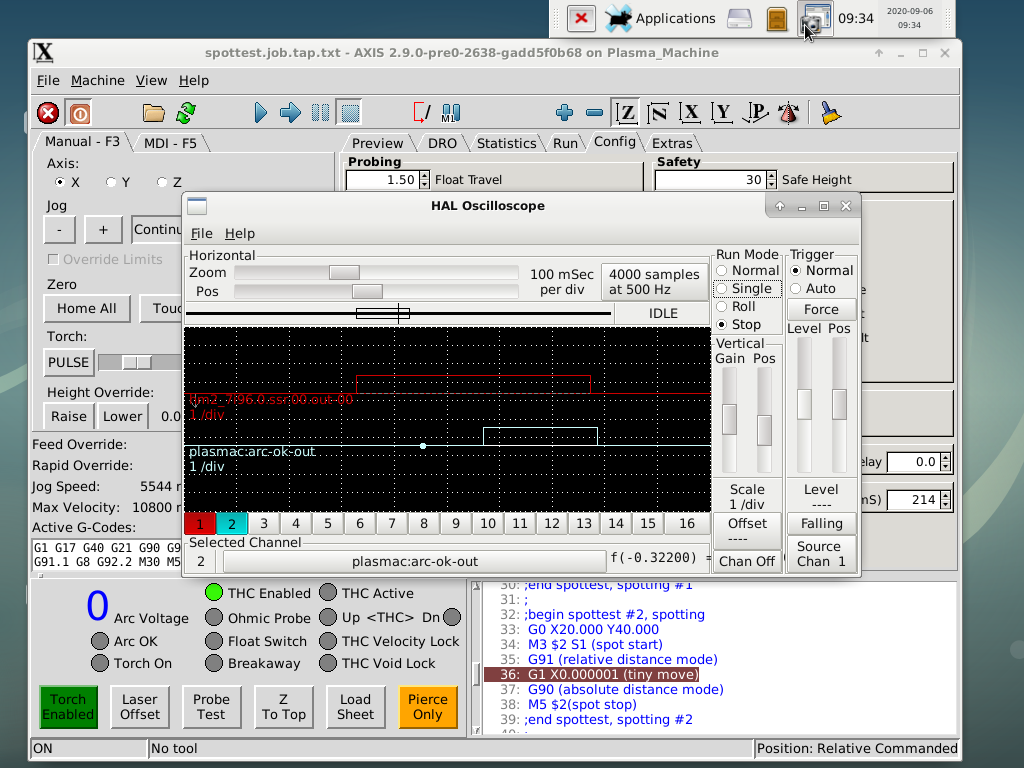

05 Sep 2020 12:33 #180815 by Clive S
Replied by Clive S on topic PlasmaC Just using pierce for circle centre
I am have a problem with pierce with the torch not firing hypertherm 45 the machine is generally running fine.
We want to pierce through at the hole centre so have used a drill operation but the torch does not fire.
I have attached the sheetcam job file (just two holes to test) and the gcode
Can anybody throw any light on this please

05 Sep 2020 19:03 #180875 by phillc54
Replied by phillc54 on topic PlasmaC Just using pierce for circle centre
I just ran your config as a sim and ran that gcode file and it all looked good here.The Torch On LED lit which indicates the torch output from the component works.
Run Halshow and put a watch on hm2_7i96.0.ssr.00.out-00 to confirm that it gets the signal.
06 Sep 2020 04:16 #180917 by Clive S
Phil I ran this on my machine as the other is 50 miles away. We have more or less the same config.
is this the correct plot:
Also could it be that just the small move in the code is the culprit
