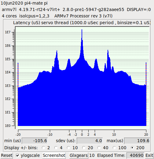

11 Jun 2020 14:15 #171168
by tecno
Replied by tecno on topic Raspberry Pi 4 with PlasmaC
Still getting some hm2/hm2_7i96.0: error finishing read
Been working with home switches on X / Y and during home all I have esc Z as it is not connected yet so maybe that can create the issue.
Have changed SERVO_PERIOD = 2000000
- Posts: 18118
- Thank you received: 5336
11 Jun 2020 15:53 - 11 Jun 2020 15:55 #171181
Replied by PCW on topic Raspberry Pi 4 with PlasmaC
You have _much_ worse latency than I do on my RPI4 .
This might be a setup issue
my cmdline.txt contains:
isolcpus=1,2,3 idle=poll acpi_irq_nobalance noirqbalance
and config,txt contains
force_turbo=1
force_turbo=1
Last edit: 11 Jun 2020 15:55 by PCW.

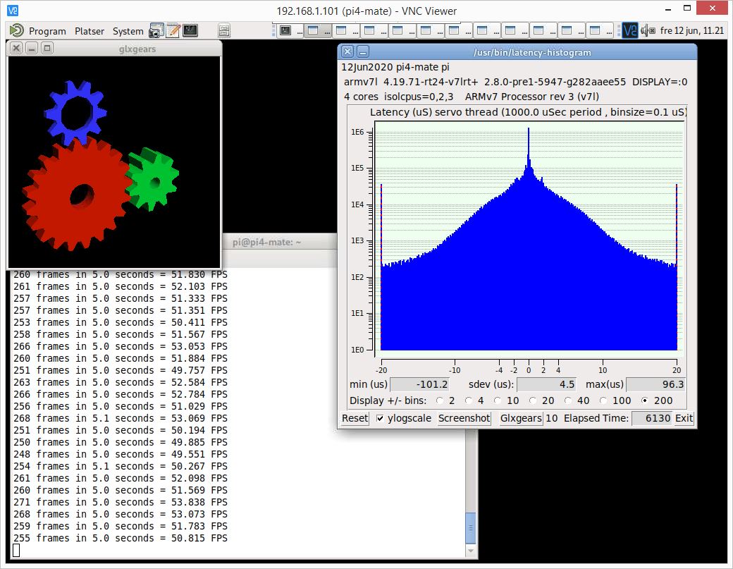

Is the Latency-Histogram disk intensive as I am running on a µSD card?

12 Jun 2020 04:25 - 12 Jun 2020 04:26 #171228
by tecno
Last edit: 12 Jun 2020 04:26 by tecno.
