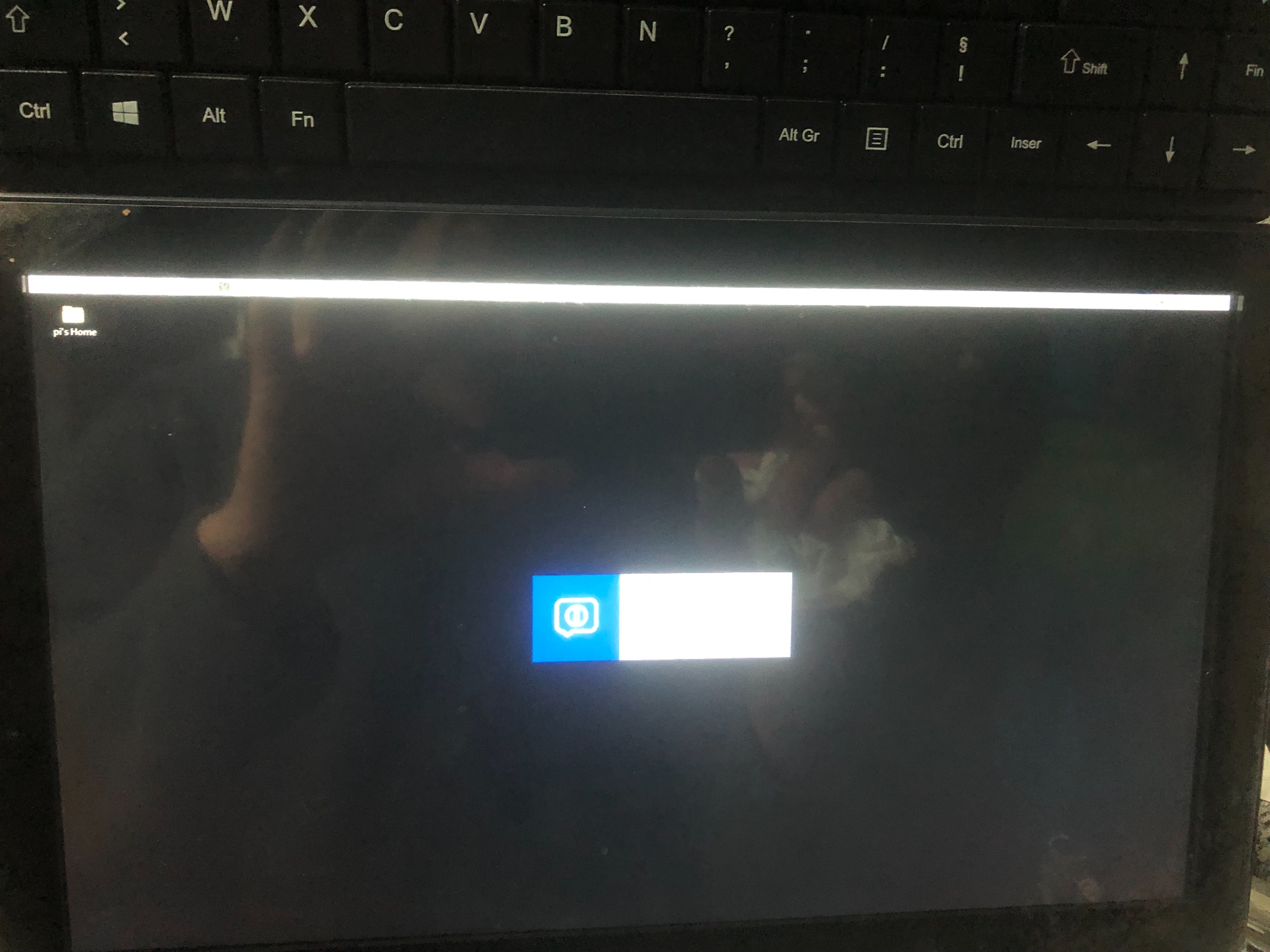

Good morning from Sweden,
Sorry to report that it is still not working. Tried two µSD cards one fast one slower.
Now I can see that the text is Login etc.. so it hangs on going over to graphical.
Cheers
Bengt

10 Jun 2020 02:41 #170920
by phillc54
Replied by phillc54 on topic Raspberry Pi 4 with PlasmaC
Hmm, I would have assumed a Pi4 was a Pi4 and they would all boot from the same image. Maybe you could try editing /boot/config.txt and commenting out the two hdmi lines.
I have just mounted mine to a din rail clip and mounted it in my control panel.
I also edit out force-turbo in cinfig.txt and set isolcpus=2,3 in dmdline.txt. That doesn't increase latency too much but makes the graphics a little bit zippier.

Sorry, still the same.
What does all these parameters and why is there a file *config.txtdtoverlay=pi3-disable-bt*
[pi4]
# Enable DRM VC4 V3D driver on top of the dispmanx display stack
dtoverlay=vc4-fkms-v3d
max_framebuffers=2
kernel=kernel7l-rt.img
# force_turbo=1
dtoverlay=disable-bt
[all]
[pi4]
max_framebuffers=2
# force_turbo=1
[all]
Last edit: 10 Jun 2020 03:07 by tecno.
- phillc54
- Posts: 5711
- Thank you received: 2100
10 Jun 2020 03:14 #170925
by phillc54
these were there by default
this points to the RT kernel I built
this keeps it in turbo mode
this disables bluetooth
