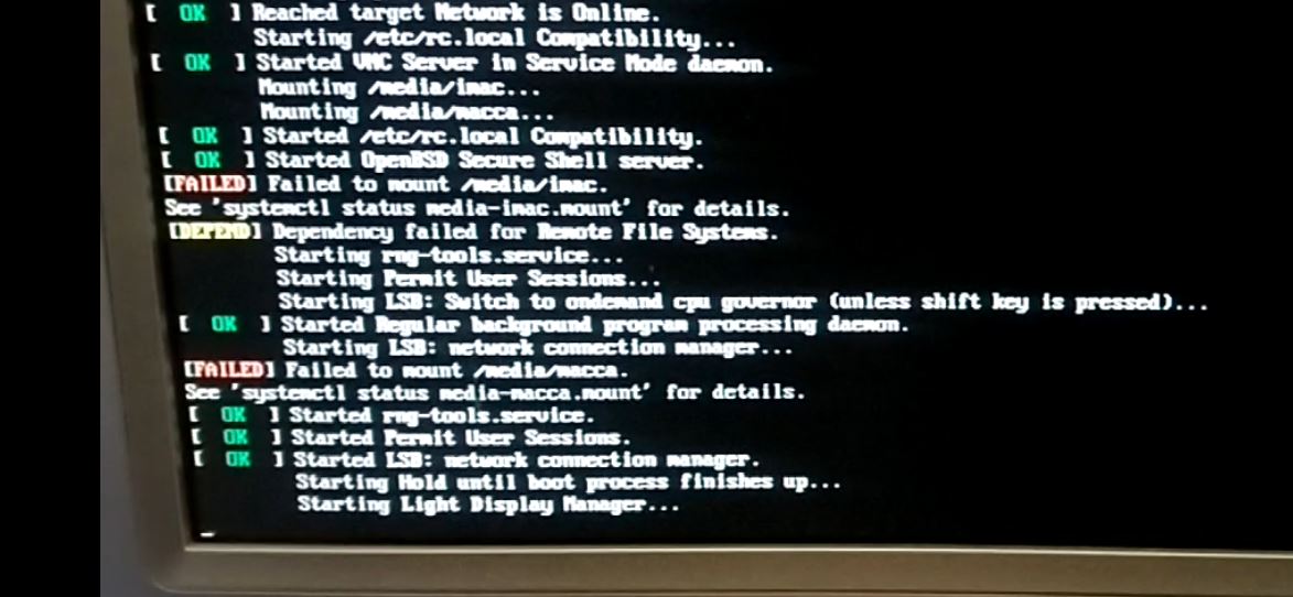

So now it gets a bit in to boot, after DHCP it scrolls so fast with text I cannot read and goes black - dark grey - black - dark grey and stops no cursor no nothing.

09 Jun 2020 06:23 #170814
by tecno
Replied by tecno on topic Raspberry Pi 4 with PlasmaC
- phillc54
- Posts: 5711
- Thank you received: 2100
09 Jun 2020 06:36 #170816
by phillc54
Replied by phillc54 on topic Raspberry Pi 4 with PlasmaC
Maybe it has something to do with that fact it cannot connect to the NFS shares. I will make one tomorrow that doesn't try to do that.

09 Jun 2020 06:56 #170818
by tecno
Yes it looks like its looking for something.
Works that far with root=/dev/mmcblk0p2
I really appreciate your help with this!
